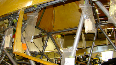

Here's a photo taken from the VWoC blogspot. It's taken looking up into the "fastback" portion. As you can see, it's an empty plywood shell.
It's difficult to photograph the portion below that, within the metal framework of the fuselage, where the passenger would sit. Here is part of it. It is crisscrossed swith bracing wires. This bracing function would have to be reproduced by alternate means if a pax seat was there, probably by gussets and "knees" (boatbuilding term).

Dave
Thanks for posting the pics , gives everyone a better idea of the proposal.
What are the thoughts on the passenger being able to see outside?
Skinning the doghouse with plexiglass or just installing a small window ?
