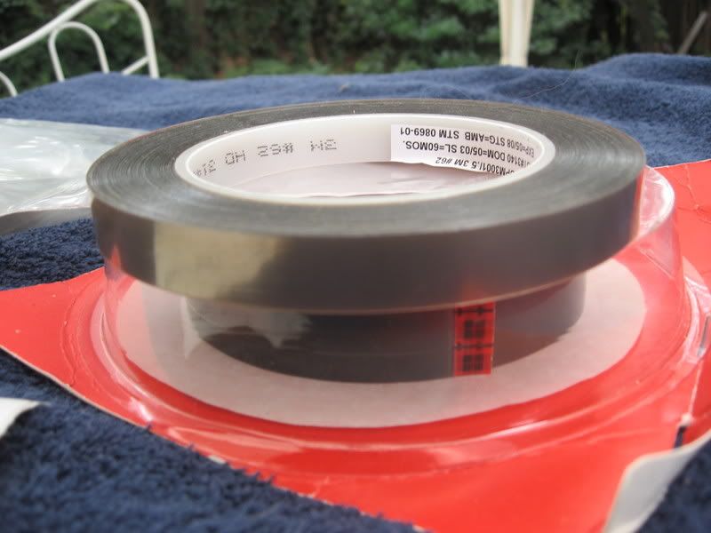

I have 3 rolls of a special heat resistant 3M Tape. It is packaged with a BOEING sticker on the reverse side. I'm guessing it is used for something important. Anyone know of anyone that can use it, or knows what it is for. My father said it had to do with aircraft engines. I have pics that I can send out. Its been puzzling me for awhile what it is for. They came out of a lot of stuff I got from an military depot in California. Thanks.
Rich
Warbirds-Rugby-Air Racing
PostPosted: Tue Jul 10, 2007 12:06 am
Does it have a part number or a MIL-SPEC number written on it anywhere? What color is it? Is it adhesive backed tape? How wide is it?

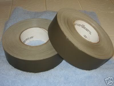

Is it green? 1" wide?

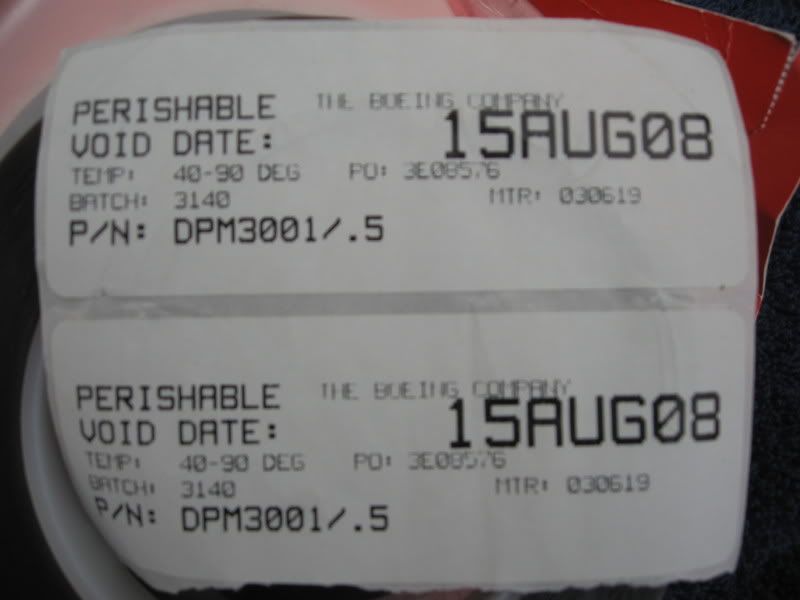

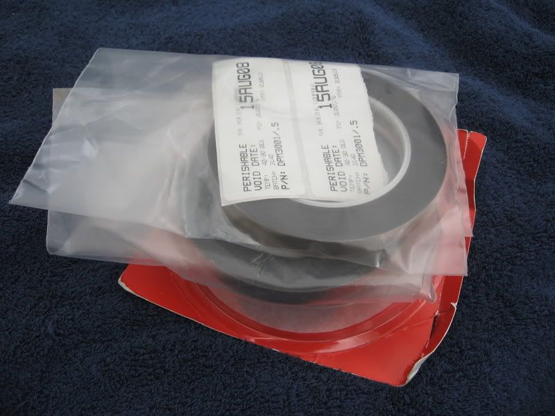

The two rolls that seem to be 1/2 inch have a tag with them that reads :
The boeing company
Perishable void date : 15AUG08
Temp: 40-90 DEG
PO: 3E08576
BATCH : 3140
MTR : 030619
P/N : DPM3001/.5

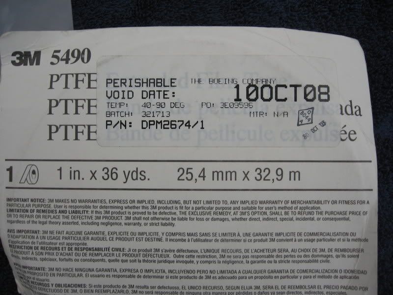

The second reads the same but with exp. date : 10OCT08
And it seems to be an inch wide. Also under the sticker on the 3M Box it reads Extended Film Tape. As for the green tape. The one they call "600 mph tape". I have had that before, but this seemed aviation related.
Thanks,
Rich
PostPosted: Tue Jul 10, 2007 7:01 pm
http://solutions.3m.com/wps/portal/3M/en_US/3M-SpecialtyTapes/SpcltyTape/ProdInfo/Spec6/PTFE5490
http://multimedia.mmm.com/mws/mediawebserver.dyn?6666660Zjcf6lVs6EVs6661blCOrrrrQ-
DPM = Douglas Process Material; Do you have any C-17s or KC-10s stationed nearby?

More...
This tape has been used by Douglas Aircraft since at least the early 1970s to wrap electrical bundles in areas subject to contact with hydraulic fluid.
