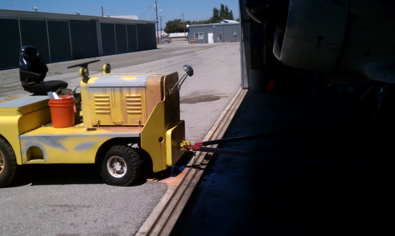

PostPosted: Thu May 10, 2012 4:20 pm
Joined: Thu Jun 30, 2005 8:19 am
Posts: 100
51fixer wrote:
We have a mirror on the tug that lets you look straight down and see the pintle. With the towbar hooked on each gear leg, Drive over the attach loop of the towbar sitting on the ground. Aim to have it inline with the pintle and directly above it while viewing in the mirror. Pop one of the ends out of the lug on the gear leg, hook up the pintle on the tug. Then reconnect to the gear leg and away you go. (make sure you didn't excessively angle the tug to get in the hook up position, pulling away and swinging the tail off to a side unexpectantly will get you attention :shock: ) Often the loop will only be sitting on the pintle lug and you may have to creep forward to get the loop to sit in the right spot to allow you to close the pintle latch.
I setup a mirror on our tug to do exactly that, hook up the pintle when no one else is around. (It got difficult to rely on the reflection in the spinner) I usually stick a wheel chock (perfect height) under the towbar and slowly drive forward until I push the wheel chock out of the way, and the towbar falls into place.
The mirror is dual purpose, and can also be swiveled to work as a rear-view mirror.
As you see from this pic... the tug didn't have it's best day, but at least it decided to barf after the airplane was all the way into the hangar.
