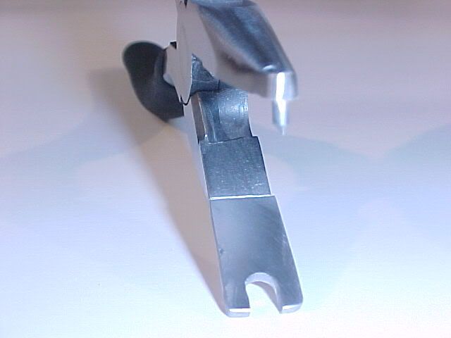

Propper method of removing rivets is to drill the head only, leaving the shanks to be removed by other means.
To knock the shanks out of thin material it needs to be backed up with a bucking bar or simaliar device and hit with a punch. I don't know about you but I have never seen this done by one man. The other alternative is to drill them out but that only makes the hole bigger. My tool supports the structure on two sides reducing the possibility of bending or cracking. I have sold many of these to sheetmetal techs and not one has returned and everyone that uses it loves it.
