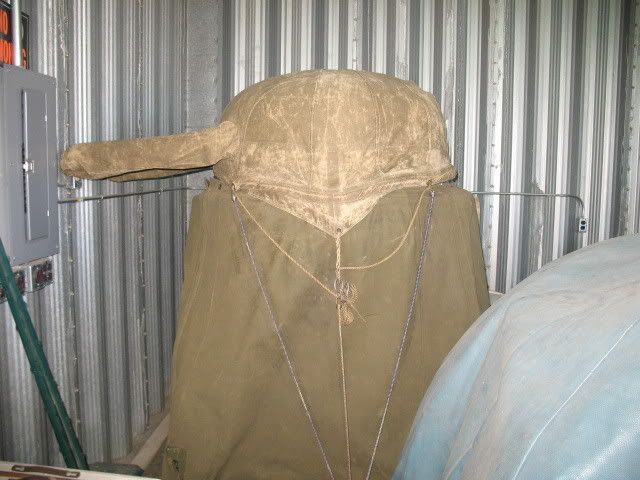

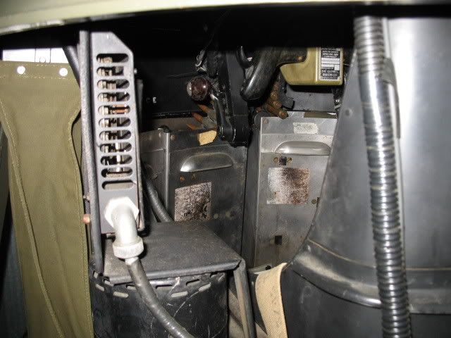

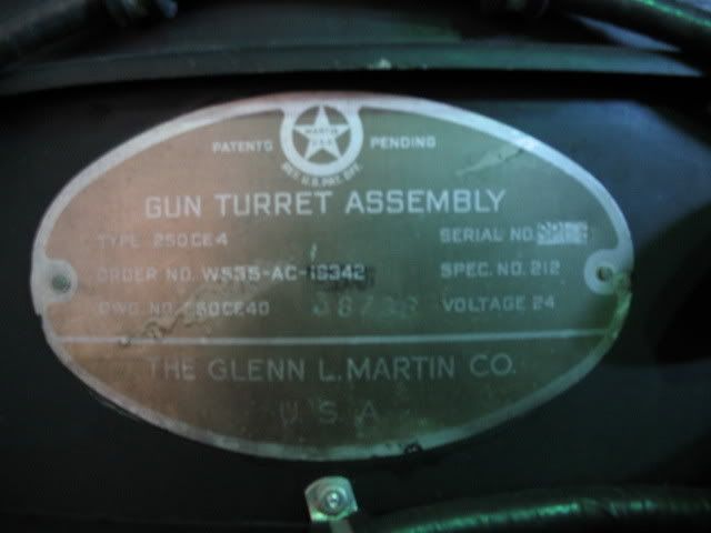

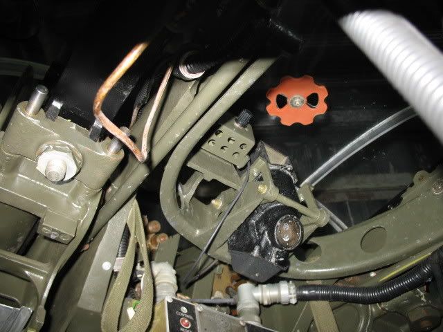

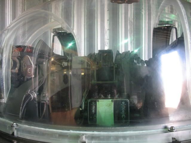

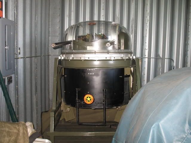

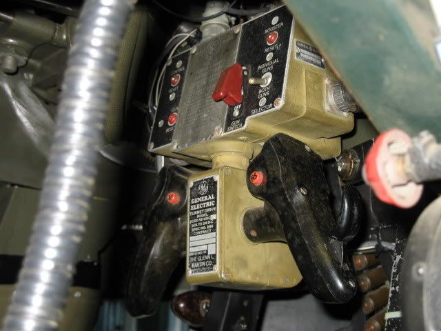

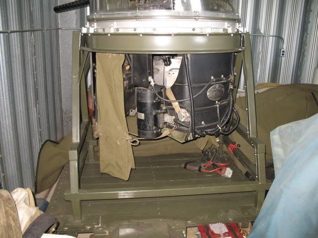

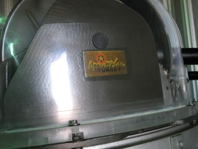

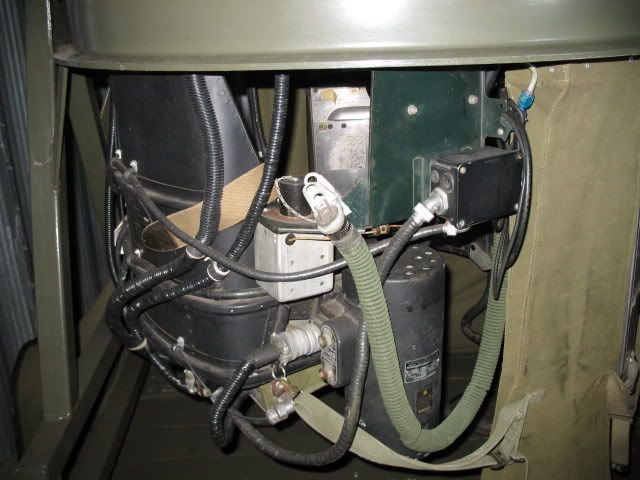

Here are some pics of our turret. This turret was found in a local swamp and was totally rebuilt by one of our squadron members. It is still operational, we have a set of batteries that we plug it into when we take it to airshows.

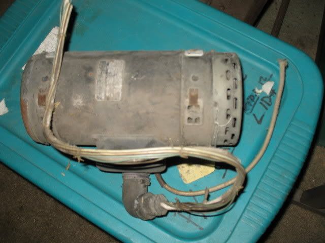

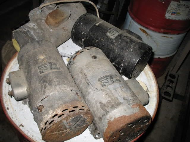

Plus we do have these 5 Motor -Genereators laying around in the hanger. For the right size donation they would be available to go to a good home.

The Martin 250 turret looks beautiful...just curious if you have any 28V motors for a ball turret? I've seen dozens of motors for the Martin upper turret over the years and have yet to find a single ball turret motor (that someone's willing to sell :cry: ).

These are the only motors that we have for turrets that we know of. Do the ball turrett ones look similar to these, just smaller or are they totally diferent?

The ball turret motor looks very similar to the black one shown in the pic. It's about the same size and is a simple cylinder shape with square attachment plates on each end for mounting the two hydraulic pumps. The pump on one end was for azimuth and the pump on the other end was for elevation. The motor was a 28V (actually 27.5V) and was made by a number of subcontractors such as "Emerson", "Diehl", and I believe even "Hobard". If you want...I can post a pic of it.
