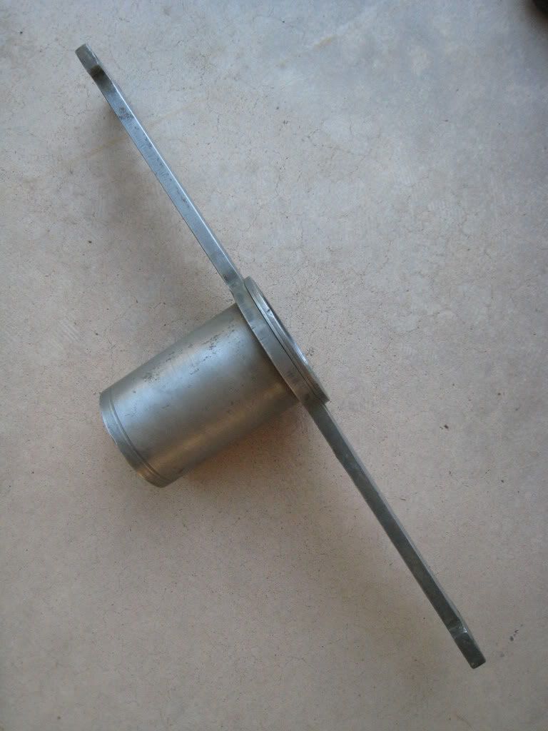

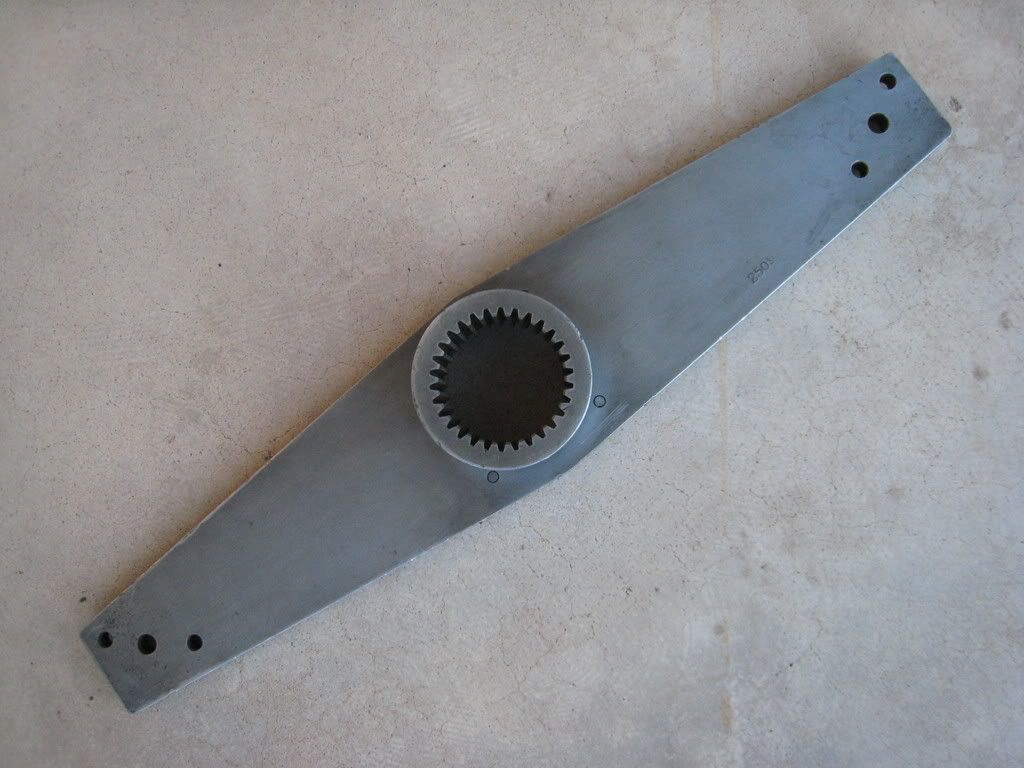

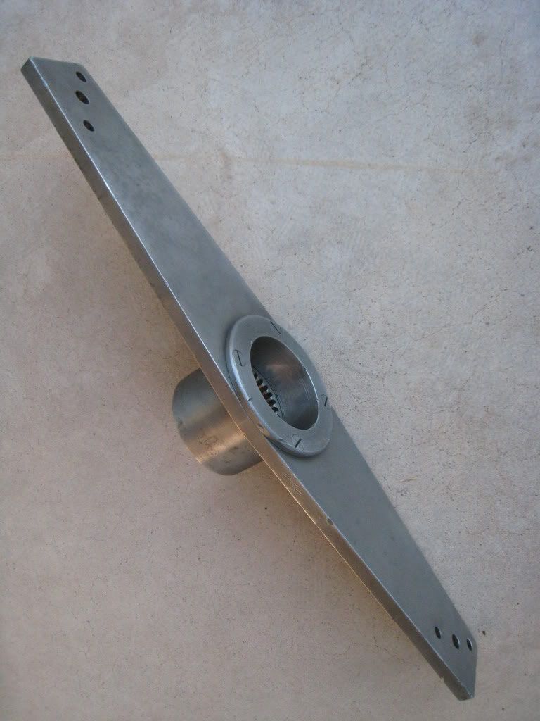

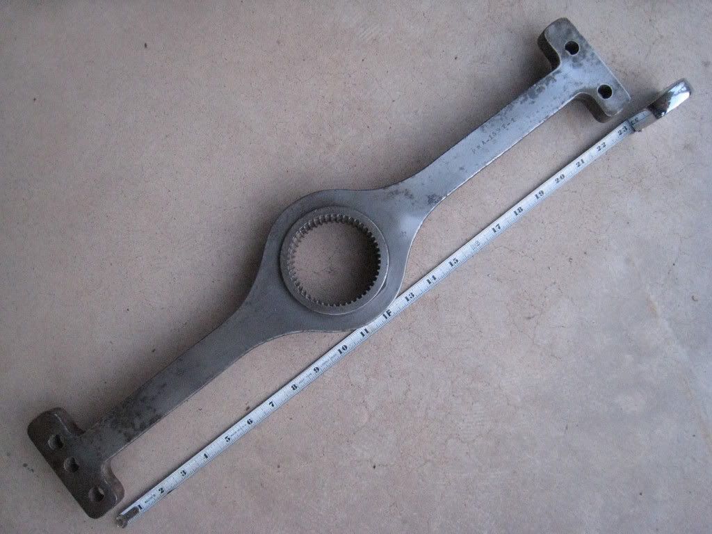

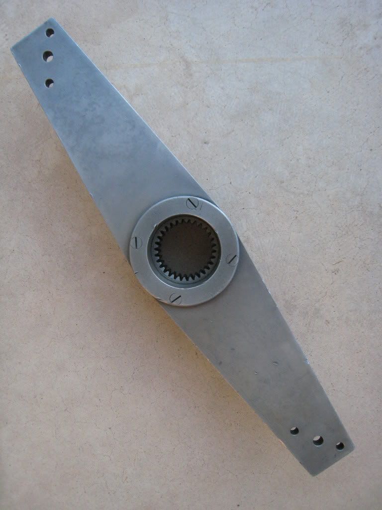

In going through some old auction items purchased at an auction in the past, I found some PWA tools. The tools are splined holding fixtures and have the following numbers:
PWA 2509
PWA 2609. This tool is similar to the PWA 2509, just a larger internal splined end.
What engine or engines were these used on?

I checked my 1830 manuals and ruled out these PNs applying to the 1830 tool list.

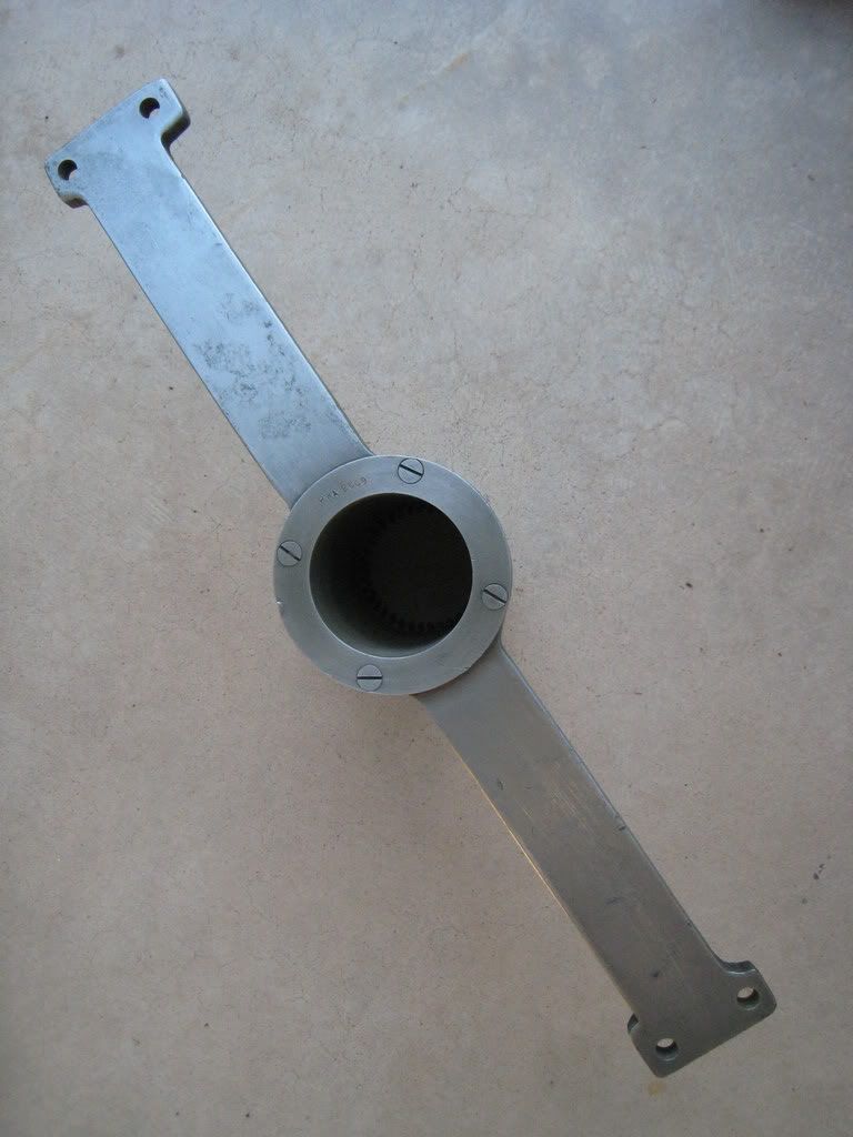

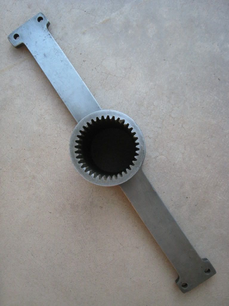

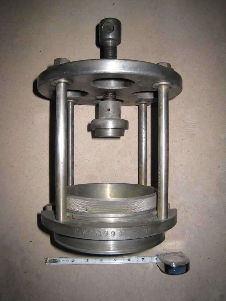

Here are a few more Pratt & Whitney tools that have an application that is yet to be identified.
PWA 1597 is similar to the previous holding fixtures.
PWA 1999 is a puller/pusher tool, but for what part on a radial or turbine engine?

I show PW1999 is a Reduction Drive Gear Puller for the 1830 with 16:9 Rigid Reduction Gearing. I beleive that would be the following dash numbers -45,-47,-49,-51,-53,-82,-90 (some).
