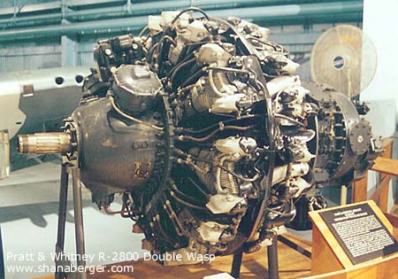

This is my guess, based on limited knowledge with some further research:
Looks like a 50 spline R-2800 nosecase, so I would guess a 24E50. The 60 spline late-war "C-Series" engine (and post-war civil variants) has a nosecase less domed with an additional cylindrical section and was used in the 4-bladed Corsairs (to the best of my knowledge).
So, it could be off of a lot of planes, but I suspect not a Cosair- maybe a P-47D or G (the "N" had a C-Series engine as well)?
50 spline:
60 spline (C-series):

Could just be a matter of semantics. The E-Series blades should fit in any E-Series hub, so you may have Corsair blades in a 50-spline hub.

I took some photos at NEAM this past week of the two major types of R-2800 variants to satisfy the other Anoraks out there...
F4U-4 "C-Series" 60-spline engine
F6F 50-spline engine (same as/similar to F4U-1/FG-1D)
P-47D 50-spline engine
