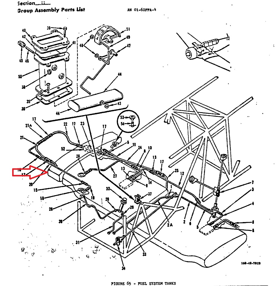

PostPosted: Mon Sep 22, 2025 11:25 pm
Posts: 2683
The T-6G had small bladder tanks outboard of the main aluminum center section fuel tanks. All crashes do not result in a fire.
