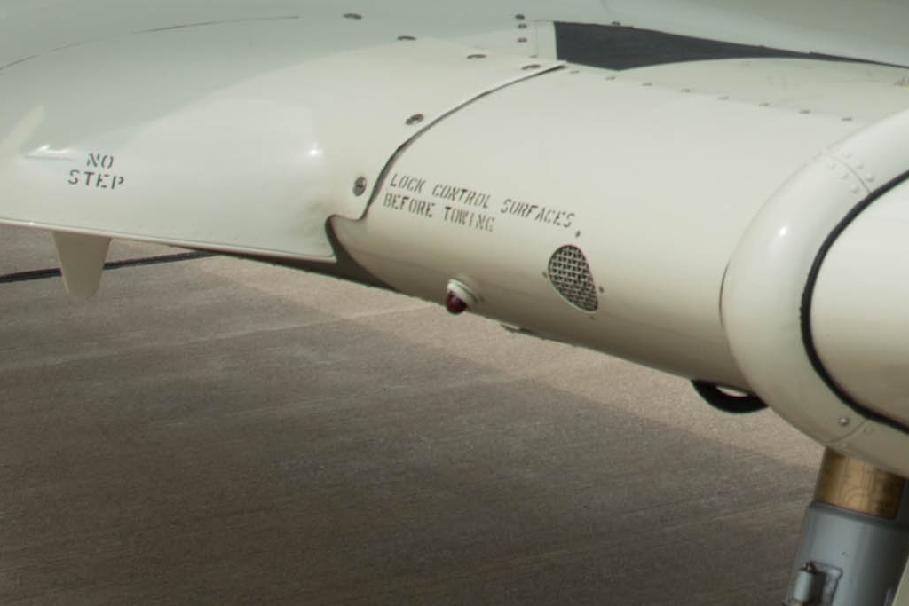

I just so happened to find a good picture of 42-84757 showing one of the lights today:
(Source: Warbird Training Center)

Here's mine! One on each side.
T-6 Light.jpg (18.68 KiB) Viewed 9308 times
