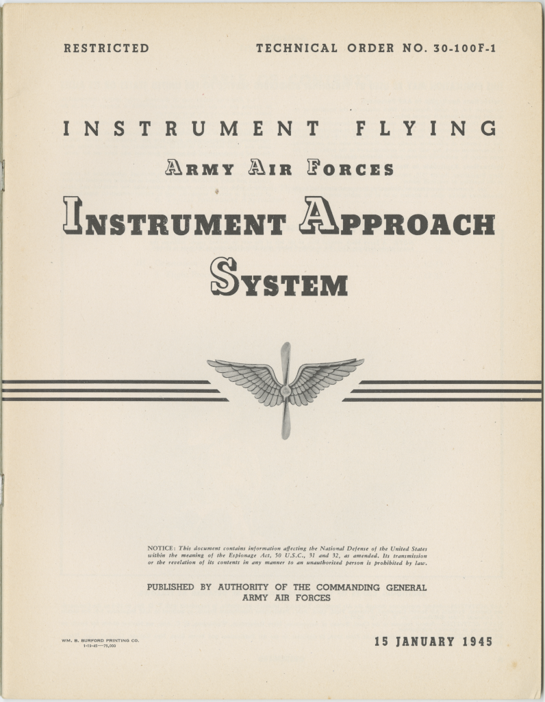

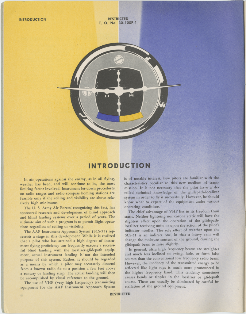

You're in luck. I just so happened to scan a manual at the museum the other day that has illustrations of an instrument that looks just like it:

(Source: Instrument Flying: Army Air Forces Instrument Approach System, T.O. 30-100F-1, 15 January 1945, title, ii, 3, 4, 12.)
The complete version is available via the Tri-State Warbird Museum's Internet Archive collection.
