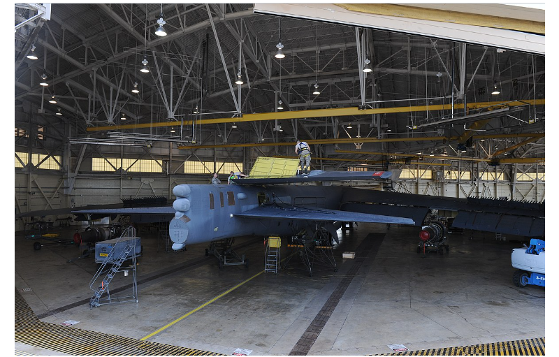

B-52s and KC-135s have that feature. Boeing must have liked it.
At my time at a couple of B-52 bases, I only saw folded fins a couple of times.
A USAF article on the B-52 feature:
https://www.barksdale.af.mil/News/Featu ... x-and-fly/
I
And one on a KC-135:
https://www.afcent.af.mil/News/Photos/i ... 000876165/
And from Google a copyright-free USAF photo for your piece.
