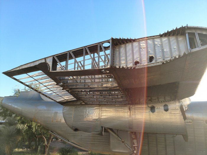

I know hindsight has revealed that stainless steel is not the best material to build airplanes out of, but they do have one advantage I find fascinating. Even after years sitting outside, aside from mechanical damage, they look pristine with zero corrosion. I first discovered this when I saw the Budd RB Conestoga at the Pima Air and Space Museum in November 2018:
