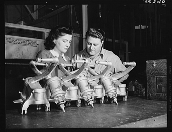

The size of the assembly was pretty big, This photo will show it.
