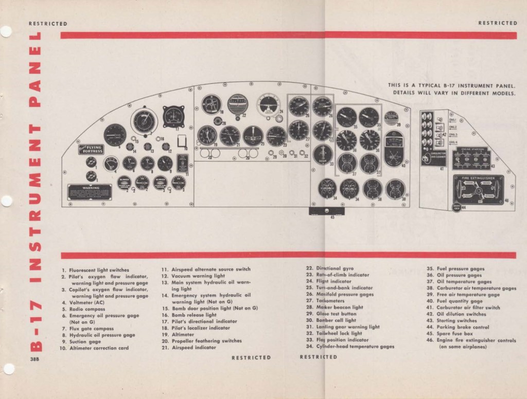

The RC-103 instrument approach equipment along with marker beacons and glideslope receivers were in use late in WWII. It can be seen in the B-17 photos showing the antennas for localizer and glideslope on top of the nose. It can also be seen on the instrument panels and is referenced in the Pilots Information file.

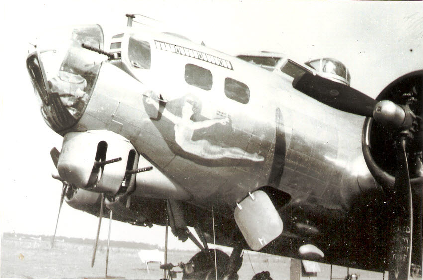

The antenna for localizer and glideslope in front of the astrodome

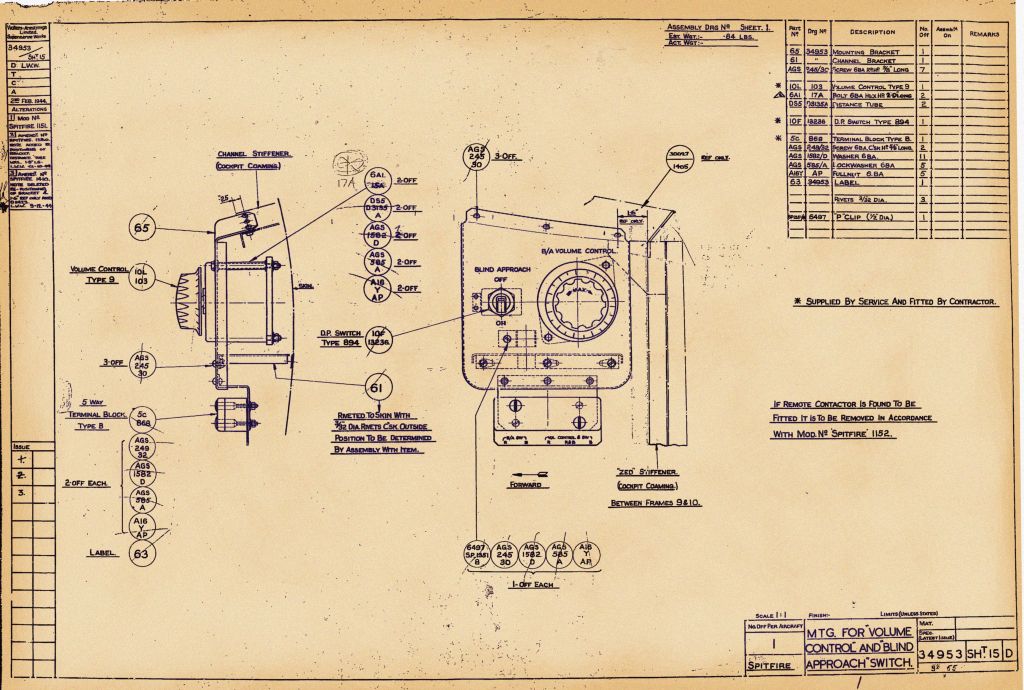

PostPosted: Mon Jun 14, 2021 4:18 am
Posts: 334
Feb 1944 for MkV Spitfires.Looks like backdated.
