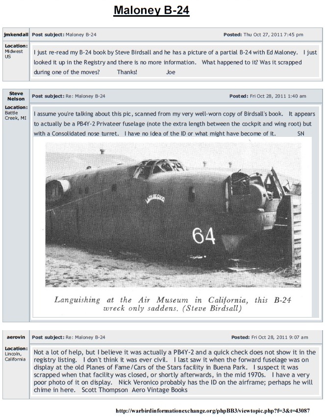

According to a WIX posting (Topic 43087) back on October 28, 2011 by Dik Sheperd, the PB4Y-2 that was formerly at The Air Museum in Ontario was BuNo 59838.
The following are from my files:
1 - PB4Y-2 BuNo 59838 - Warbird Registry entry - modified.jpg [ 233.53 KiB | Viewed 2424 times ]
2 - PB4Y-2 BuNo 59838 - WIX Maloney B-24 10-27-2011 a.jpg [ 220.56 KiB | Viewed 2424 times ]
3 - PB4Y-2 BuNo 59838 - WIX Maloney B-24 10-27-2011 b.jpg [ 134.87 KiB | Viewed 2424 times ]

To everyone who’s put forth that this hulk is 59838, thank you for the information.
I have also been in touch with Dik Shepherd off the forum.
Mike Furline, thanks for the color shot.
That said, I need a deeper dive on identifying this hulk, and please take a moment to examine the information I’m presenting:
I have attached a photo of the hulk being transported from China Lake to The Air Museum/Planes of Fame. The photo was given to Milo Peltzer by Ed Maloney.
As stated in the original post, 59350 to 59433 were delivered with the Motor Products nose turret. To those that have said, “A new turret was dropped into the nose section…” allow me to draw your attention to the fairing directly behind the nose turret. The hulk has the fairing for the Motor Products turret, not the Erco bow turret, making its serial number equal to, or lower than, 59433.
For a comparison, see Page 23 (Motor Products turret) and Page 26 (Erco turret) of the Ginter Naval Fighters series book # 93 “Convair PB4Y-2/P4Y-2 Privateer.” In addition to the fairing behind the turret, the area below the turret incorporating the bombardier’s windows is substantially different for aircraft 59350 to 59433 versus 59434 to 66324.
My apologies to Dik, but based upon the aircraft’s structural configuration, this hulk could not be 59838.
According to the record card, 59838 ended its days at Litchfield Park and was stricken from the inventory on 1Oct1956 (total time airframe: 3,541 hours).
Litchfield Park was closed and the base's aircraft inventory was either scrapped on site, flown out or moved to Davis-Monthan (MASDC) by September 1964 (see "Military Aircraft Boneyards," page 106).
Note that the distance from China Lake to Ontario is about 130 miles versus 350+ from Litchfield Park, Arizona, to Ontario, Calif., so I don’t see Ed Maloney spending his valued resources on transporting such a hulk (whatever its identity) from Arizona.
Yes, this is PB4Y-2 Privateer minutiae, but I'd like to know...
Appreciate your input and many thanks.
Nick
