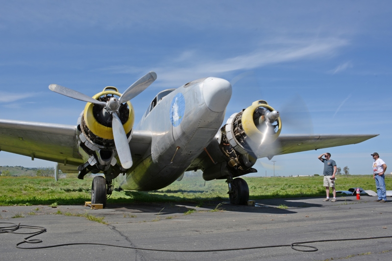

We bought a Harpoon that has been sitting for a long time in California. Last flown in 1995. Engines have not run in 15 plus years. Sound familiar? Yes we are gluttons for punishment.
We started to bring her back to life and have visited a few times to knock the nests out and begin to prep the airframe and engines.

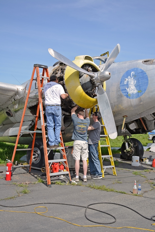

Jerry Anderson is a local and has been more than helpful. Jerry has been our Beech photo and air show pilot for many years. We love Jerry. He and Jim Adams pulled the cowling and spark plugs so we could lube the cylinder walls before we ever pushed on a prop blade. We wanted to lube the cylinders and pre oil the engine before we moved the props even a little bit. I am sure they have been moved many times in the past by every passerby but at least they will be wet and lubed when we try it for the first time.

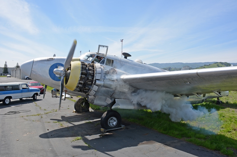

Last Saturday Steve, Sydney, Robin and Matt came over to help out. We serviced and tested the plugs, sprayed down the cylinders and pre oiled the engines. to our delight they were free and felt good. After pulling them through by hand during pre oil we tested the starters and they worked perfectly. The plugs went back in and we were able to start the engines.
They did beautifully, save the right carb. Time will tell on that one. Here is youtube video Roger Cain shot of the first start of the left engine:

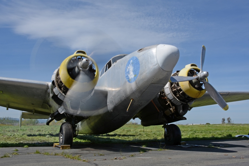

Yes this one is the more common variants with the conventional Harpoon nose. Our 062 is a PV-2D model that had the special 8 gun nose. They only made 35 out of the proposed 500 of the D models before production was stopped as the war ended.
This model, sometimes called a PV-2C or just PV-2, also had a radar antenna in the nose, two fixed 50's on the upper part of the nose (gun ports still present in this one) and a package of three 50's under the nose.
