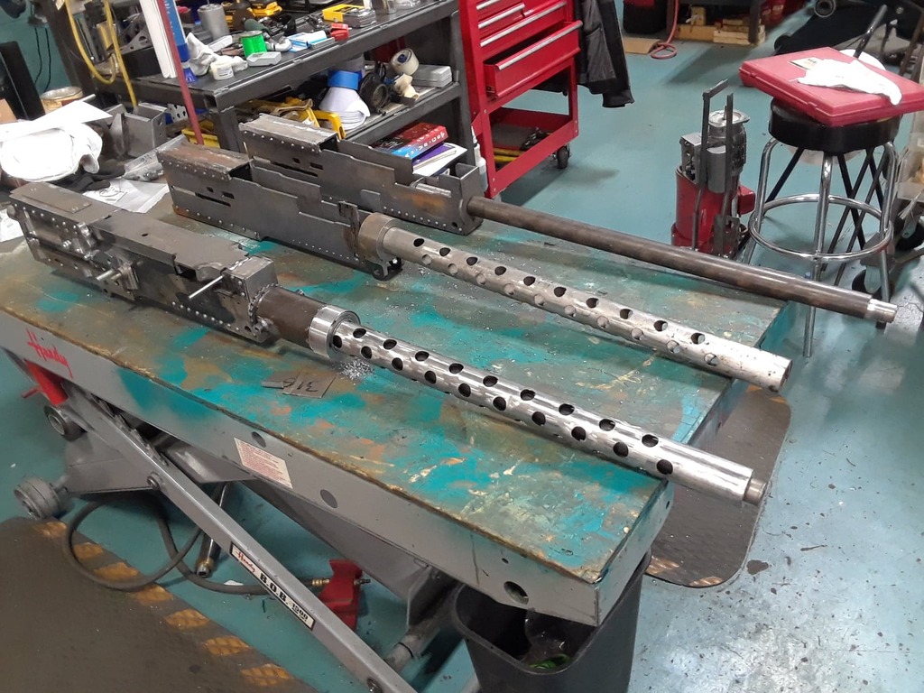

I have a set of drawings and have built a few replicas and am in the middle of another set for a warbird project. They aren't too terribly difficult to make, I have been toying with the idea of selling parts kits that includes all of the sheetmetal parts cut on a CNC plasma. How much fabrication equipment do you have access to? To build mine, I use a drill press, a welder a turret mill, Plasma cutter and a lathe. I wanted one that had all of the bells and whistles, so for that one I also used a CNC mill. If you just looking for wing guns, they're a bit difficult to see, so you can get away with omitting some details like the trigger group, opening feed cover and retracting slide group if you wanted.
