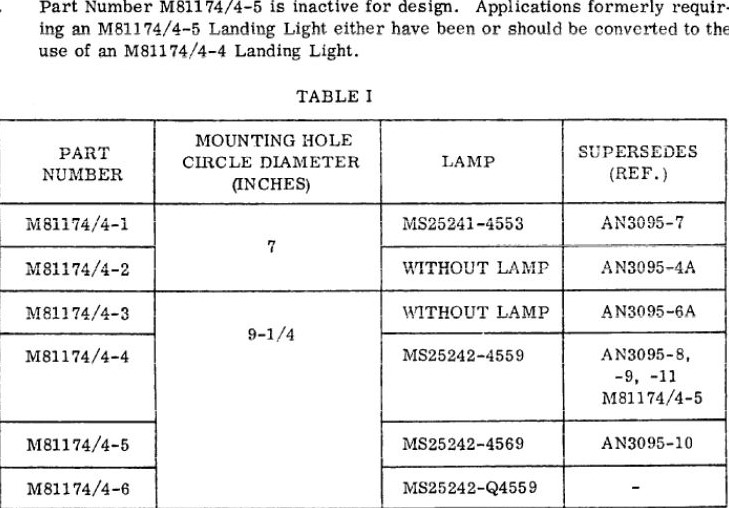

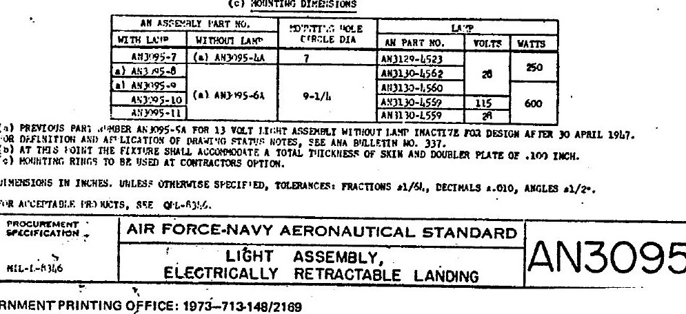

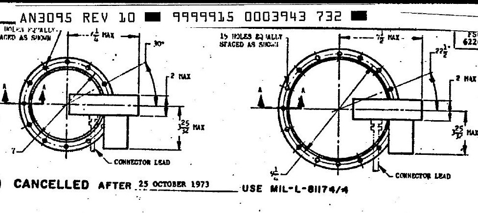

Use MIL-L-81174/4A
Does any of this help?

bdk, I had not seen those AN3095 drawings before. Pretty cool.
From some pics I have seen:
AN3095-1 is a Grimes G-3100 12V
AN3095-3 is a Grimes G-3001 28V
AN3095-7 is a Grimes D-3040E 28V
AN3095-9 is a Grimes G-3001A 28V
That's all I can offer.
