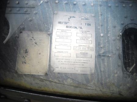

The plate is usually visible from the outside.
Look through the glass, roughly where the left hand pilot's feet would be.

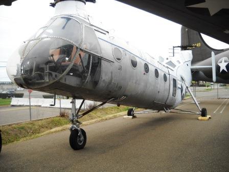

There are actually 2 data plates for the Piasecki H-21 Workhorse/Shawnee
1 from Piasecki
1 from accepted USAF
photo from H-21 at California Aerospace Museum looking through plexi

AlohaDave,
I can't quite read the details from the plate photo that you posted.
Assuming its 51-15886, can you please tell me the manufacturer's serial number and acceptance date?

Andy Marden wrote:AlohaDave,
Thanks,
Andy
Hi Andy,
Like you I am having trouble reading the tail number, however if it is 51-15886 the details are:-
Completed by 02/10/1954
Accepted on 08/31/1954
Delivered on 09/10/1954
This was under Contract # AF-12881
Project # ARD-4H-83

Sorry, forgot to add that the c/n is B-154
