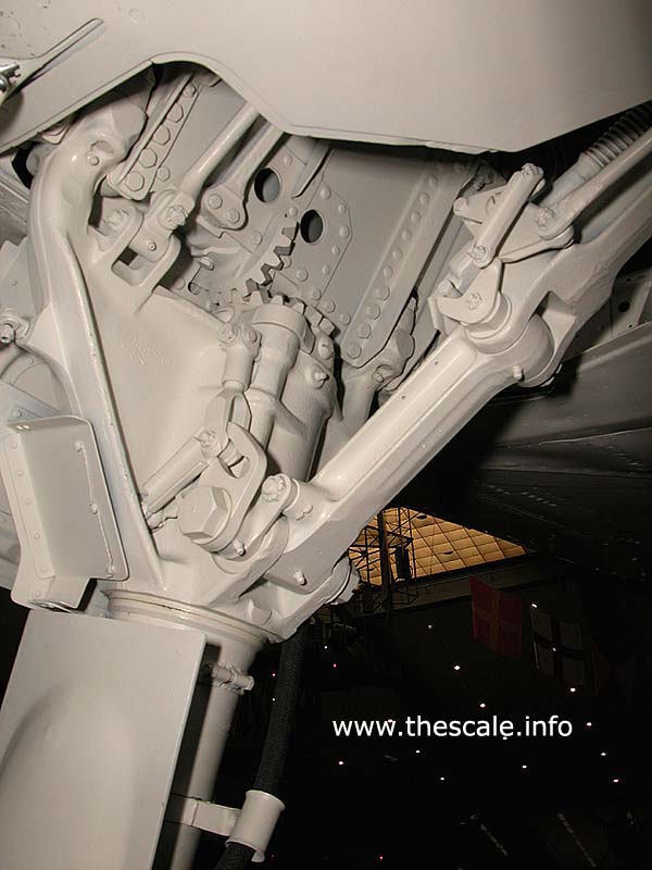

Hopefully I've attached a picture of the mechanism that caused the gear leg to rotate as it extended or retracted. This image came from this thread:
https://forum.largescaleplanes.com/inde ... t/page/11/
The mechanism itself seems pretty fool-proof, but then the above images seem to indicate it wasn't completely impervious to battle damage, or gremlins.....
