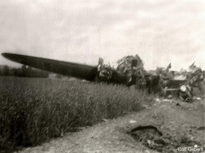

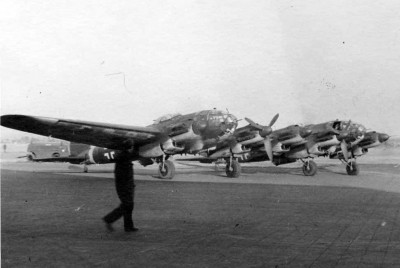

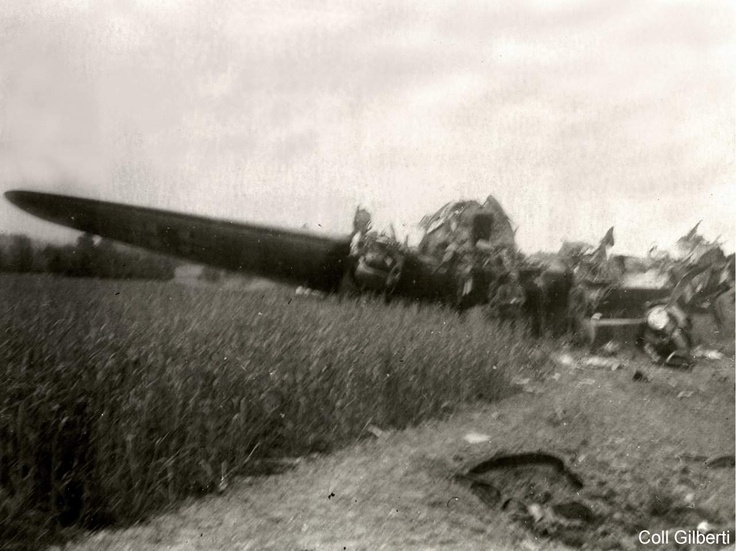

PostPosted: Sat Oct 27, 2018 7:13 pm
Posts: 609
The 111Z!
