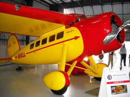

I heard a rumor that the Lockheed Vega 5C N13705 located at the now defunct Jimmy Doolittle Center located at the Nut Tree Airport, Vacaville CA was assembled with non-FAA approved glue. So the thing will never fly?
Questions: Is there such a thing as FAA approved glue?
How can the FAA issue certificate if it is non airworthy?
UPDATED The Vega was issued FAA Certificate 07/12/2016, Expiration Date 07/31/2019
The Vega has been looking for a buyer since its arrival. It is almost entirely made of wood and I estimate that less than 1% of the aircraft is original. The data plate is not original.
Any thoughts on the safety of flying a 1933 Lockheed Vega that was reconstructed using a few original parts?
