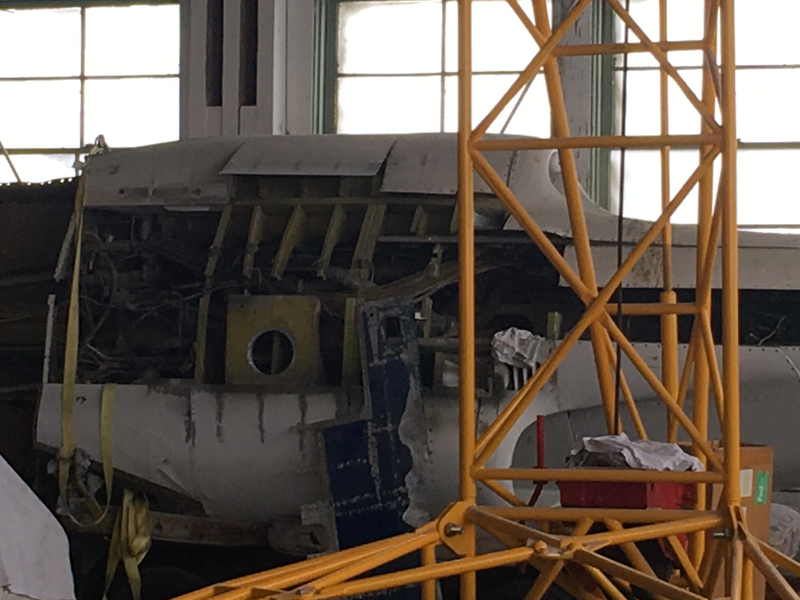

..... To build an 80 from a T-33 is not just removing a plug, but crating all new structure keels and longerons to hold that mighty thing together at many G's of force. The Acemaker display is very high energy, and if you realize the forces involved, an idea of a "simple" replica is nothing of the kind.....
Joe I lost you a bit in this above paragraph- while I agree that a P/F-80 conversion made from a T-33 would never have the same pedigree as a true F-80, and true rivet counters would always consider it a conversion, you seem to be saying that the T-33 that Acemaker uses is perfectly good for high energy displays, but a converted T-33 would not? I have heard elsewhere that the plug removal would be pretty straightforward- after all it was really the plug that turned the 80 into the 33....? Would be interested to hear why you think it needs major work with a new keel and longerons? Do major longerons/stringers run over multiple frames at that part of the fuselage- or are they frame to frame? I'm not sniping- just an honest question for my education. While it may be more than a plug removal, it looks doable. Thanks.
PostPosted: Wed Mar 15, 2017 9:32 am
Posts: 1699
sandiego89 wrote:
You can't just splice longerons and hope they'd be OK. I think I'm right in saying that on the T-33 the longerons run from the engine break right up to the front of the cockpit?
There's more to it than just taking out a plug and deleting the aft cockpit. Ultimately you'd have to ask why, when those with the bucks AND the F-80 airframe/s haven't taken the easier option.

Its more than a plug. Look at the structural repair manuals of both aircraft. While it is possible to splice a keel or a longeron, the simple "lego" "Tm" idea of removing a "plug" is not an accurate description of the structural modification to follow. A rebuilt spliced fuselage, spliced in every longeron ahead and behind the wing would be scary stuff for a pilot to contemplate. Jets apply huge forces to an airframe. Its not empty space, its all full of stuff, and so must be amazingly strong to carry flight loads...this is what it looks like when the keel is taken out!

Changing the structure is not a simple process.
