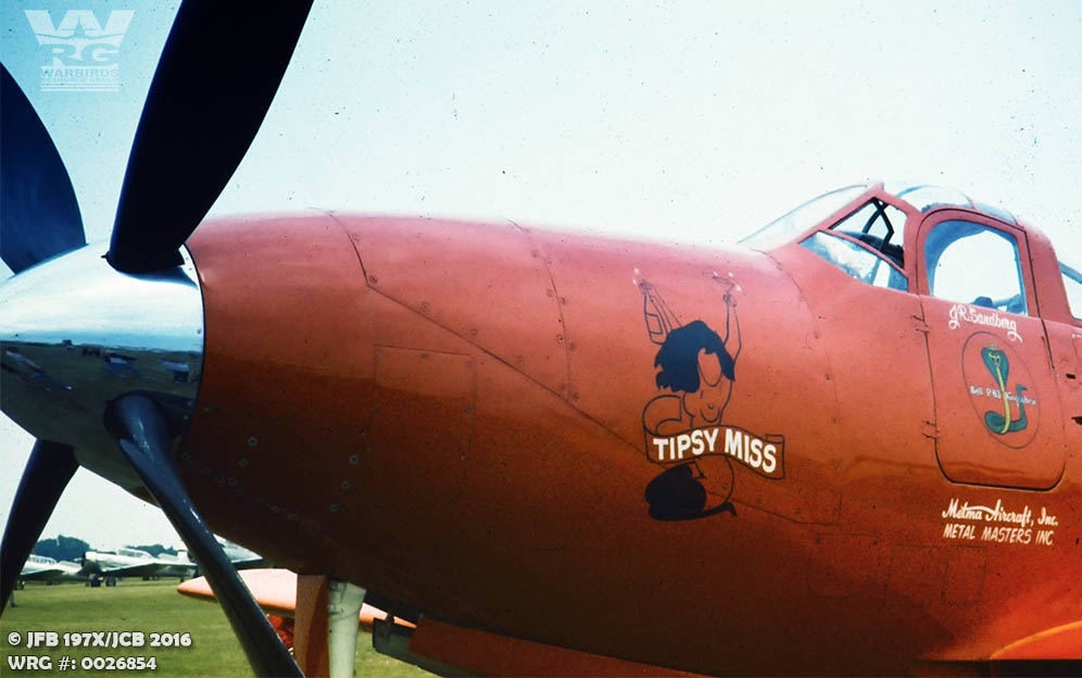

If either of the CAF machines goes pinball, I'm having a big decal made (to be applied when no one is looking, of course).
http://www.warbirdregistry.org/p39-p63r ... 026854.jpg
Yeah baby...the 70s...
