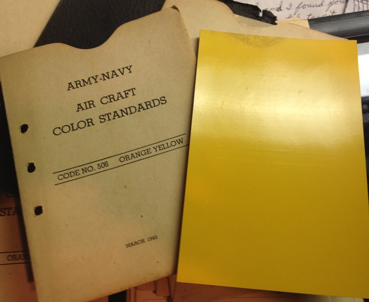

I have an original 506 called Orange Yellow card that I could possibly loan out if it was returned as good as it was when it left. Some restrictions may apply!
Sorry no 633.

You are correct that the two colors are not the same - they're not even related.
ANA 603 is commonly called "chrome yellow" after the similar artists' pigment, but as you can see from Taigh's post, the official name is Orange Yellow. (There is no chrome yellow pigment in the formula for ANA 603.) FS 595a color 13538 is actuallly a very good match.
ANA 633 is one of the two fluorescent colors standardized by the military in the late 1950s. The other - ANA 634 Fluorescent Yellow Orange - was, well, yellower, and was rarely used. The organic nature of these two paints meant that they rarely lasted more than six months before they had to be reapplied. Since 633 looked like 634 as it began fading, it made more sense to start with 633 and make the paint job last as long as possible. I can't get to my 595 books at the moment, but there is a good equivilent for 633 there, and I'll dig it out for you later.
