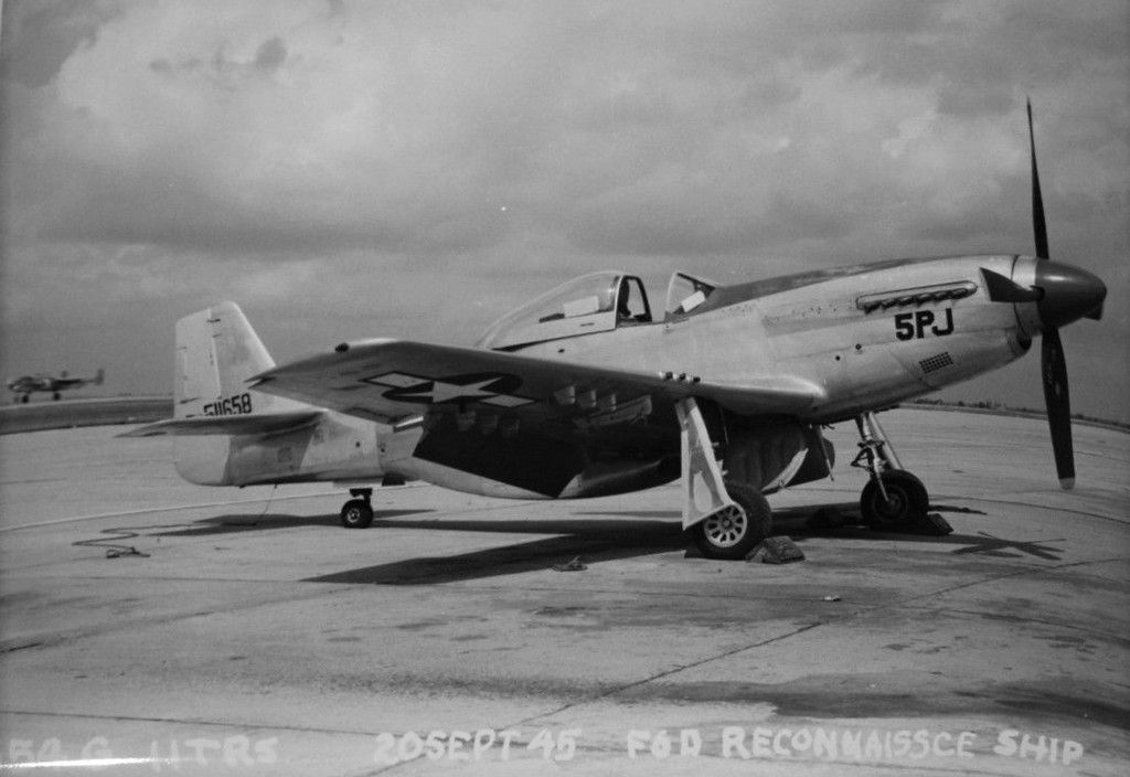

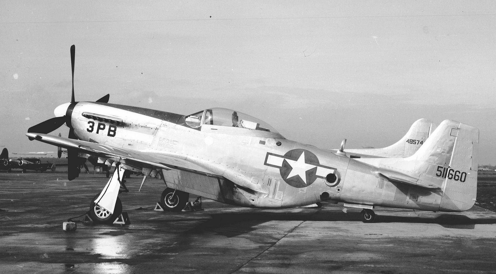

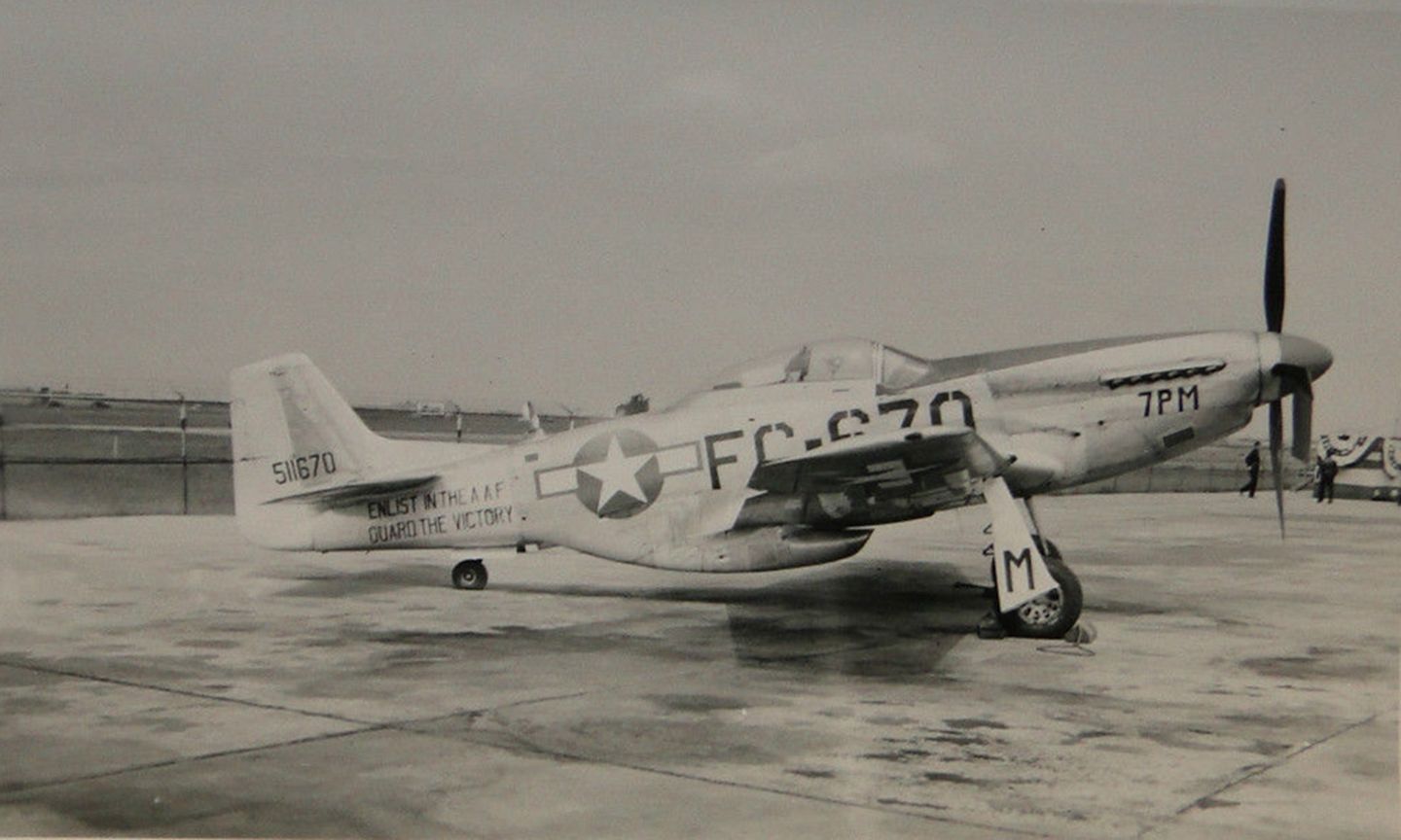

Has anyone done the research to reliably figure out post-war USAAF/USAF unit markings?
Like this one:
Is there any rhyme or reason to the 7 P M? I know this one has been identified as being from the 69th RG but so has this one
The buzz numbers are well known and I'm pretty sure the same unit wouldn't have differing unit codes, but....
I do have a pretty good grip on ETO Occupation markings. Just these ones seem to have a definite lack of documentation.

What do the IARC's say? My guess would be 'stateside displays and the markings remind me of Chanute/Sheppard etc instructional airframes.
But I'd like to know what's on each IARC because that should i.d. both.

Hi Junkman9096
These are F-6s at Stuttgart AAFld, Ark. late in 1945 they are from the 74th Reconnaissance Group.
The mission of the 74th RG was a demonstration “air force” for maneuvers with the various army ground forces schools.
The alphanumeric code is for the II Tactical Air Division, III Tactical Air Command, Third Air Force. The order of the code tells you the command or division the field is assigned to in the Third Air Force. In this case the number is for the squadron, the letter P is for the field and letter the ship in the squadron.
When Stuttgart was closed down in November 1945 the 74th RG was inactivated, the personal and equipment were assigned to the 69th Reconnaissance Group and move to Brooks Field, TX taking the old coding with them but with the new AAF wide buzz numbers of Oct. 1945. On 29 Jul 1946 the 69th RG was inactivated and personal and equipment were assigned to the re-activated 363rd Reconnaissance Group at Brooks Field the same day.

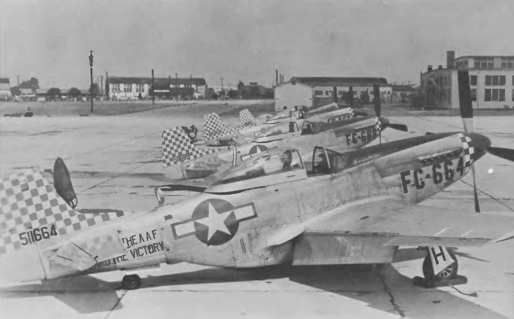

Here a F-6 of 363rd RG at Brooks Field note it still has the H for How a/c letter code:
Confusing for sure but I hope that’s a help.
Tom

res6kgcr wrote:
Hi Junkman9096
Tom
Is it just me or does that picture look like it has been digitally touched up, and very poorly for that matter. Lots of random gray pixels and that "H" looks digitally added to me. so does the "F" on the nose and the "join the AAF" titles..and the checkers on the nose...very odd.
Sean

martin_sam_2000 wrote:
res6kgcr wrote:
Hi Junkman9096
Tom
Sean
Not just you, some real odd stuff going on in that picture. Like what is going on in front of the verticals of the closest two aircraft?
The empennage of the closest Mustang doesn't even look like it belongs there.
I agree the pic definitely looks to have been doctored.
CraigQ

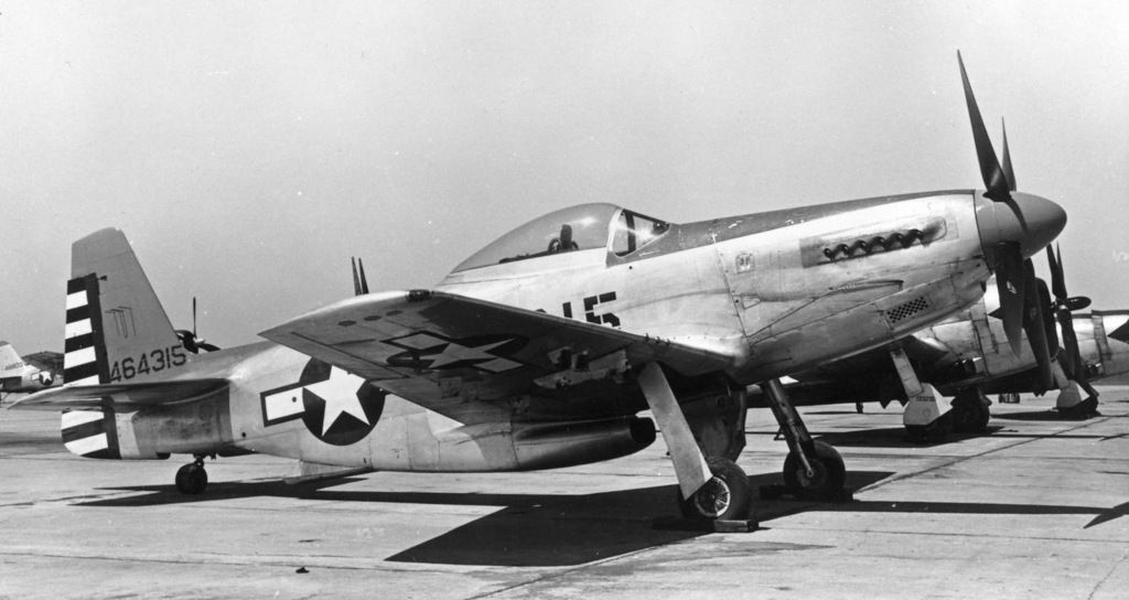

I found another photo of 45-11664.
Richard

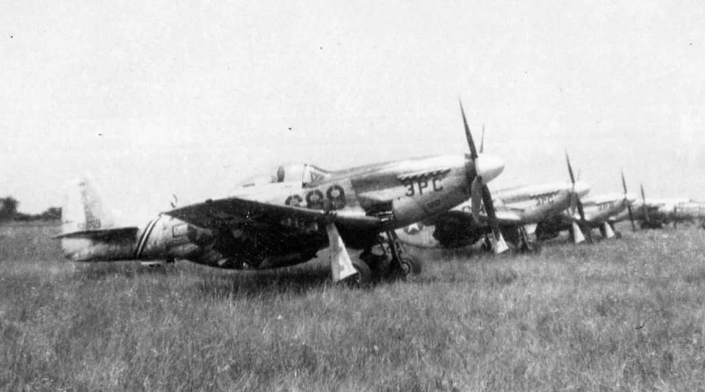

Here are some more post war F-6s for you all:
689 C for Charlie somewhere, probably of the 69th RG. Note the lack of wheel door letters.
658 J for Jig assigned to 11 TRS/74th RG at Stuttgart. It will be attach to the 69th RG when it moves to Brooks Field but is inactivated in March 1946 when Tactical Air Command is activated.

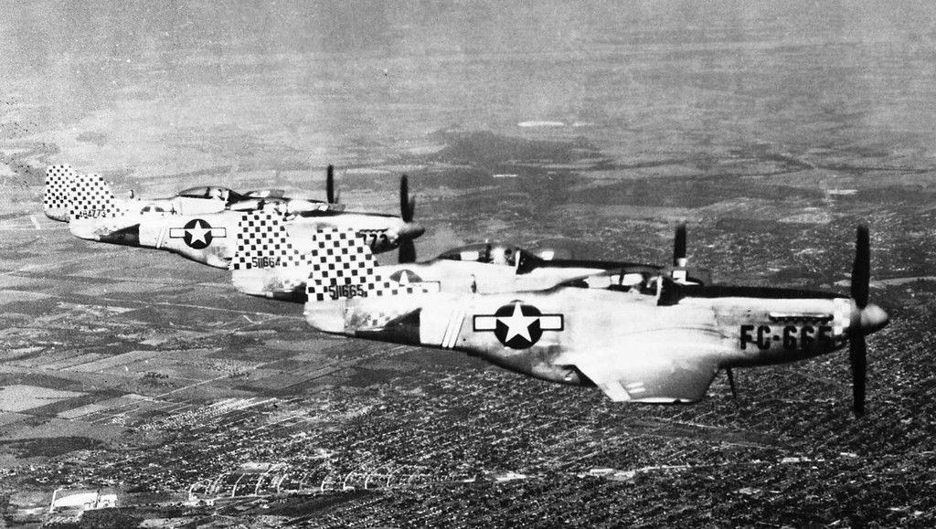

A great in flight shot of a flight of F-6s with the signature checker board tail of the 363rd RG.
res6kgcr wrote:
Hi Junkman9096
Tom
Sean
I think it's an image that's been turned into an Adobe .pdf: this format tries to recognize text and render it. So probably not doctored, but rather 'processed'.
PostPosted: Wed Feb 03, 2016 1:44 pm
Joined: Sun Jul 29, 2012 6:14 pm
Posts: 373
Location: Waukesha, WI
Tom[/quote]
Sean[/quote]
I agree the pic definitely looks to have been doctored.[/quote][/quote]
The same photo (un-doctored/corrected) is on Wikipedia about Shaw Field 1946. The photo is much clearer, the items in front of the verticals are ramp equipment.
https://en.wikipedia.org/wiki/Shaw_Air_ ... eld_SC.jpg

My photo of 664 was bought from AAHS some time ago. A lot of the jpgs on the CD are like this one in quality, it may have something to do with their scanner.
The Wikipedia photo caption for 644 is anachronistic for the 363rd TRW to be at Shaw AFB with the “ENLIST IN THE AAF NOW…” demobilization recruiting slogan, few did.

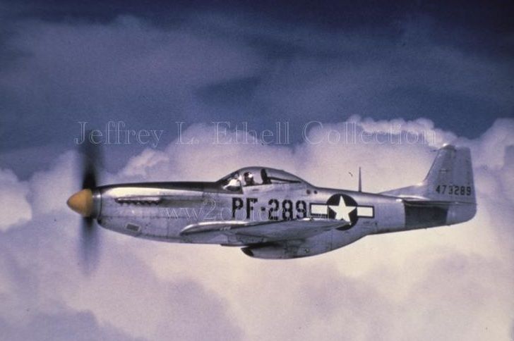

A “Plane Jane”, pun intended, P-51D with just a yellow spinner.

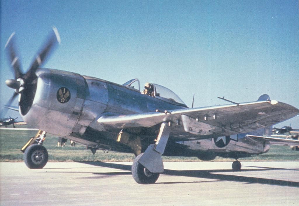

A P-47N of Air Defense Command, HQ First Air Force was a number air force that the National Guard and Reserves units reported to.
