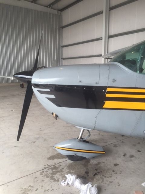

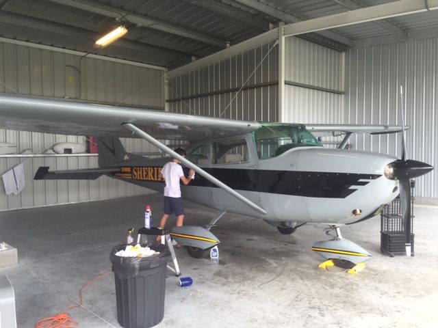

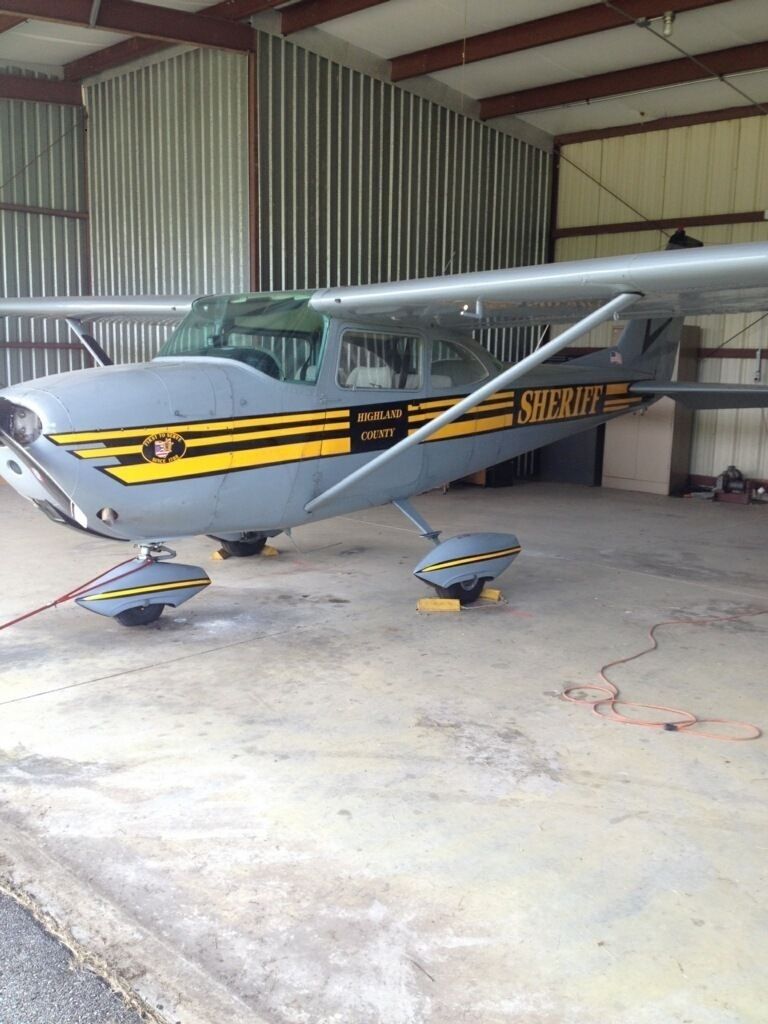

I bought a T-41A recently, and I am getting it ready for Air Force colors.
I am stripping the reflective vinyl letters off that were part of the Sheriff dept. paint scheme. Here is the first section I removed with WD40 and a credit card. That took about 1.5 hours.
I am hoping for something like this at the end:
To get the airplane into the "airshow invite" world ASAP. I plan to remove the vinyl, paint over the black with matching grey, and then shoot the top of the fuselage and nose black like the above pictures. I will then put on the appropriate stars and bars and USAF and N number in the right spots, and look for formation partners that can fly as slow as me. I will keep you posted.

I agree that Steve's bird is unbelievable and a goal to shoot for, but I know my limits! I have chatted a bit with Steve on this and also on the Cessna forum. Anything take off adhesive better than WD40?
PostPosted: Thu Dec 03, 2015 8:03 am
Posts: 1185
Location: Chandler, AZ
3M makes a dedicated adhesive remover that is the cat's meow. Straight naptha is almost as good, but much much cheaper.
