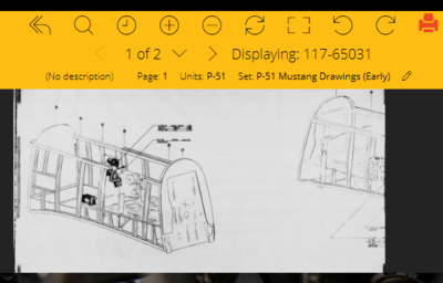

A sample:
Drawing 117-65031 for the P-51
