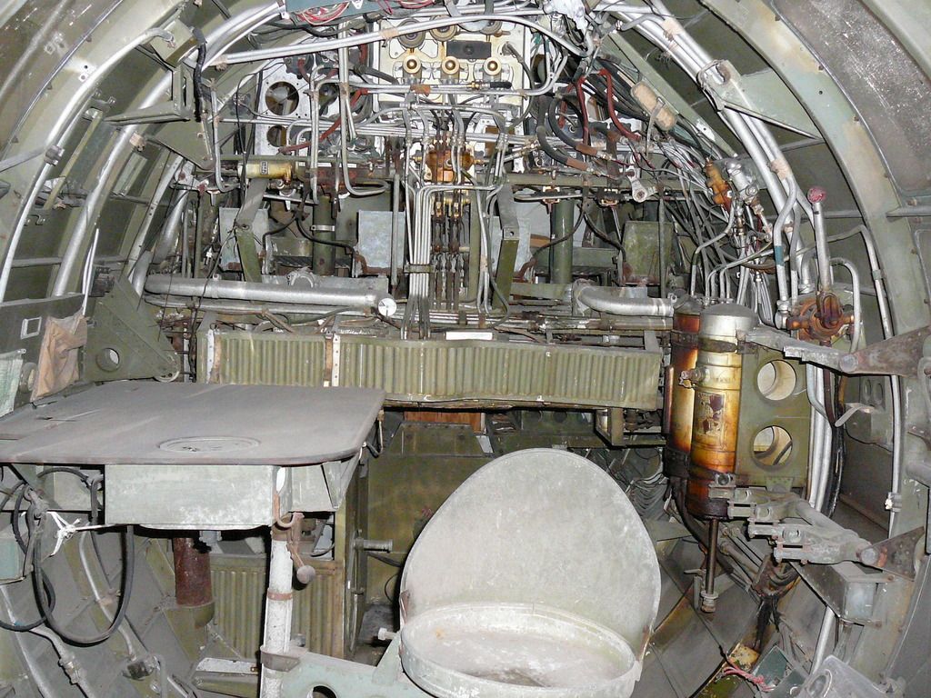

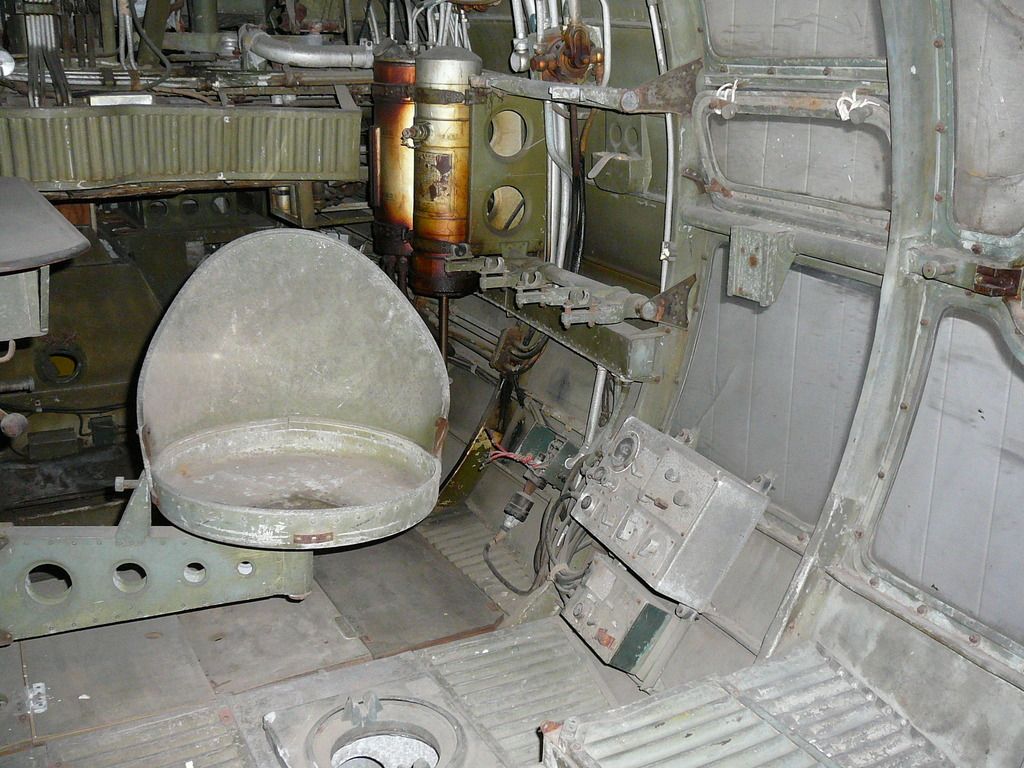

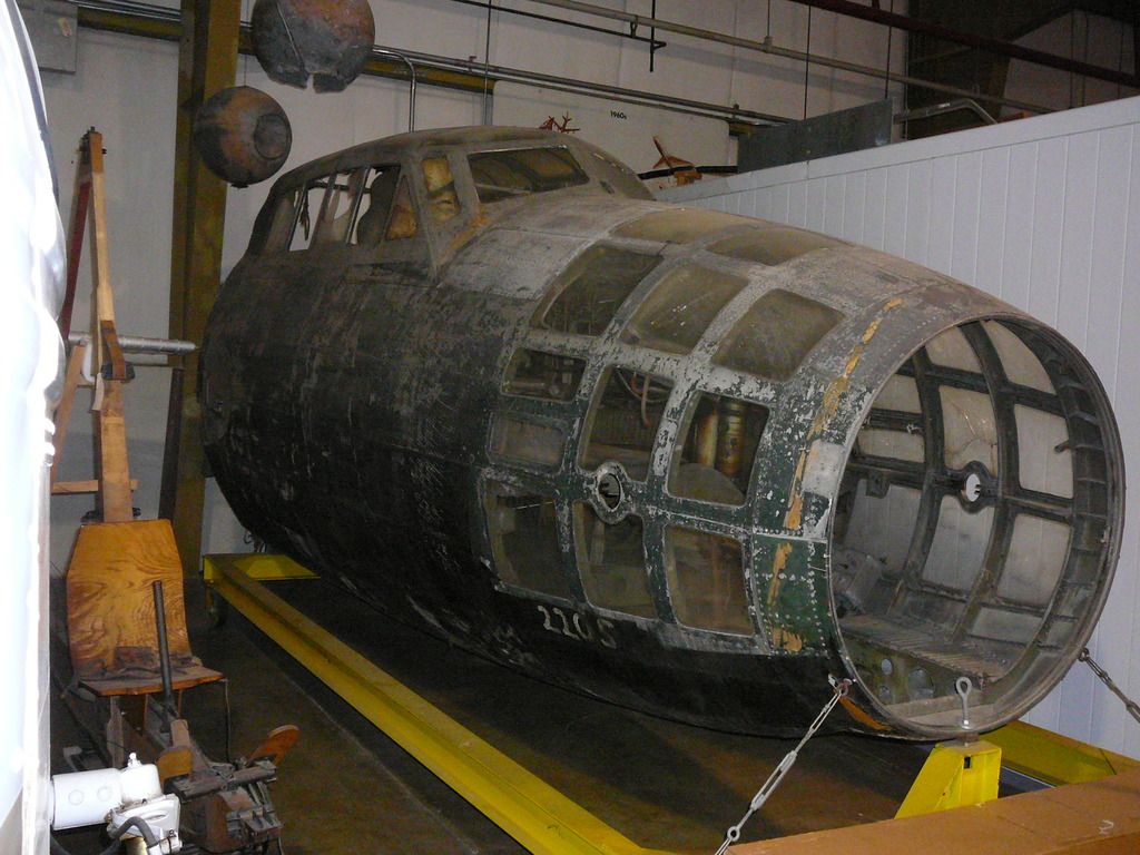

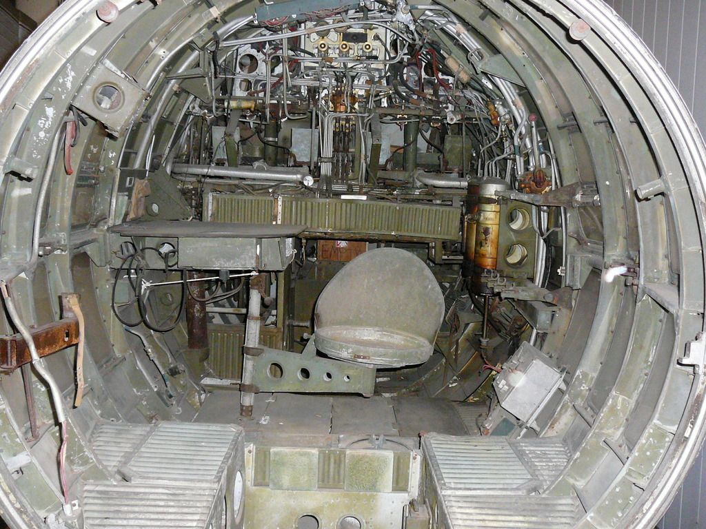

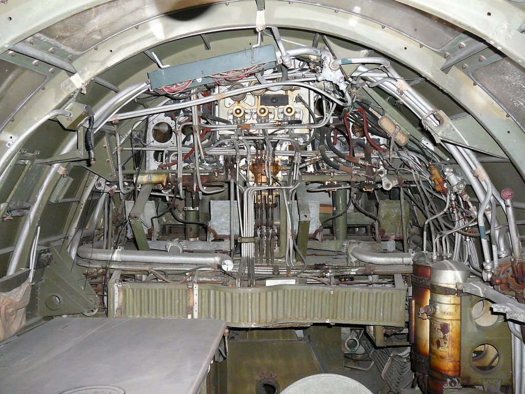

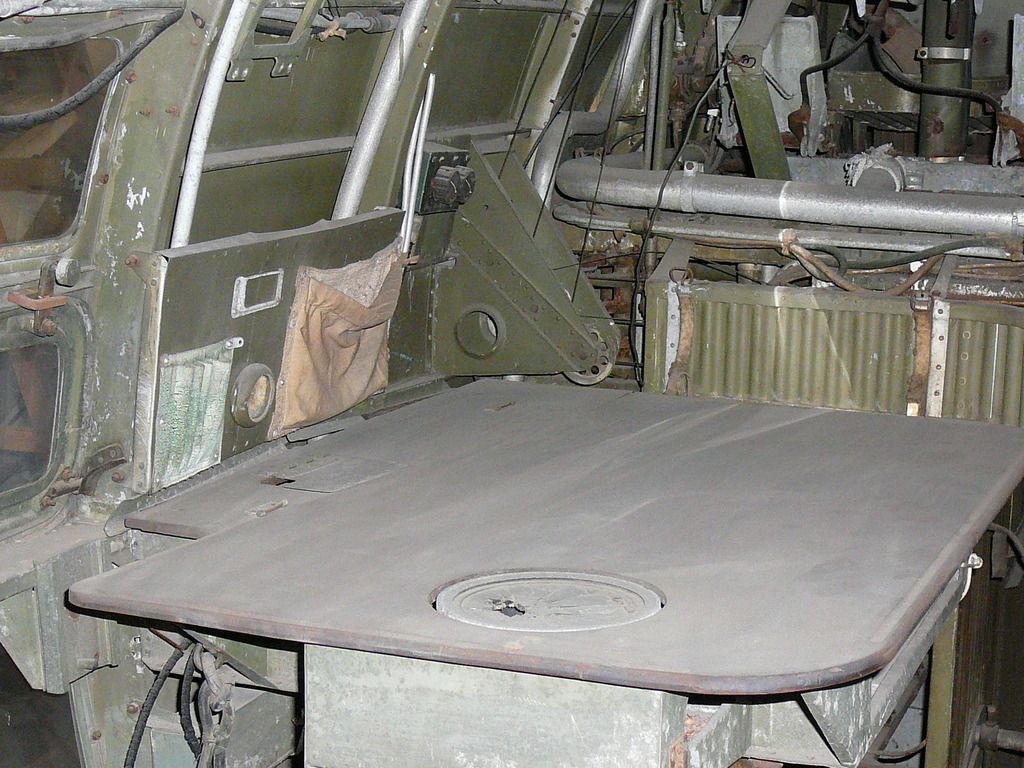

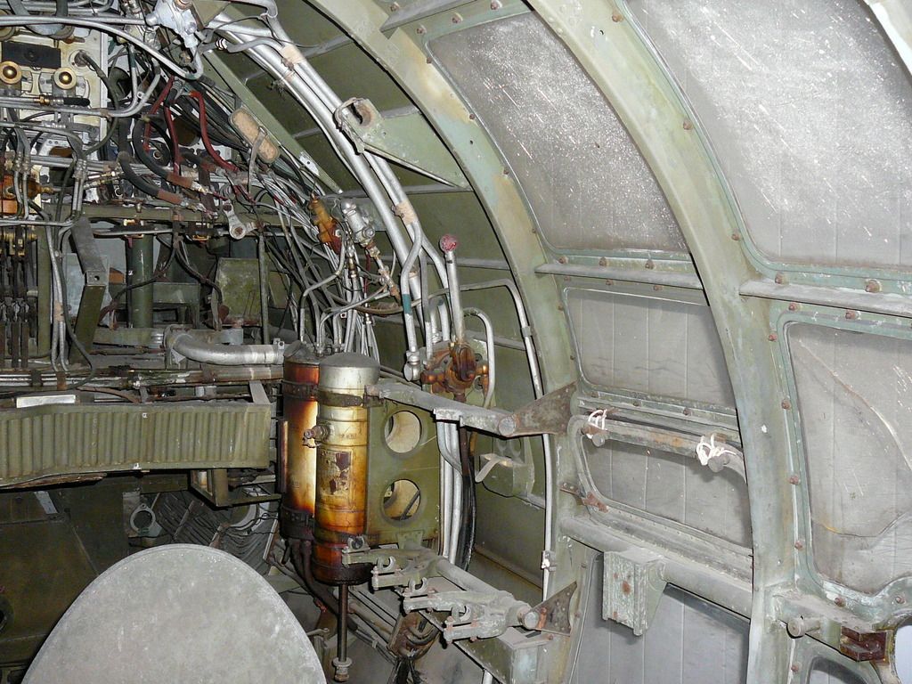

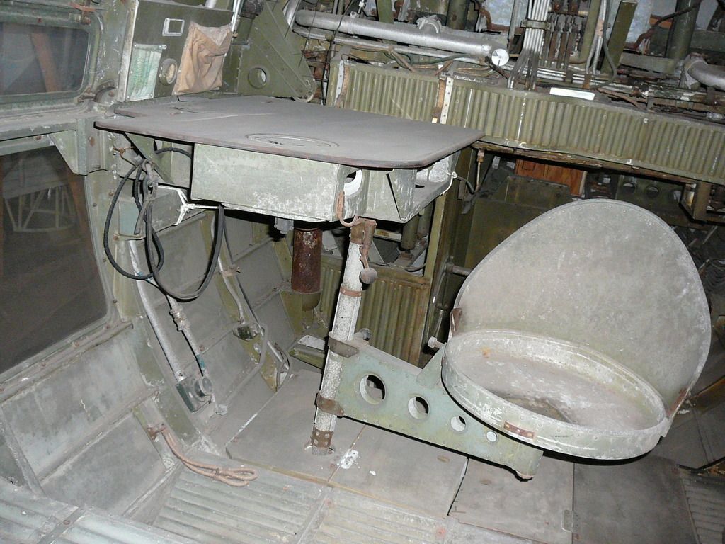

Slightly off topic....NASM's G4M.
45-47=-2
PostPosted: Tue Mar 15, 2016 7:45 pm
Posts: 490
Location: Oklahoma
Wow! Except for a few spots the interior looks practically new.
