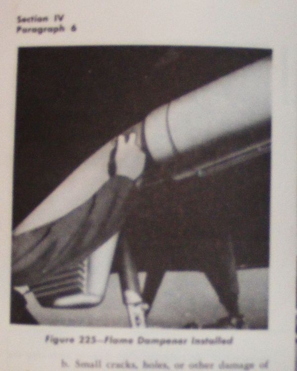

It seems there was a Douglas version, as Mothminor posted in Key
" Flame Dampeners are mentioned in the Douglas C-47 Maintenance Manual (not numbered but dated 1944 with 1948 revisions.) - it states that "2 are shipped with the aircraft as loose items... fastened into place by screwing bolts into the nut plates built into the exhaust tail pipe." "
But they look like this!
