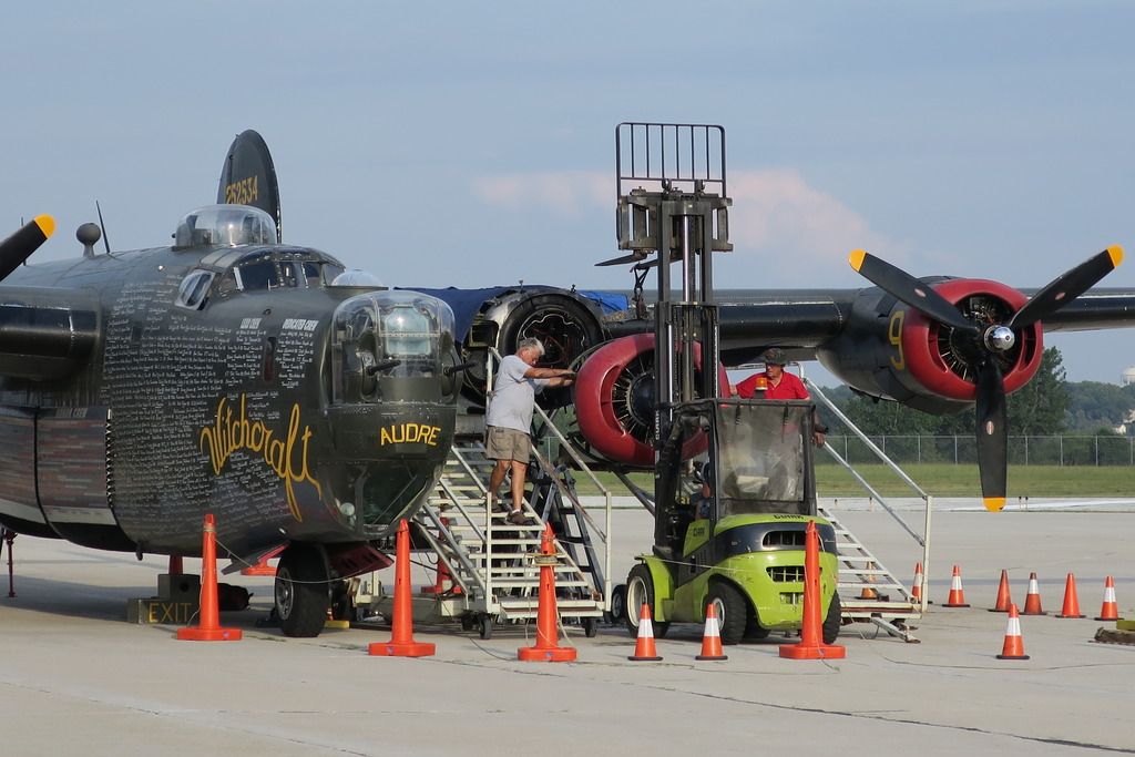

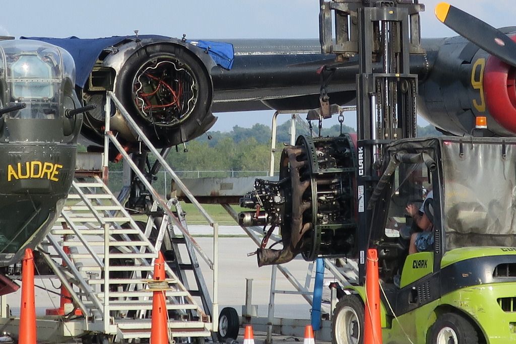

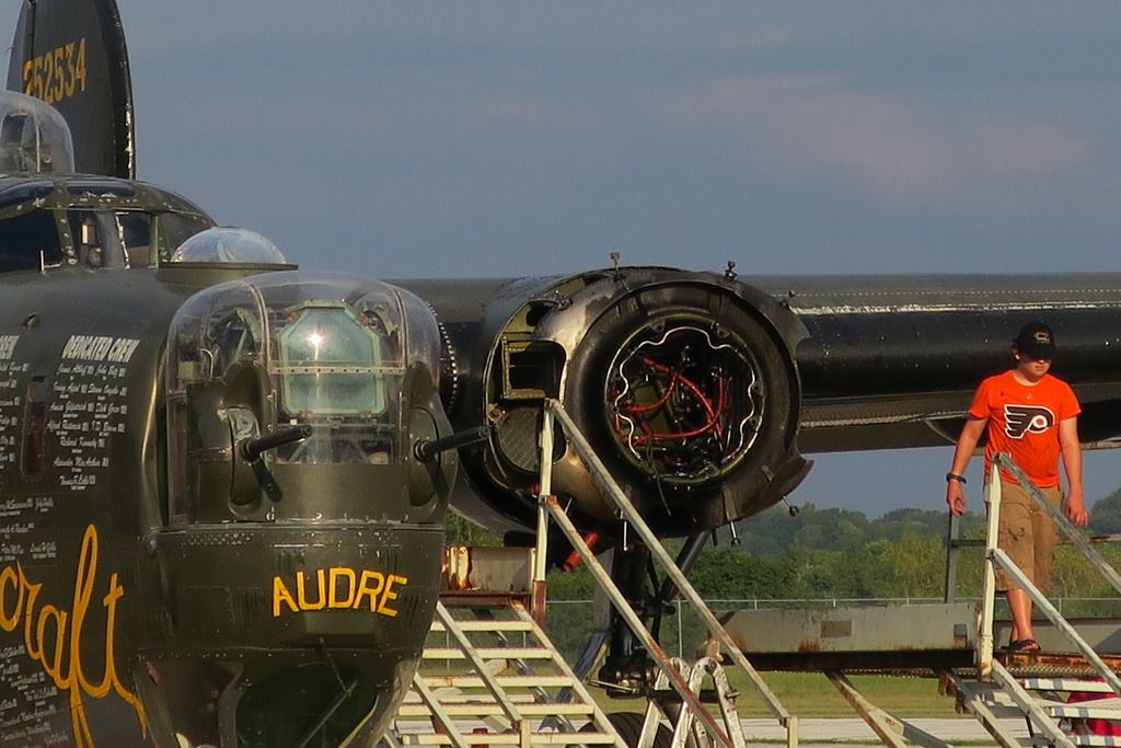

FINALLY Collings hit my local airport this year. 909 and Witchcraft flew over my daughter's soccer game last night but when I called to book a flight this morning they said the B-24 was down for maintenance. I assumed it was something small but when I got there tonight I found this. Number 2 decided she wasn't having it and is going home. Sheared cylinder studs, they decided to pull it rather than chance flying without knowing if there was metal ingestion. They still plan to be out of here Thursday on schedule.

Im always surprised how fast the crew can take off a broken part and HQ overnights a part they already have waiting just in case something goes wrong. Collings definitely have a really good system going, and really good team work and good leadership. I wish more people/organizations would follow their example.
