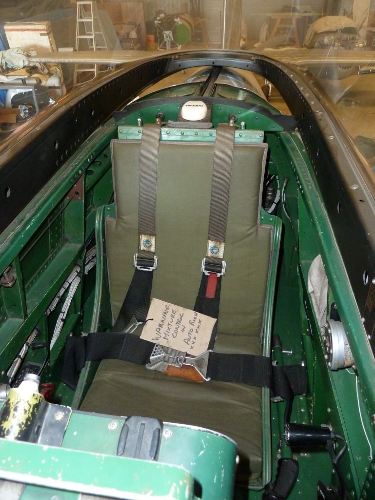

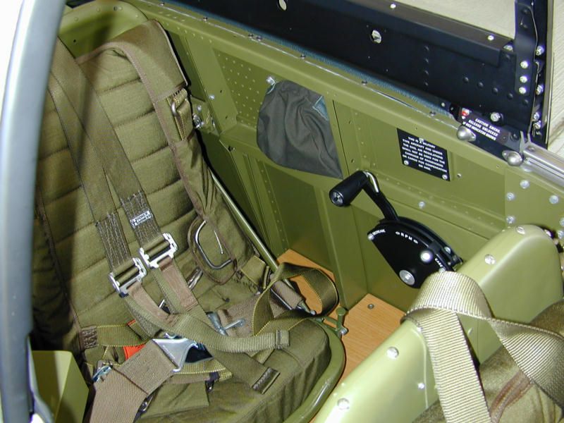

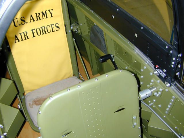

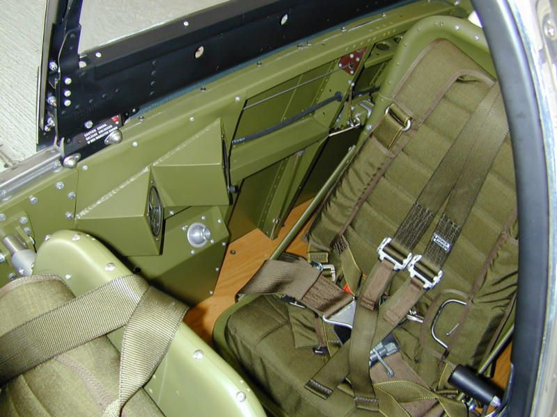

As you can imagine, there is no 'standard' when it comes to the rear jump seats added to P-51's, so there is quite a range in types of seats used and how they're mounted - usually with a means of quick-release and tilt option so that the area behind the rear seat can be accessed for storage and/or placement of modern avionics units (just as most (but not all) of the Mustangs that have rear seats fitted also have quick-release attachments at the top and mounts at the bottom of the front seat that allow it to tilt forward, providing more room for the passenger to enter the back seat).

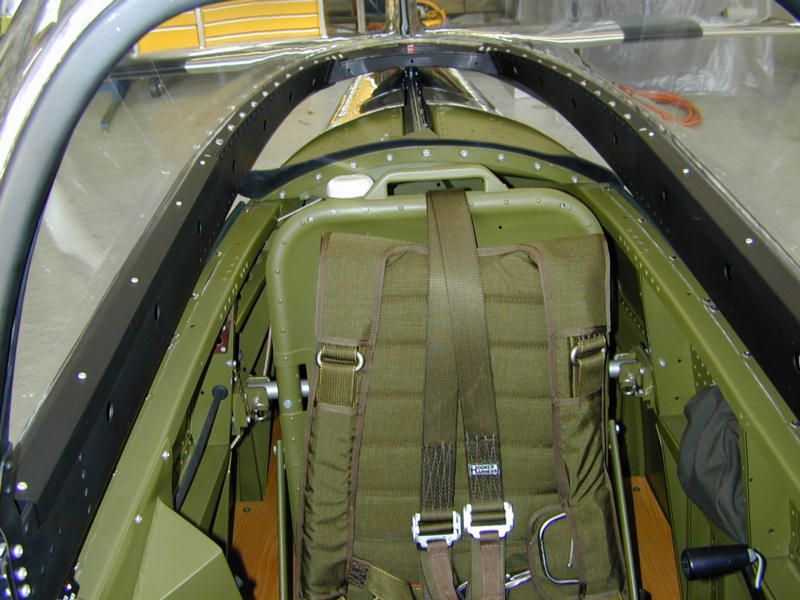

This is a photo of the back seat fitted to Tom Duffy's P-51D "Kwitcherbitchin" (formerly "City of Winnipeg").

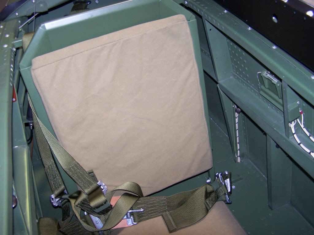

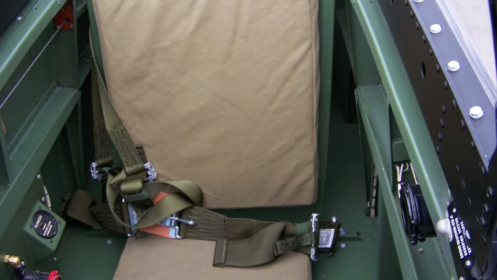

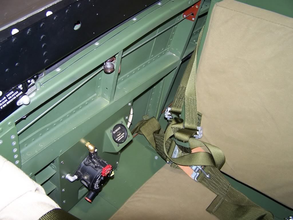

These are a selection of photos from Mike Vadeboncoeur/Midwest Aero, showing the rear seat installation on "Daddy's Girl" (which is also one of several stock P-51D airframes that has basic dual controls for the position in back). This one has a Warren McArthur style seat.

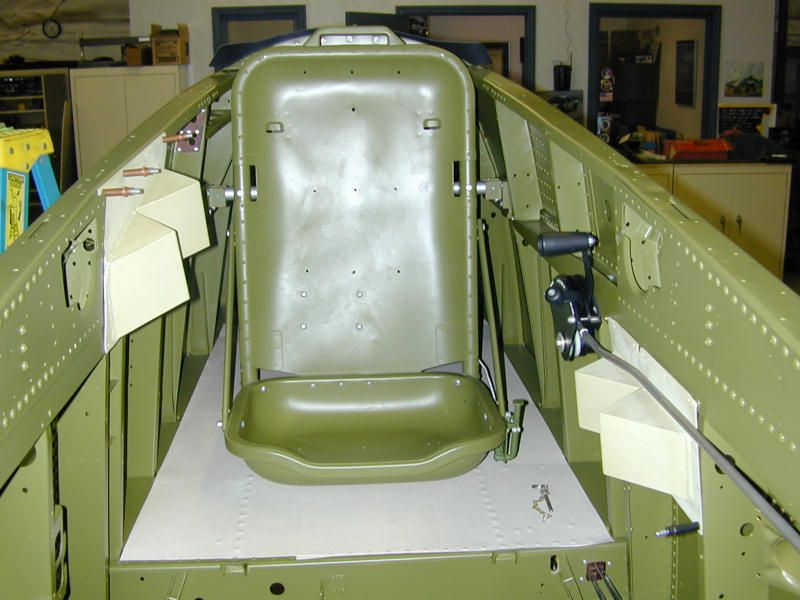

These are a few photos of the back seat on the P-51D "Miss Kandy" (formerly "Dixie Boy").

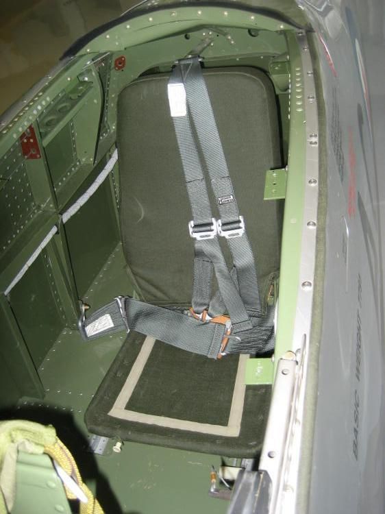

And this is a photo of the back seat of one of the Australian P-51D's, using a Schick Johnson seat. This one also has basic dual controls (note the stowed control stick and throttle - the rudder pedals for the back are fitted below the pilot's seat).

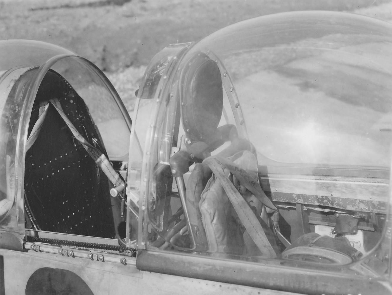

There seemed to be no 'standard' in canopy ideas for two seaters back in the day either ... 8)
A two- seat P-51 Mustang (WZ-S_, serial number 43-6953, used as a hack plane by the 78th Fighter Group at Duxford.
A two seat P-51 Mustang (VF-S, serial number 44-72210) of the 336th Fighter Squadron, 4th Fighter Group.
