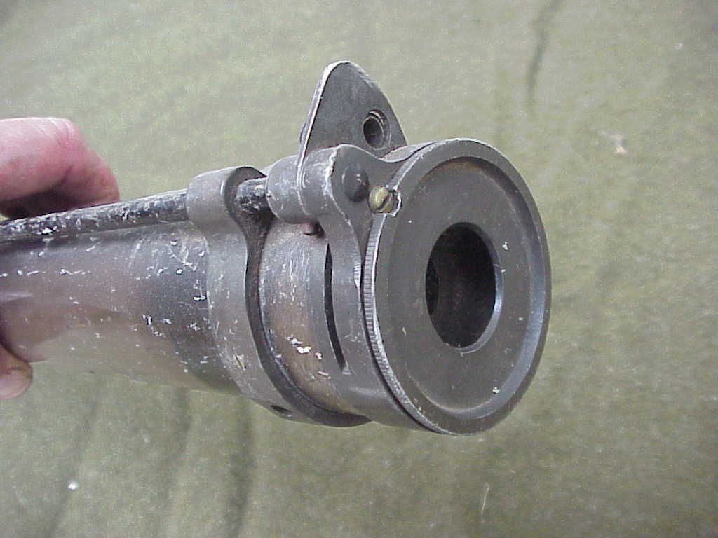

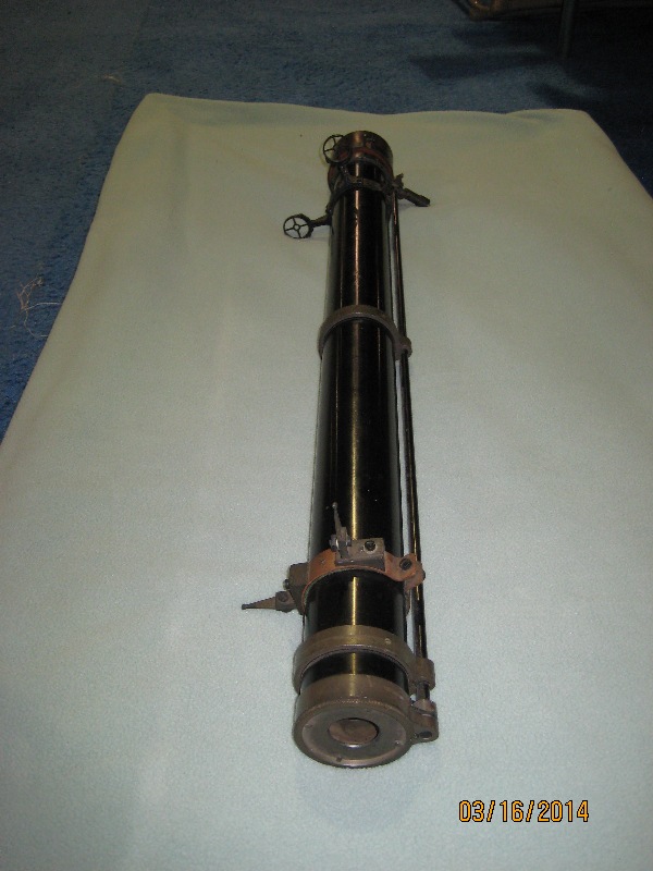

On many of the Navy fighter, torpedo and dive bombers in the late 1930s to early 1940s the navy used a tubular sight - Mark 3 before they went to the reflector variety.
On this reflector sight there was a lever by the eye piece that the pilot could rotate and this rotated a shaft which operated a device at the far end of the sight. Does anyone know what the purpose was of that lever and mechanism?

I had one once, wish I still did. It opened and closed the telescopic opening. I'm assuming so it didn't get bugs or dirt in it.

Sun shade filter

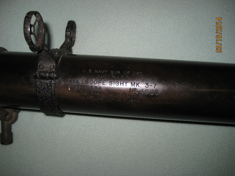

Here's a couple of photos, first is of a TBD, second SBD
I think I have a few better shots. I'll see what I have and post them.

Mine didn't have the sunshade on the end. Just a small cover that opened and closed a small flap over the optics.

Thank you for the responses. I have a pic of the end of one also. I cannot tell if this is the flap variety or the sunshade?

The one in our collection has a cover just like turkey hunter describes presumably to keep the optics clean when not in use.

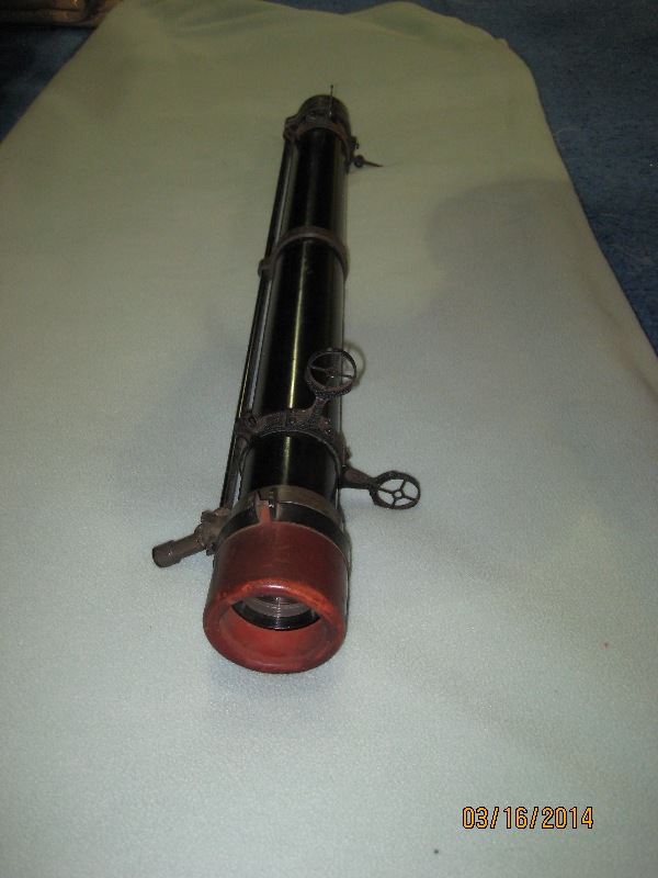

There seem to have been several telescopic gun sights like this on fixed and flexible guns pre and early war but they apparently died quickly. I can see why because to use them you have a severely restricted field of view and target acquisition would be difficult. True tunnel vision!
In Marks second photo you can see the small ring and bead sight on top of the tube. Ours has two at angles. Maybe they got close with the ring and bead and then would transition to the telescope. I guess this might be good for ground or fixed/slow moving targets because deflections shots would be real hard and would quickly go out of the field of view.
I think it would be quite accurate for air to ground gunnery or bombing for precision but hard to use for air to air.

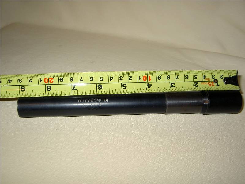

The early flexible gun mounts in some 30 and 50 cal applications had a smaller telescopic sight which sure seems limited to me. The C-16 mount in the AT-6 and AT-11 and the PBY and many bombers all had this early style of telescopic sight.

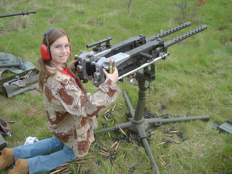

Here is my daughter, years ago, with a twin 50 setup I made to go plinking. It was to replicate the twin 50 mount in the tail of the B-17 but can be found in the field mod noses on some early Forts.
You can see the telescopic sight on the left gun

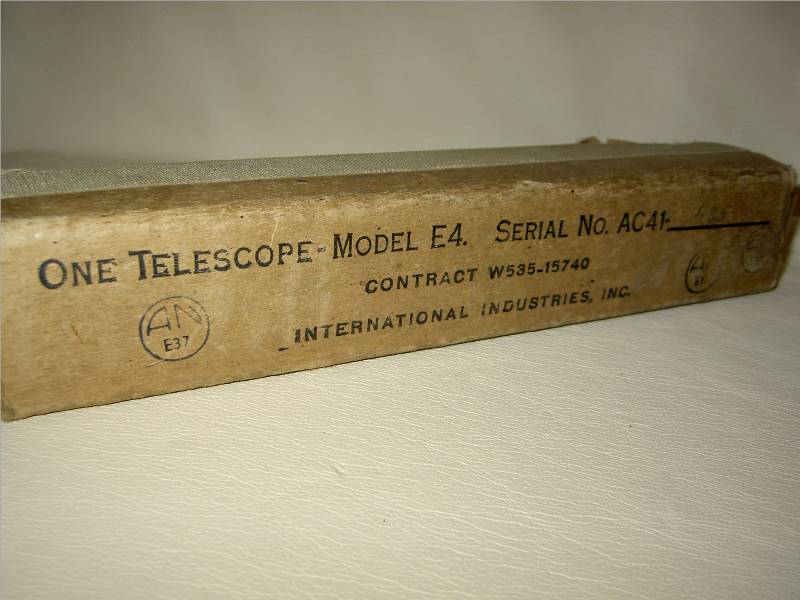

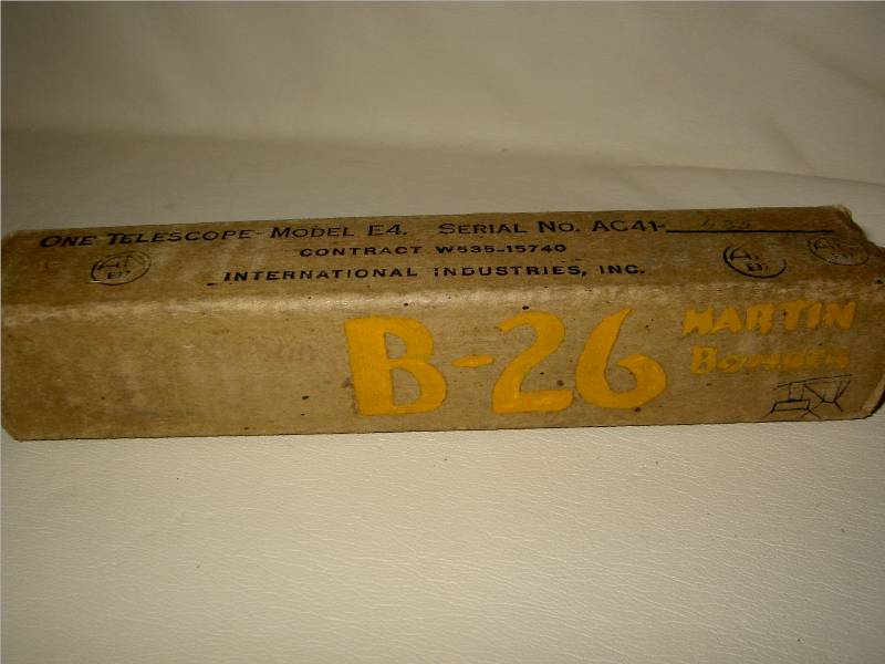

Here is a sight that was marked for the Martin B-26. Not sure who painted it on the box but I would not be surprised to have seen it installed on early Marauders. The contract number is Air Corps/AAF
