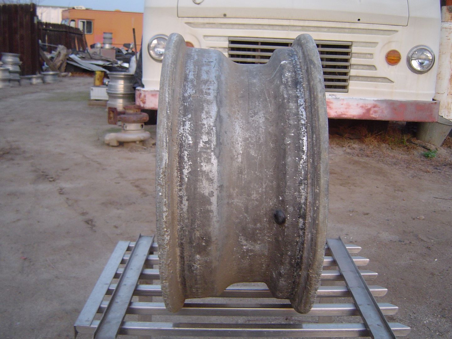

Hello,
I'm new to this Forum, and what I need is a little help in identifying some Vintage Aircraft Wheels and Tires I have!
I have (2) 8-Spoke, and (4) 10-Spoke Magnesium "Goodyear" Aircraft Wheels...along with (2) Aluminum Wheels and Tires that I believe are off of a "Caribou"...as well as (2) small Fiberglass Wheels with Tires!
I can e-mail you some photos of them , or Post them on here...(if I can figure out how)!
I also have some Part Numbers, if that would be better!
Any help would be Greatly appreciated!
Thanks, Greg Shelton

Greetings Mr. Shelton...and welcome to WIX!
I sent you an email to which--if you choose--you could reply with your wheel pics attached. I'd be happy to post for you.

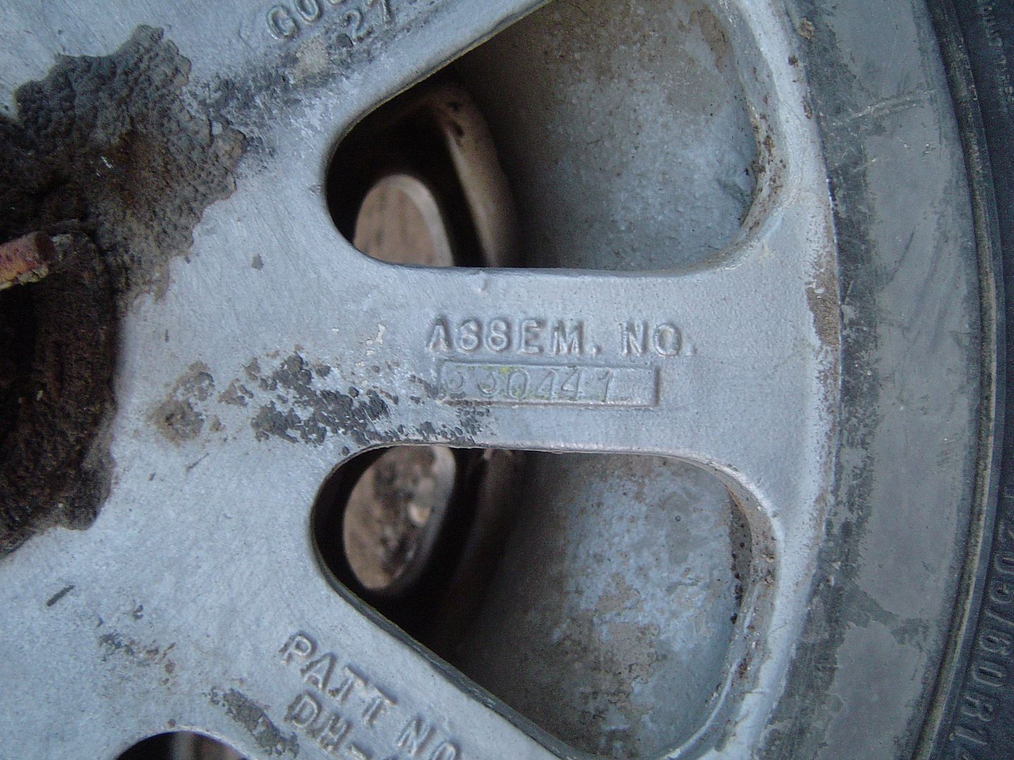

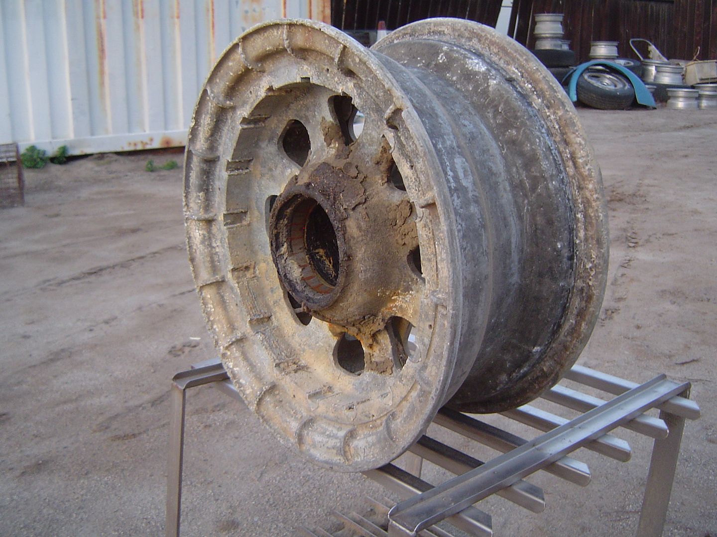

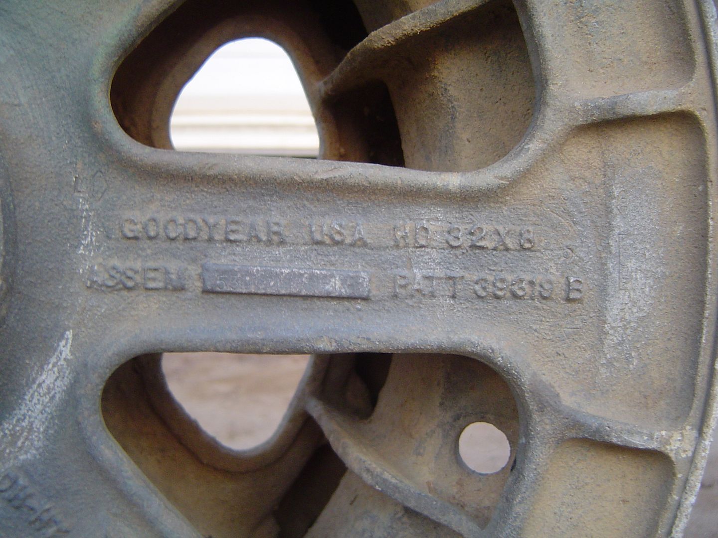

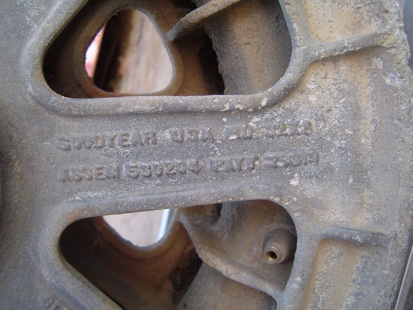

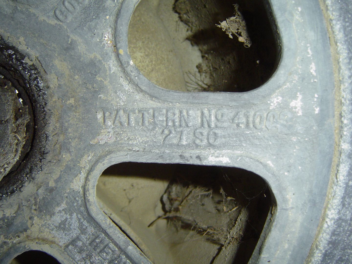

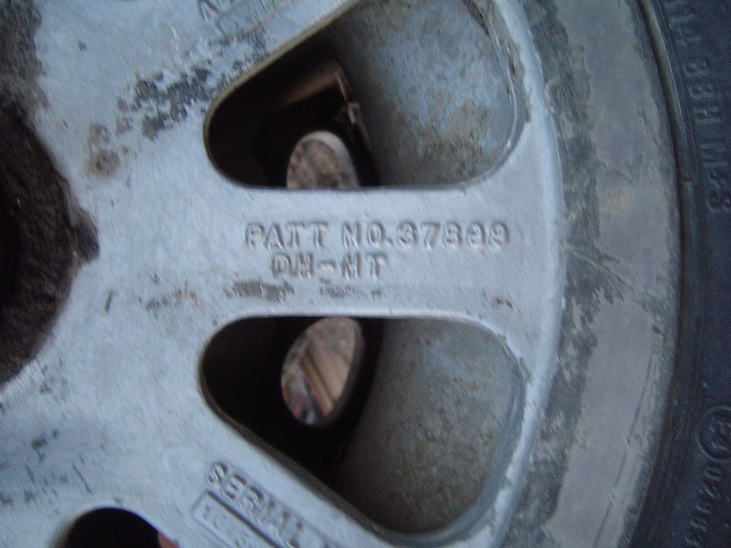

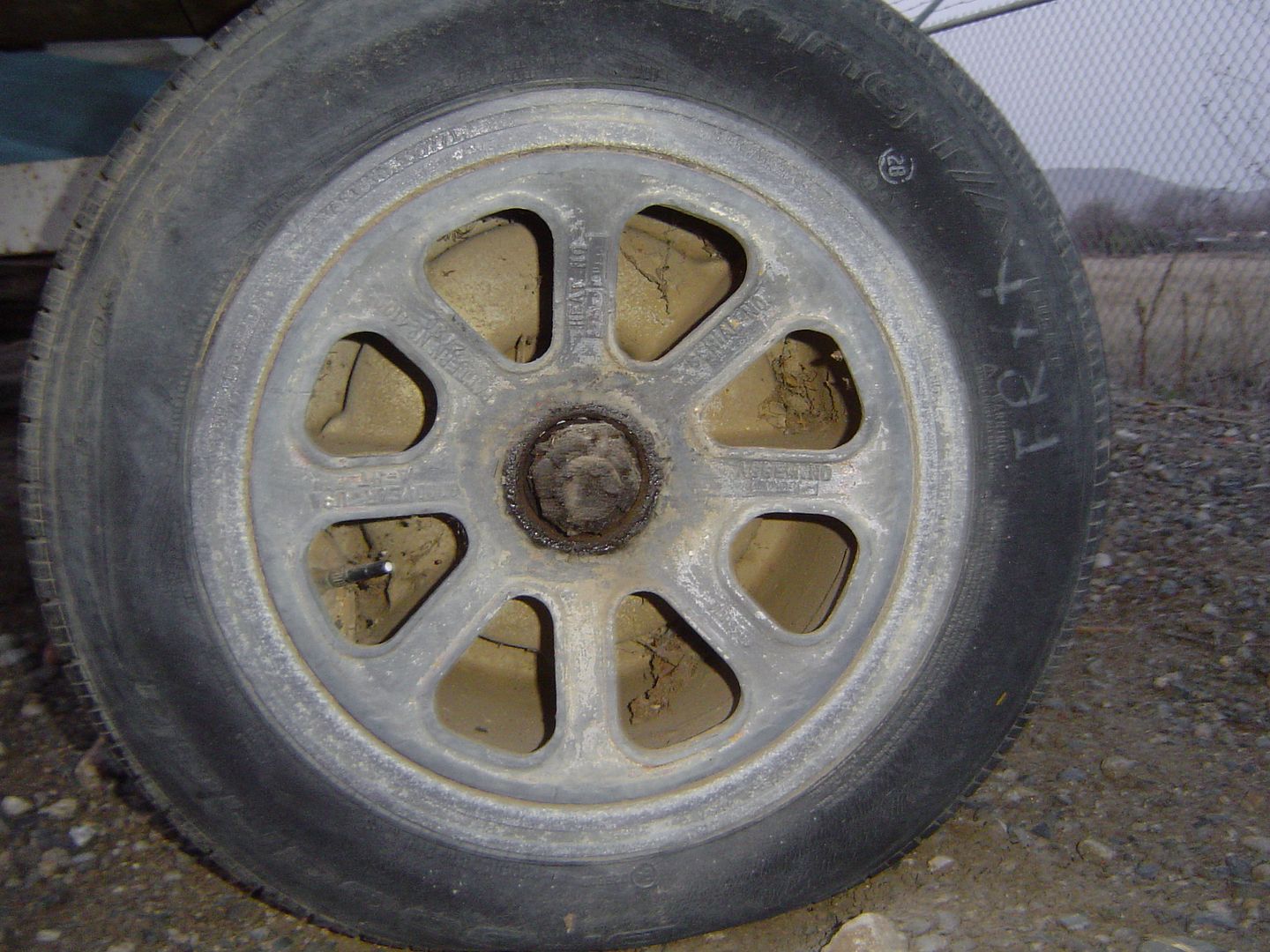

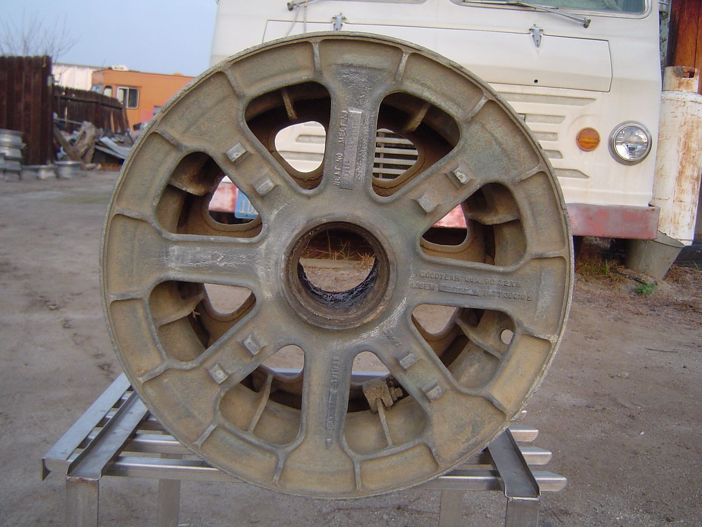

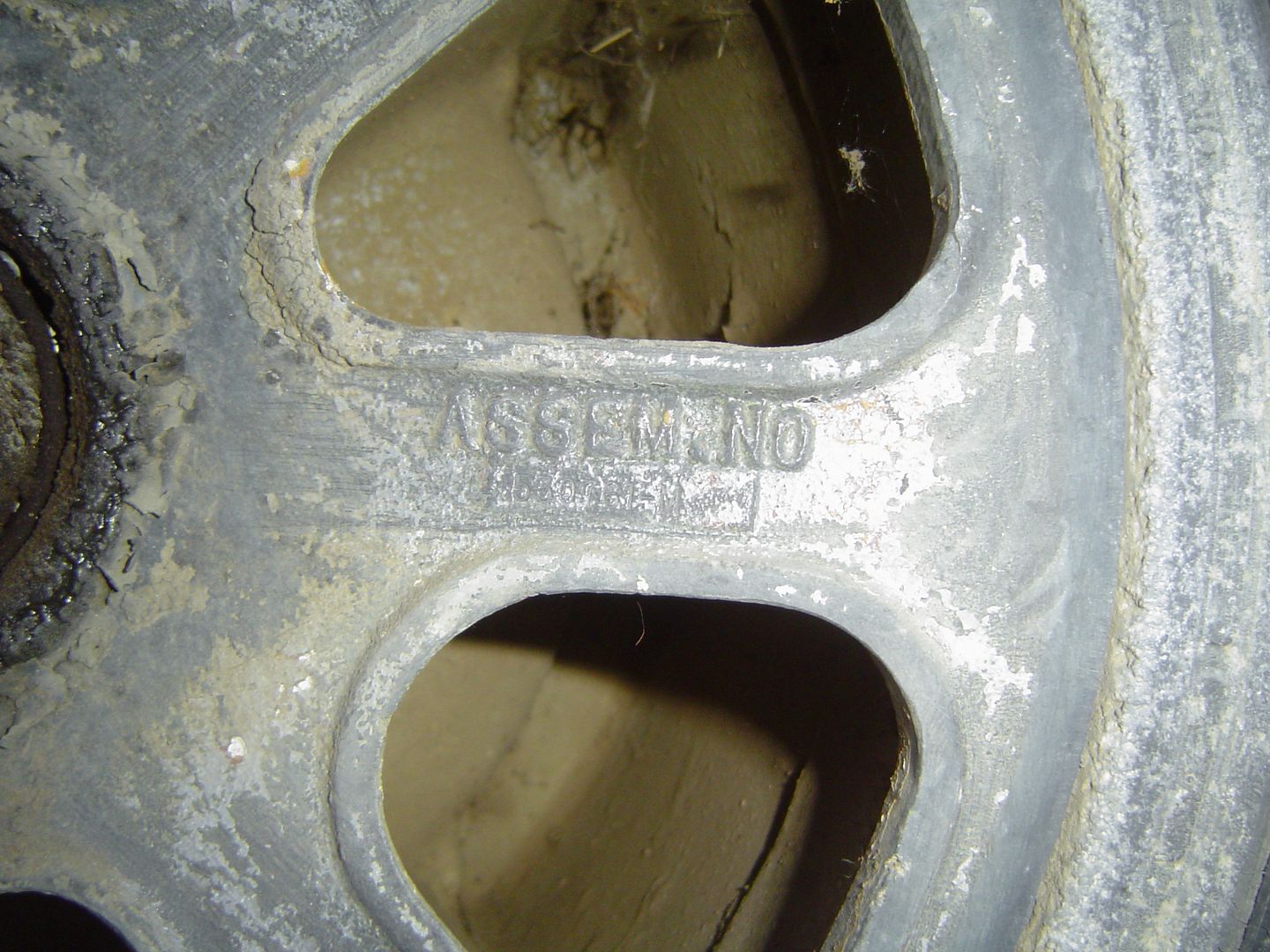

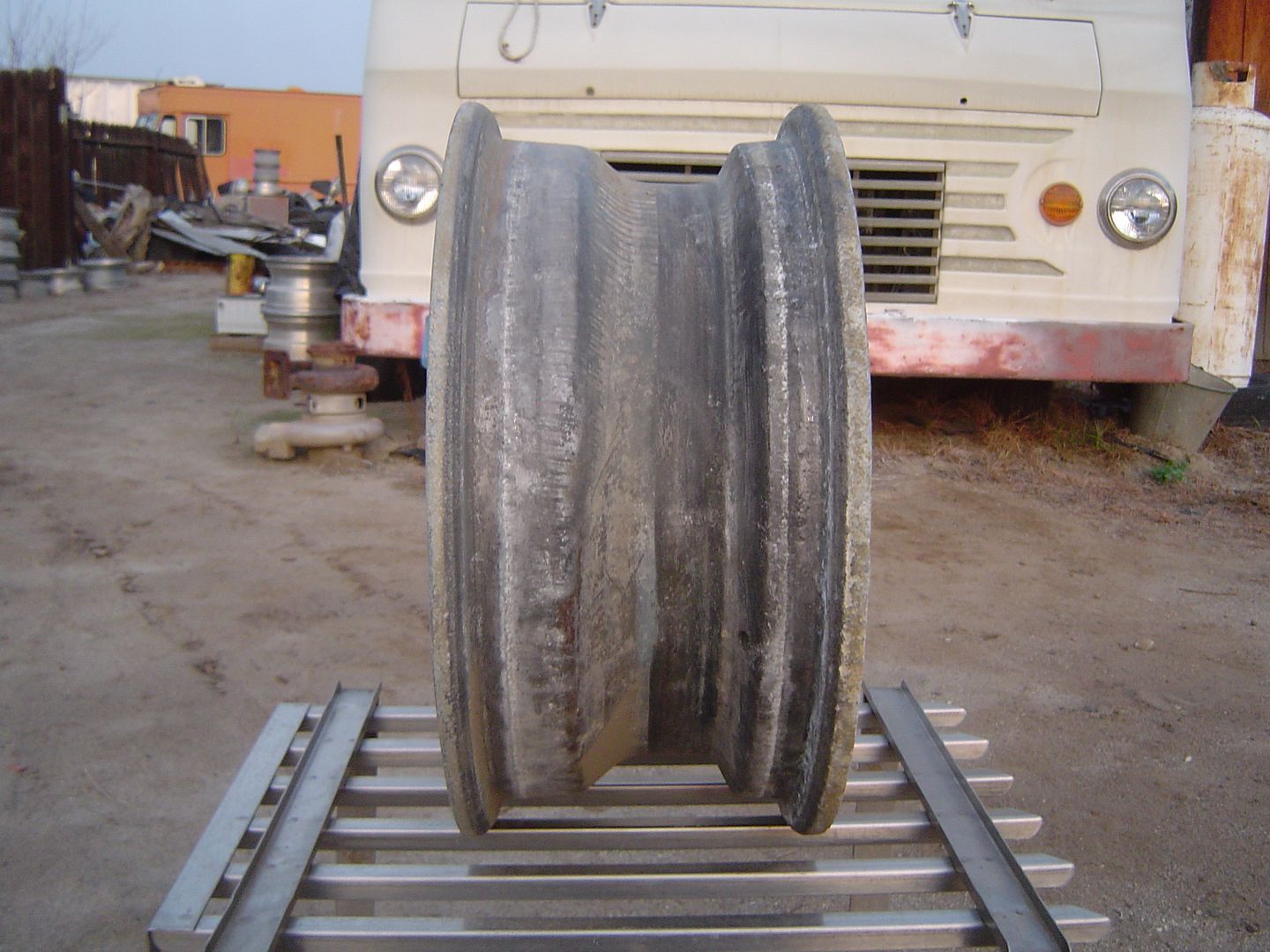

Here you go, everybody.
I'm not sure if I got Greg's pics in a correct sequence...he'll have to let us know.

Per this http://tailslide.firelightsoftware.com/ ... 00028.html the 32x8's were used on Corsairs.
The 27SC's - T-6/P-51?
45-47=-2

The 27SC wheel is P-51. It's got the grooves for the brake rotors - 7.6" brakes. :)

32X8 could also be F6F I believe.

Any P/Ns off the wheel would help.
Axle dia and brake type can be different even though they are same size.

The 27SC actually looks like a P-63 wheel, while the one above it looks like a P-51 wheel.
