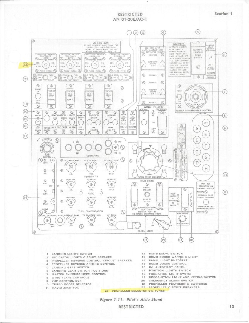

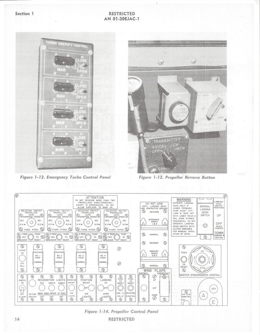

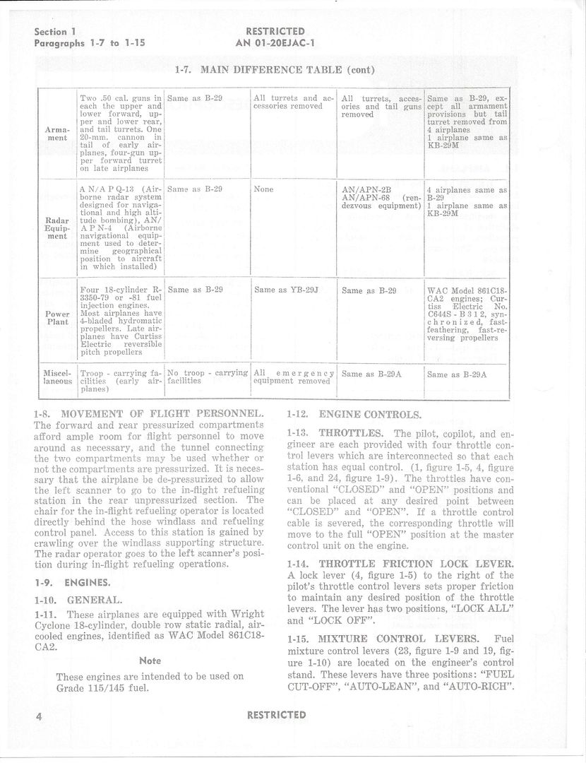

The B-29J "Andy Gump" airplanes had reversalbe Curtiss Electric props on all four engines.Here are some pages from the flight manual:
These two pages list the differences between the various B-29 models:
Here's info on the Prop Controls:
Here are the illustations of the Reverse Controls on the Pilot's Aisle Stand:
Here's what the manual has to say about Cross Wind Landings:
For those of you who aren't familiar with the reason for the B-29J being nicknamed "Andy Gump",it was due to the area under and behind the engine cowlings.It looked like it was missing it's chin.Andy Gump was a popular character from the daily comics who was definitely lacking in the chin department:
