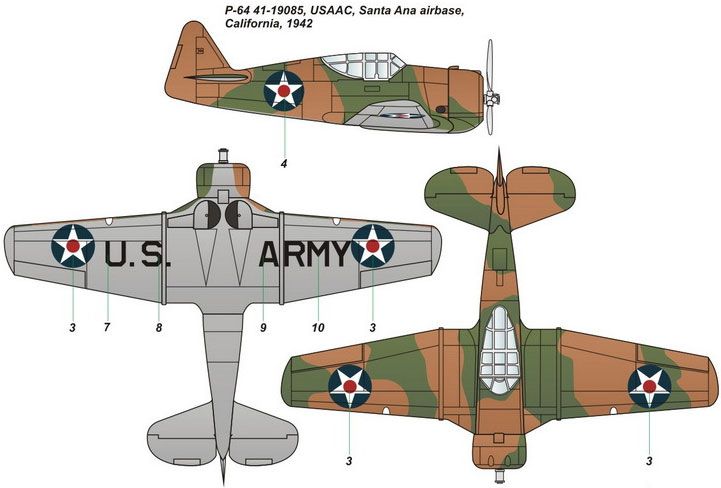

That is not even close to a P-64, it still has the Mea west's the rudder is a SNJ-2, the razor back is too low, the engine is too small, and the landing gear doors are T-6.
Maybe a NA-50, but no where near a P-64.

Matt, you are so correct on all those items.
And yet, for me the most obvious fail of a converted SNJ is the wing. The P-64's is a thing of beauty..shades of the Vultee Vengeance!

The 64 had a Wright 1820 of 800hp when built, they were upgraded in the field with 1000hp engines.
The replica that Carl Schmieder built had a 1820 of 1425 hp, it was a monster in that airframe, hit the starter and as the prop turned, the whole airframe rocked side to side. We never did find out if it could take off at full power as we could not find a runway wide enough.
The wing is neither SNJ or T-6, it was a mix of a SNJ-2 center section and Yale outer wing panels

The cowling looks too small to be a 1820, if it is, then they got something going for it. It would be interesting to see how they got it in there, we had to have the oil tank behind the rear seat because the engine had to sit too close to the firewall to fit a oil tank in the normal T-6 location. We also had 2 oil coolers, one in the engine bay and one under the baggage compartment floor. The tail cone was a busy place as we also had a smoke oil tank, O2 bottle and the battery in there.
