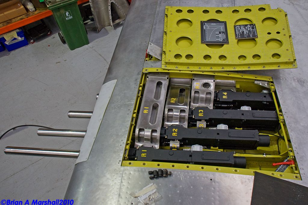

Yep, the barrels are all the same length..it was the guns themselves that were staggered. Here's a pic from the Duxford homepage showing the installation (I'm assuming during Snafu's rebuild.)

Anorak alert!
Looks like those are AN/M3s (generally used postwar with a higher rate of fire- standardized in April of 1945) rather than AN/M2s. You can tell by the larger diameter buffer in the receiver back plate. Not sure if that is a correct gun for this aircraft.

bdk wrote:
Anorak alert!
Agreed.

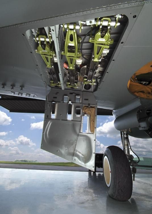

On the subject of P-40 gun bays, all three of the P-40's restored by Fagen Fighters/Warhawks Inc. (which you should be familiar with) have fully out-fitted gun bays (150+ individual parts per gun bay). Here's a photo of one of the gun bays on Fagen Fighters' first P-40K restoration (now owned by the Texas Flying Legends Museum).
Photo by Greg Morehead. Photo found here (and originally published in Warbirds Digest issue #10): http://www.courtesyaircraft.com/Current ... 0Specs.htm

I am very familiar with Fagan Fighters, and I try to get out there every chance I get, but they are always buttoned up and now I see why. I'm glad to see that its not a case of oh well, no one will see then anyway so we don't need to include these parts. The only pics I could find were grainy black and white close ups of the gun bay that didn't show any reference, so i wasn't aware that they are on the bottom. Thanks for all the replies!!
