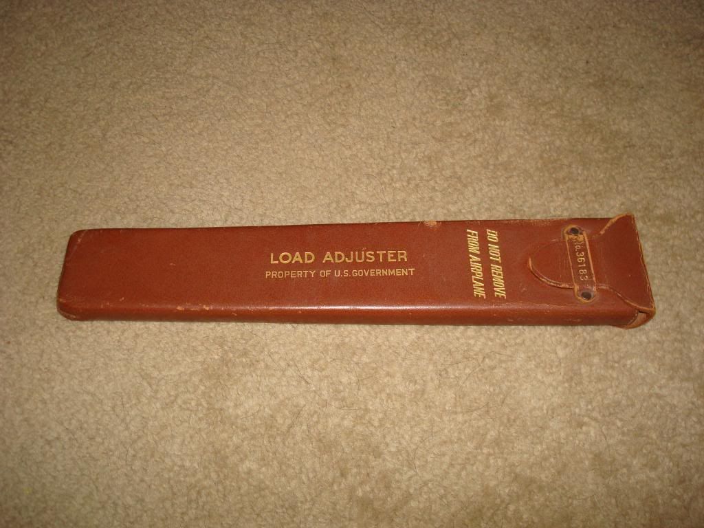

The wife and I open gifts early, since family comes to visit. She is probably the coolest wife ever in that for Christmas and Birthday, so finds me old airplane parts, military memorabilia, and the like.

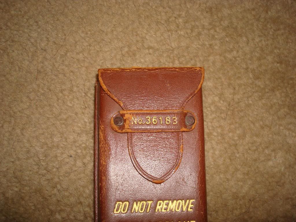

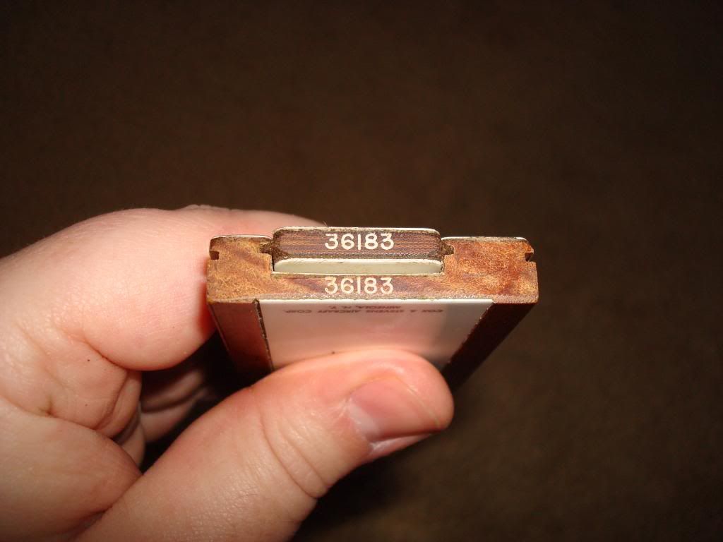

The year, the piece de resistance is a B-17F load adjuster. With case. And matching numbers. And it`s in pretty good shape.
Now here is my problem: I don`t know a lot about load adjusters. I thought they were serialized to match the airplane. My slide rule and case are both marked 36183. I was thinking maybe that would correspond to a 42-36183, but the B-17 serial number charts don`t list that s/n as having been used.
Can anybody shed light on this? I would be most appreciative. Thanks and Merry Christmas all!
-17f
PostPosted: Sun Dec 22, 2013 10:49 pm
Posts: 1132
Load adjusters were usually serialized from the factory but it was specific to the piece of equipment and didn't have anything to do with a particular airplane. Most were later serialized to a particular airplane as a means of accountability to ensure the load adjuster stayed with the airplane. They were not calibrated to a specific airplane or anything like that. They are neat pieces of equipment. I've probably got a dozen or so. I have used one to do the weight and balance on "FIFI" a time or two in the past.

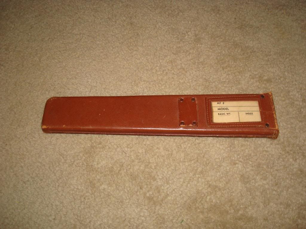

PostPosted: Sun Jan 12, 2014 5:31 pm
Joined: Sat Sep 25, 2010 10:56 pm
Posts: 87

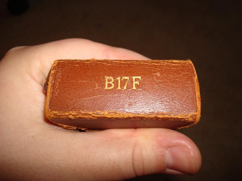

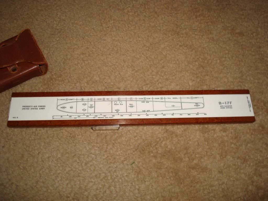

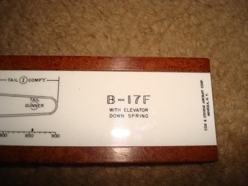

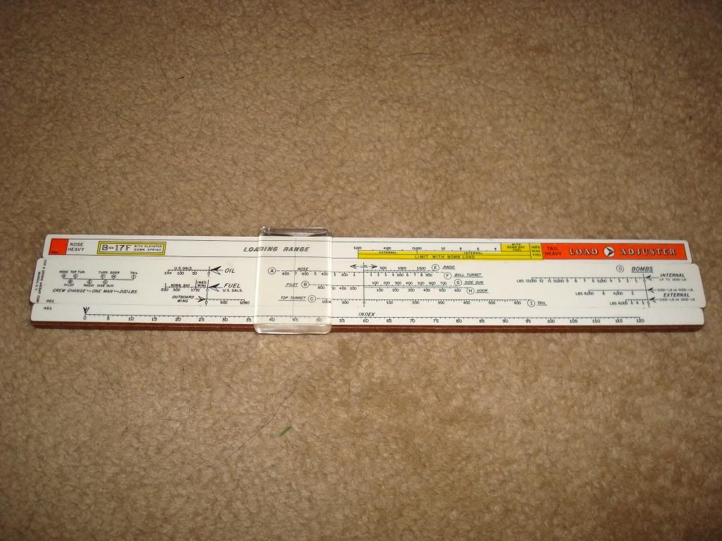

Photos as promised. Sorry for the delay - the new year has been crazy so far...
EDIT: Please pardon the dog hair on the carpet... :oops:
