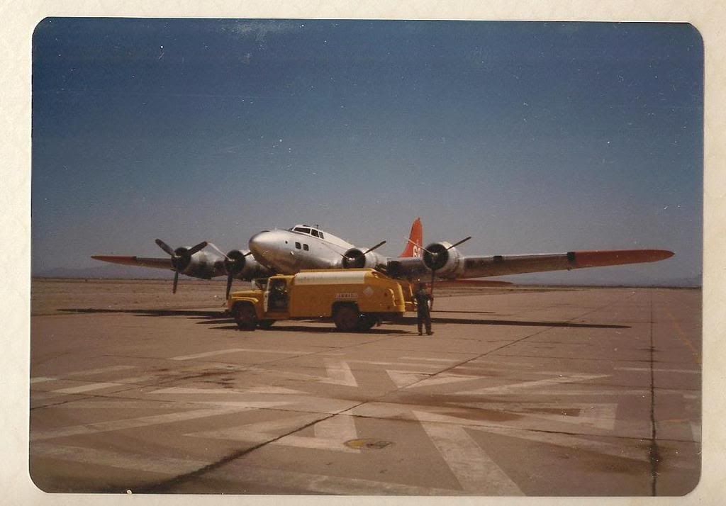

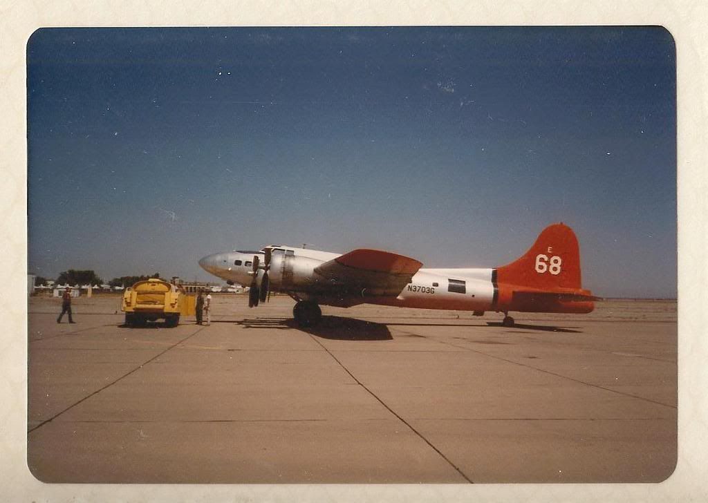

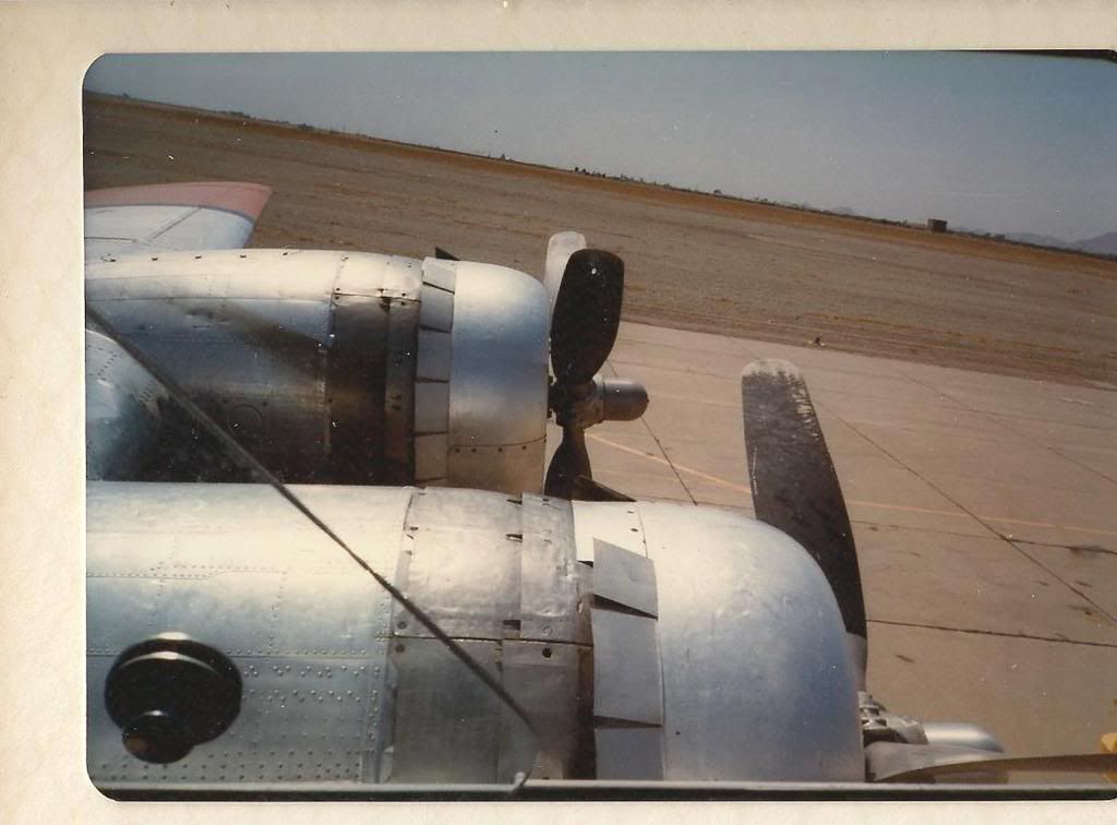

I ran across some pictures that I took "the morning after" at Williams AFB just after refuelling from T&G's fuel truck.You might notice that all of the props except for #4 are still feathered.The last 12 miles was on #4 engine only.I don't want to try THAT again.If anyone is interesting,I'll add a narative of how it came about.I also ran across my pocket daily log that covers the flight.

Jeeeeez!!! That must have been a real wing and a prayer experience! Please tell us more... some of the readers here might find it useful. I know I would be interested to hear the story. Thanks for posting the photos... does this B-17 still exist?

Richard,that airplane went to Dave Tallichet and is now The Memphis Belle aka N3703G.I'll work on a narrative and post it in a day or two.Basically,I was dispatched from my home base at Alamogordo to a fire by Roosevelt Lake north of Phoenix.After dropping on the fire,I went to the nearest tanker base at Coolidge to fuel and reload.There were several other tankers (P2V's,PB4Y's and another B-17) waiting for the fuel truck ahead of me.I was asked if I'd initial attack a new fire 20 miles from Coolidge.I stuck the tanks and the lowest was 105 gallons and I had 75 gals in each Tokyo tank.Against my better judgement,I reluctantly accepted the dispatch.

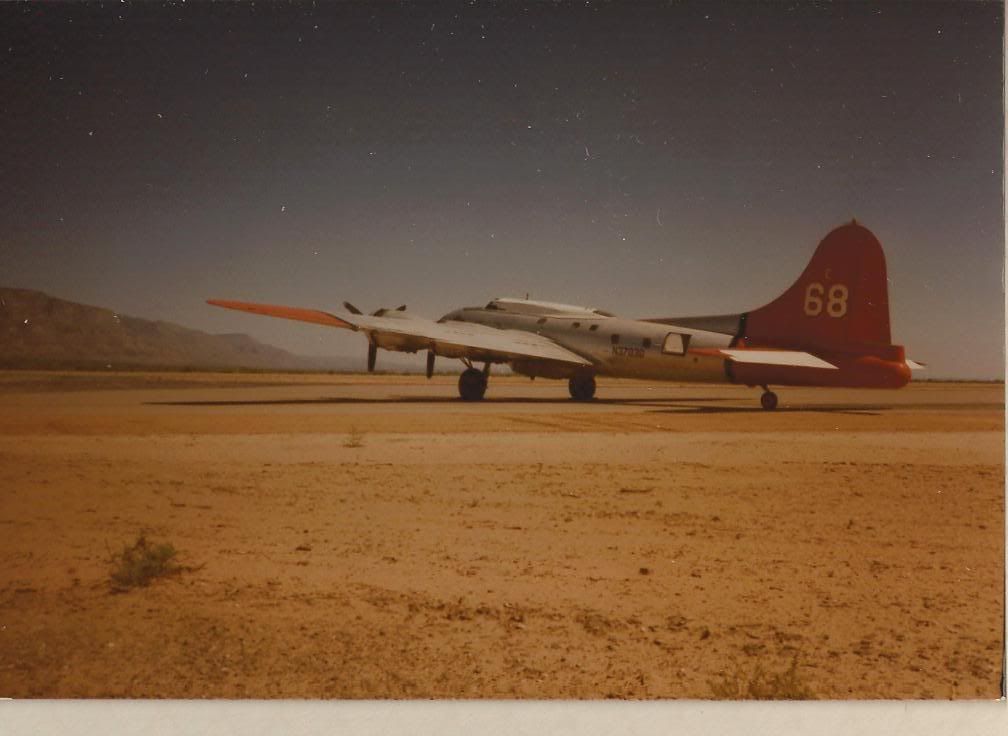

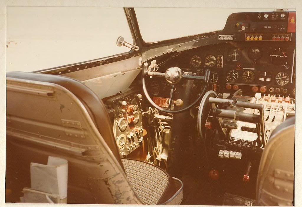

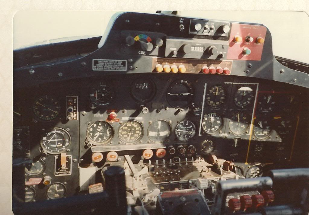

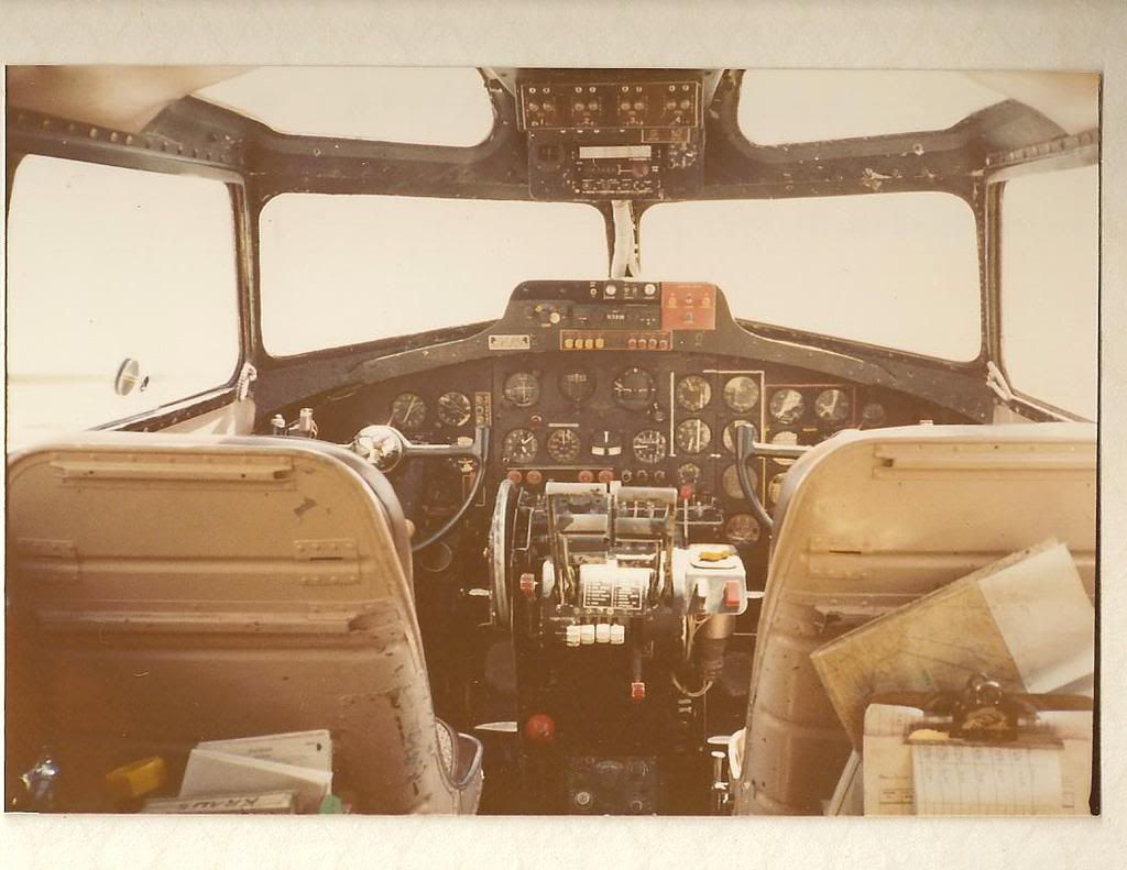

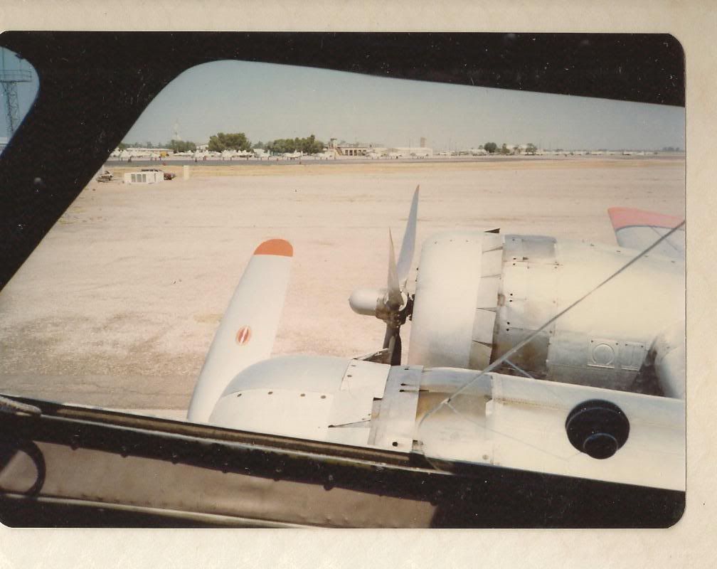

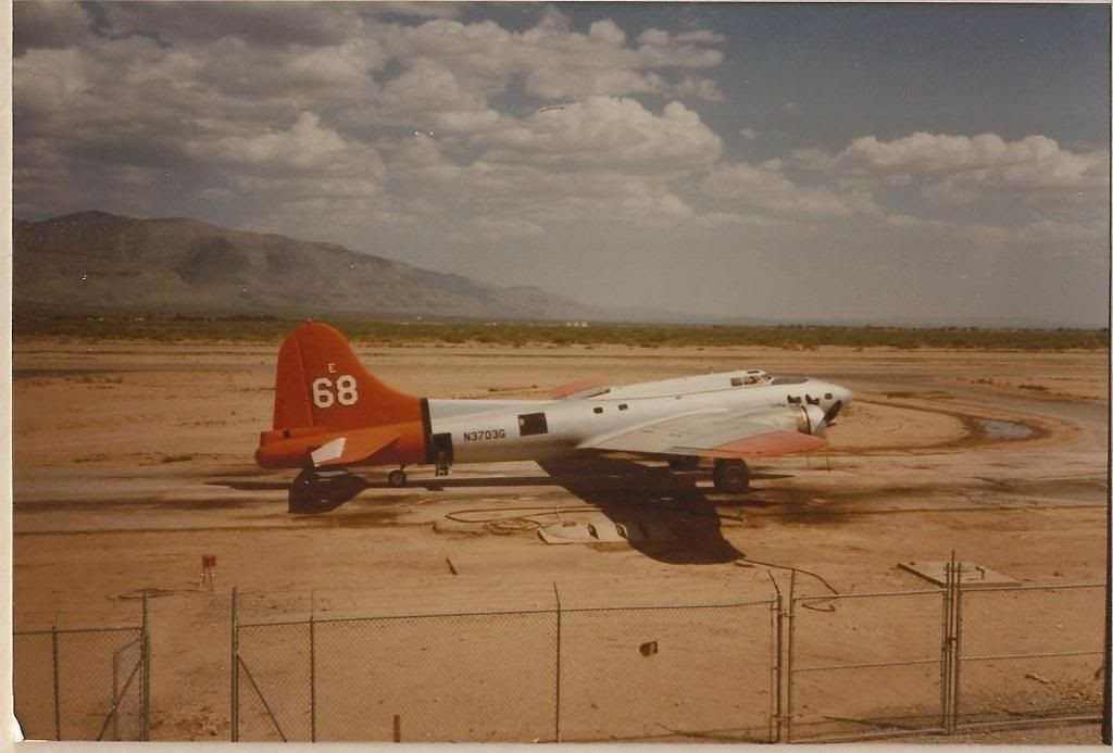

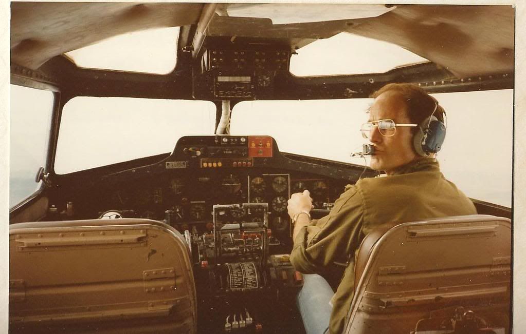

1.Alamogordo,NM (ALM) Airport looking east
2.Tanker 68 on the day off parking area at ALM
3.Tanker 68 in the ALM loading pit looking south
4.Oiling #1 engine on Tanker 68 at ALM
5&6.Cockpit shots of Tanker 68 on the ground at ALM
7&8.Tanker 68 at loaded cruise power (31"/2100 RPM) with my co-pilot Bill Rhodes at the controls on the way to a fire from ALM
All of these pictures were taken sometime between April and July 1980
