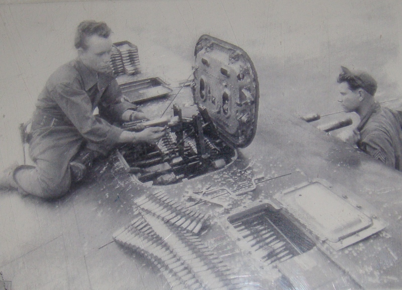

It's a wild ass guess based on not much but I think its A-26 wing gun. Some A-26's had 6-50 cal guns inside the wing and others had the external gun pods (2 pods of 2 guns each). The A-26 with the internal guns used a dual box on one side, outer as I recall, and a single on the inboard. Once again I am not certain but I think this is one of the middle dual boxes as they had several next to each other. With the rollers on both ends it is a middle or inner box.

I found a photo that might show the box in question. This is an end box, the one furthest from the guns as it does not have rollers on both sides.
It still is up to the documentation for proof or maybe a part number on the box itself
Thank you!
Taigh Ramey
http://www.twinbeech.com
