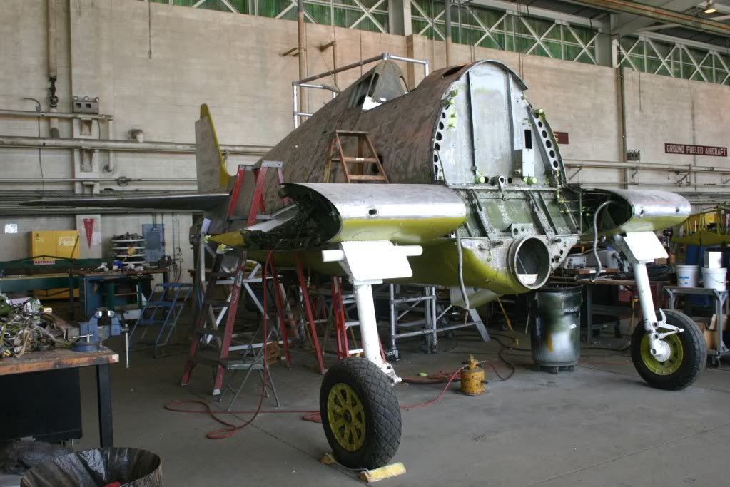

photos taken 5-26-2011

What is it they are doing on the right side of the fuselage? Sanding corrosion off?

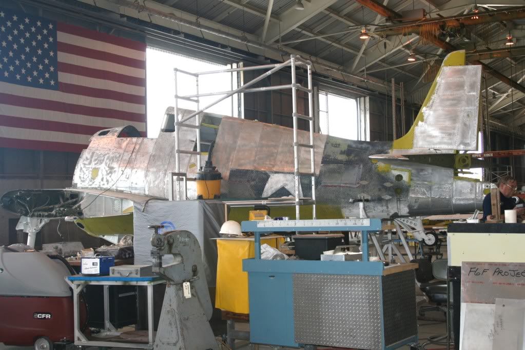

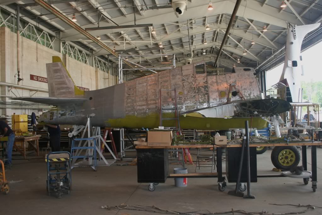

I'm the crew leader for the restoration project. to answer a few questions. The fuselage was extensively corroded. Not only did we have to nearly sand the complete fuselage, but several skin panels underneath had to be replace. On the port side, crash damage aft of the cockpit necessitated replacement of a considerable amount of skin, as well as the underlying framework. We're currently in work on the wings. The port wing is only missing the last six feet or so of the outer section, so we're tackling it first. Most of the existing skins are corroded to the point that replacement is called for. The underlying structure is being repaired as we expose it. Once the intermediate sections are repaired we'll tackle the creation of the outer part of the wing.

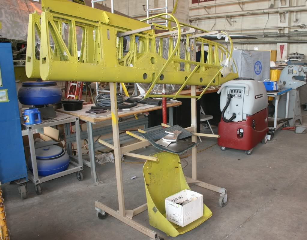

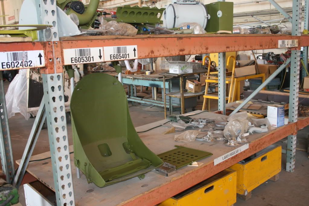

We've finished building a new canopy, vertical fin, rudder and elevator from scratch--none of these were recovered with the aircraft. We've also built a new seat and most of the cockpit fixtrues are ready for reinstallation, once the interior is painted. The engine is about 95% complete and will be installed after we get a bit more weight on the plane, to move the cg a bit further aft. With the fuel bladders and all the avionics removed, and the flight controls not installed yet (a few more coats of dope) the aft end is pretty light, and that R2800 QEC weighs in at about a ton.
The flight controls pictured, btw, are SBD elevators, off the project next to us, as is the seat below it
