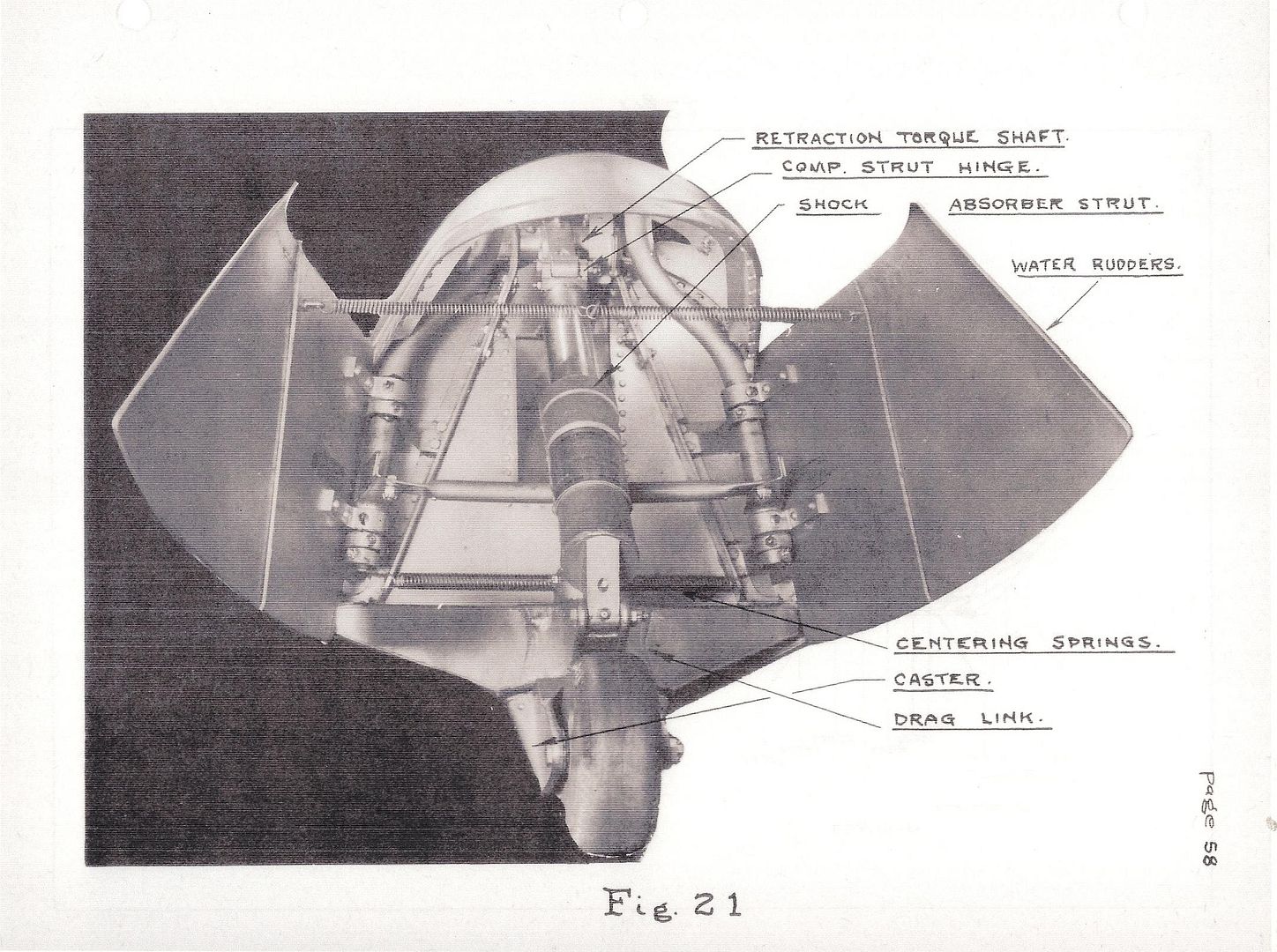

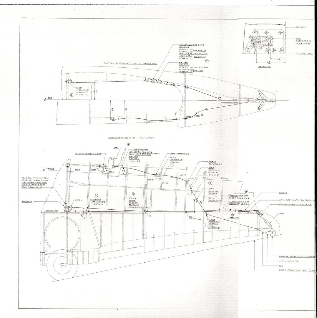

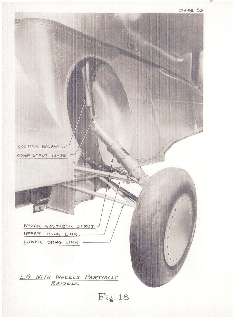

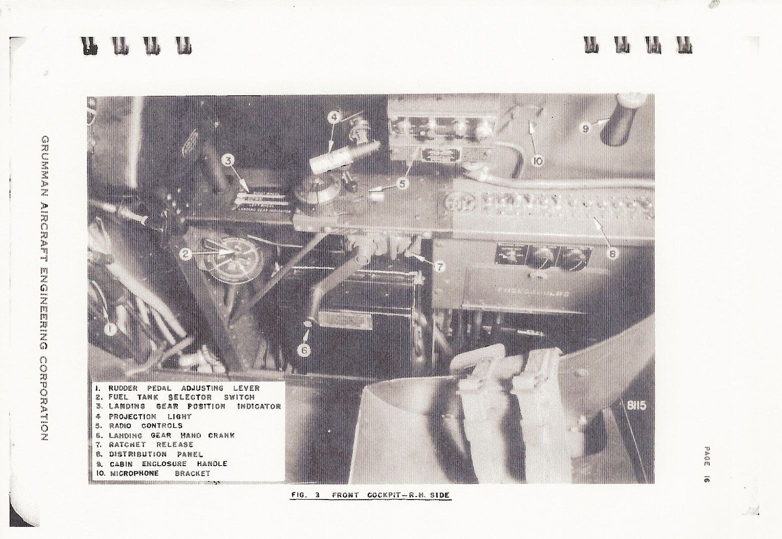

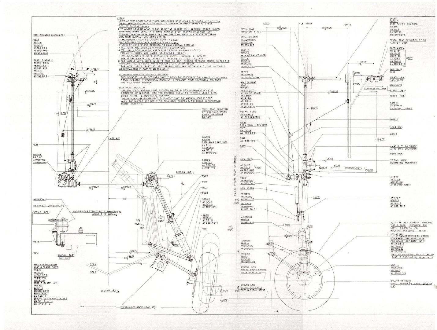

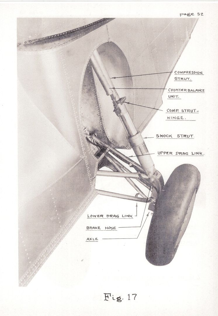

Here are some pages from a J2F-4 maintenance manual and one cockpit picture from a J2F-5 flight manual concerning the landing gear operation.It appears to say that the gear could be retracted on the ground if the ratchet release lever (item 7 in the cockpit picture) is unlocked.However,supporting the weight of the airplane on partially retracted gear is liable to shear one or more of the three bolts that connect each main gear upper oleo strut to the retracting mechanism.I'm not at all sure that this is the case,though because under "Wheel Lock" on the 3rd page of the text,it's stated that the spring counterbalance will prevent all possibility of the wheels retracting during take-off and landing.Whether that means that the rachet release will trump the counterbalance like a gear retraction over-ride in a DC-7 or not is unclear.I'll have to ask Brent Conner who flies Erickson's Duck the next time that I see him.Maybe,one of our experts can tell from the info below.

It's a similar deal as with the Goose except that the shear bolts are Grumman p/n 12646. According to their drawing, they aren't all that "special" as Grumman seems to have claimed for the ones in the Duck - the 12646 bolts are just cut down standard AN5-12 bolts (with a 1/2 inch head) that have new 1/4-28 NF threads cut (and that are subsequently re-heat treated to 125,000 psi.)
The shear bolts are there to prevent damage to the rest of the retraction system should a pilot inadvertently attempt to extend the gear in water that is too shallow. If the gear hits the bottom before it is fully extended, the bolts are supposed to shear instead of trying to pick up the whole airplane out of the water. The system is not strong enough to do that and might be damaged.
