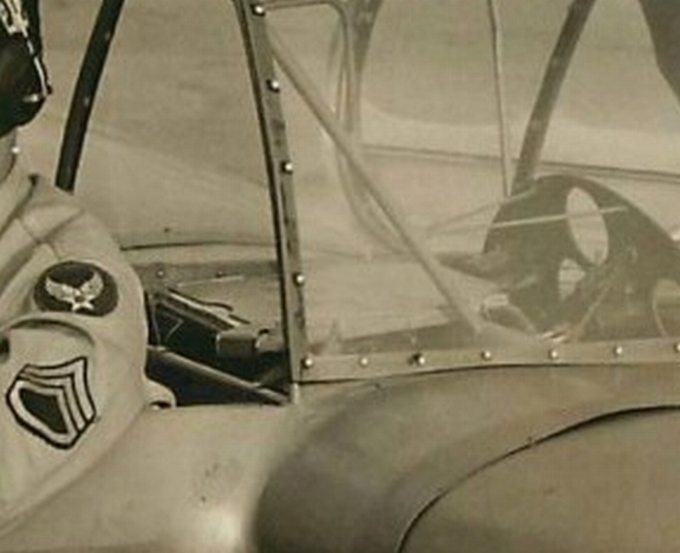

Could someone please post measurements of a wooden data case?
I need to build one, although looking at the attached photo of what I really need;
I'm starting to think it may actually be a commercial clipboard holder.
Any thoughts?

Shrike,
That is not what is considered a "Data Case" that is a Type A-2 "Flight Report Holder". They are typically left bare wood and have "Airplane Flight Reports" painted on them (solid lettering, never seen a stenciled one). I have seen them also have a rubber stamped "Type A-2" in roughly 3/8" lettering. There is a metal flip or strap on the top left corner to hold the Form 1A in place during flight. I have a reproduction in my L-5 which can be seen in this photo from 2009:
I have an original, which looks nearly identical with the only difference being the rubber stamped "Type A-2" and a slightly darker wood color (likely due to its age). I can make measurements for you if you need it... Hope this helps...
Taylor Stevenson
