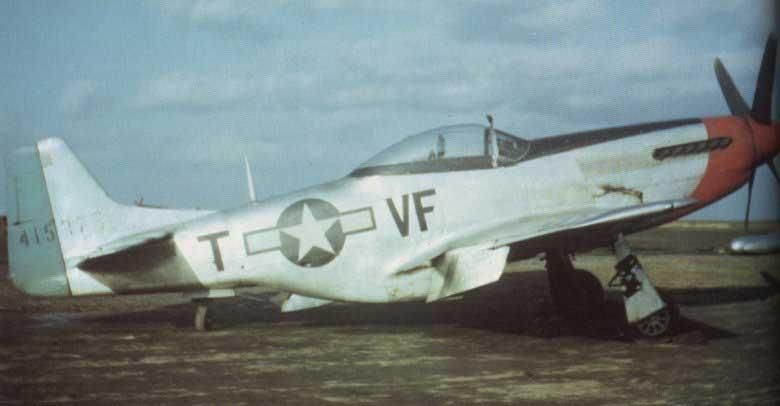

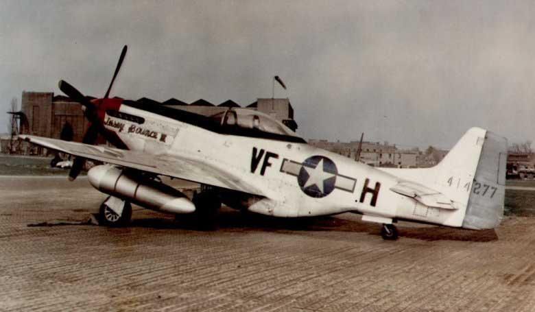

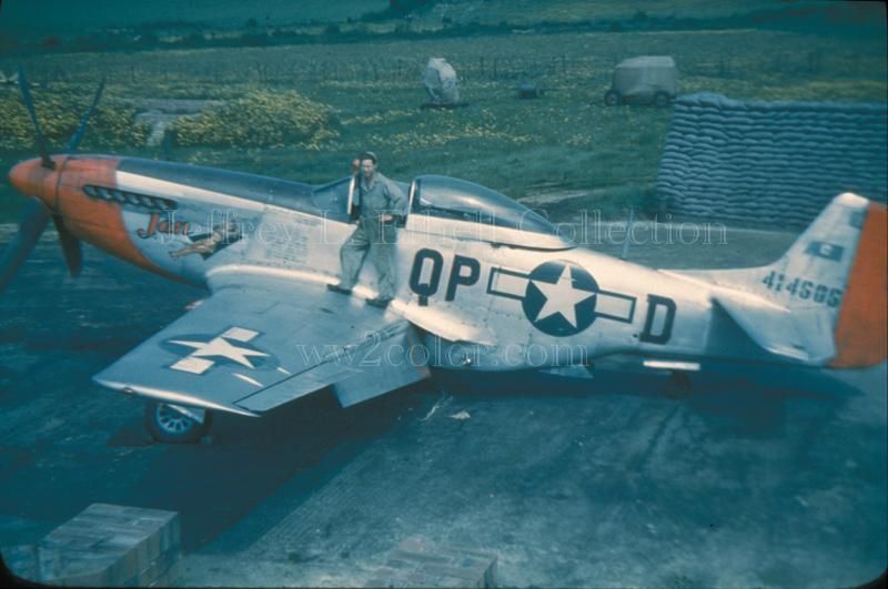

Here ya go guys! :)
I LOVE the 4th FG... :D lol
Regards,
Laggin' Dragon

PostPosted: Fri Aug 03, 2012 6:14 pm
Posts: 3160
Laggin' Dragon wrote:
Here ya go guys! :)
Regards,
Laggin' Dragon
With the quality of the photos most are hard to say.
Can't really tell on my screen. Compare back of blade to glare panel as the blades are black.
There looks to be a difference between the cover over the instrument panel and the gunsight, (both known to be black) inside the windshield and the antiglare panel.
I'd guess OD on my monitor.
The red on the nose looks dark and off color so it would be hard to guess what any of the colors are in this photo.
Looks OD to me. The QP and D look to be darker and more black than the anti glare.
OD could be pretty dark against the brightness of the alum skin. Dunno how well films of the era would deal with the contrast and color representation.
Need some special software and a known reference on each photo to get into the id of colors. I'm trying to figure some of this out to look at shades on B&W photos in the SNJ-3 book to figure out cockpit colors.
Rich Palmer
Remember an Injured Youth
benstear.org
Don't Be A Dilbert!
PostPosted: Fri Aug 03, 2012 6:36 pm
Here ya go guys! :)
Regards,
Laggin' Dragon
Open the hood on any car and see how many shades of flat black you see (and Mike Joy and Steve Magnanti are great at pointing this out @ B-J auctions...) the DIFFERENT, correct shades of FLAT black on the inner fenders, the firewall, the radiator brace........
