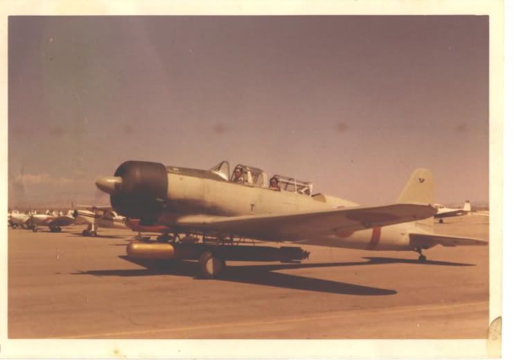

Joined: Sun Jul 08, 2007 10:11 am
Posts: 103
famvburg wrote:
Could it be related to the Tora Kate conversion?
That was completely different, starting with the substitution of a BT-13 aft fuselage. The second cockpit had controls. This picture was taken in August/September 1971 at William Fox Field in Lancaster, California. Bill Barnes is in the front seat, I'm in the second, and my fiance, Marylee Stephens, is in the third.
