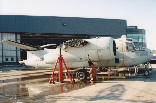

Tracker 1577 at CFB Downsview, Sept. 12, 1959 (Photo: Jack McNulty Collection).

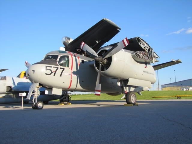

Tracker 1577, temporarily registered C-FUDH, arrived at CWH late in 1997.
Static restoration began right away.
Static restoration complete.

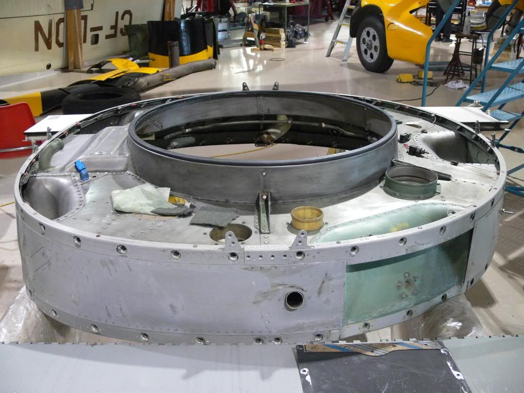

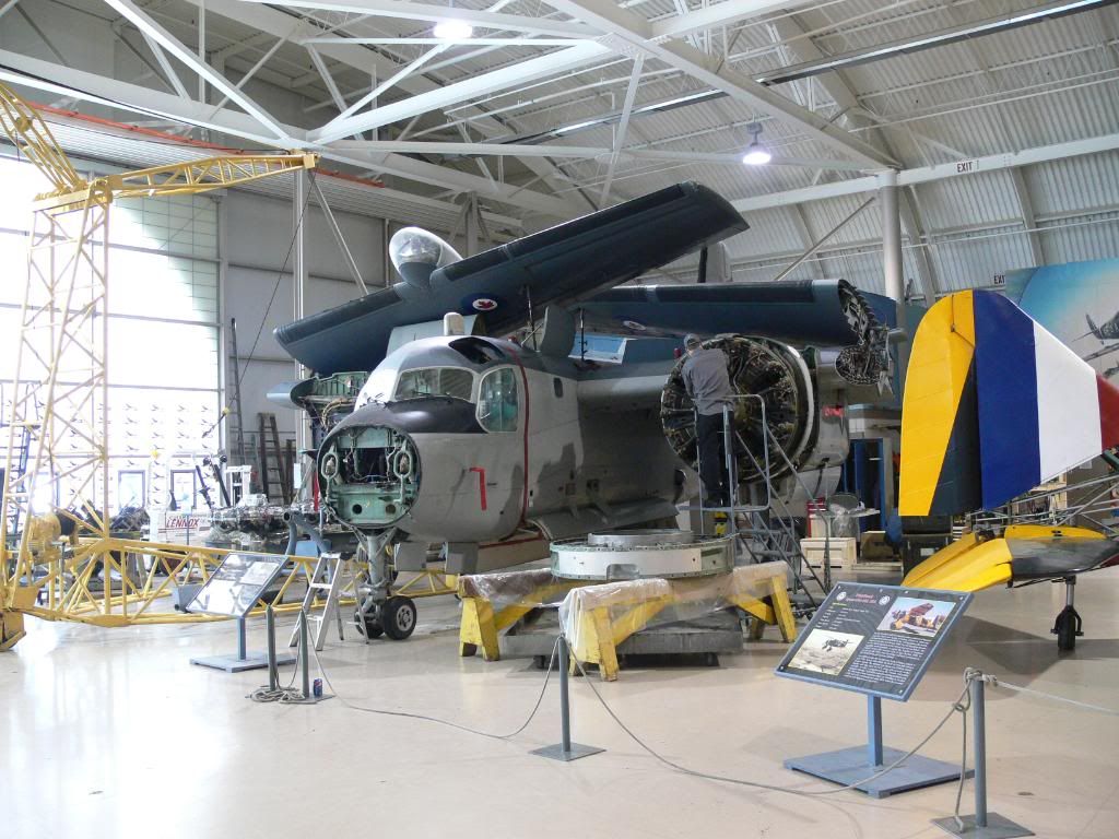

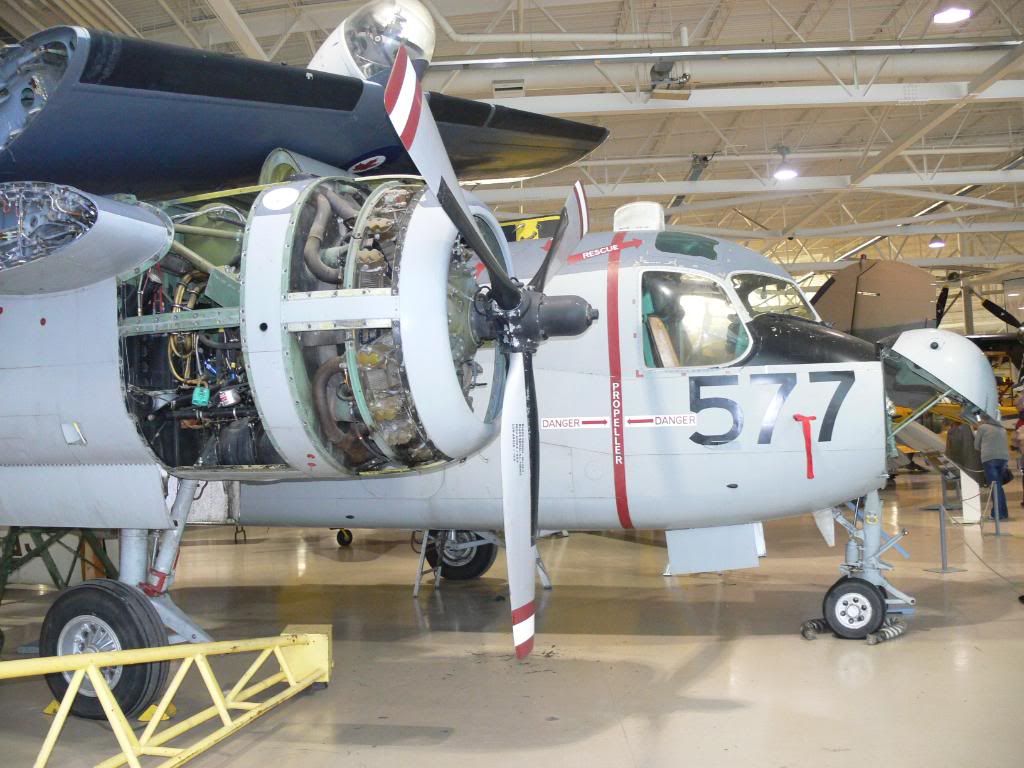

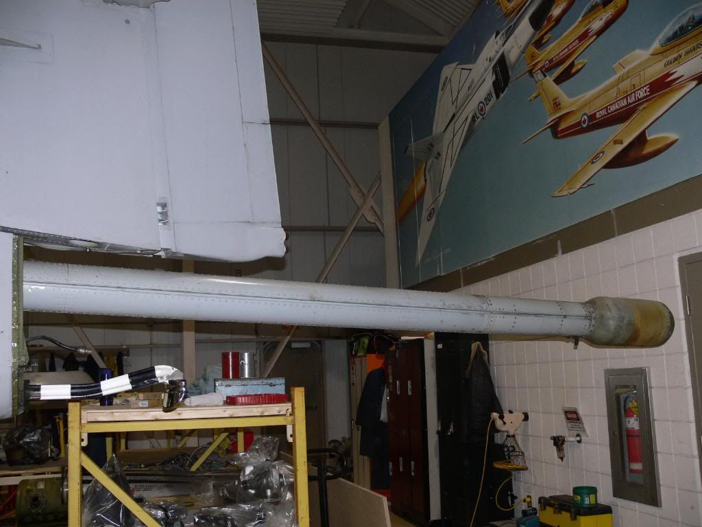

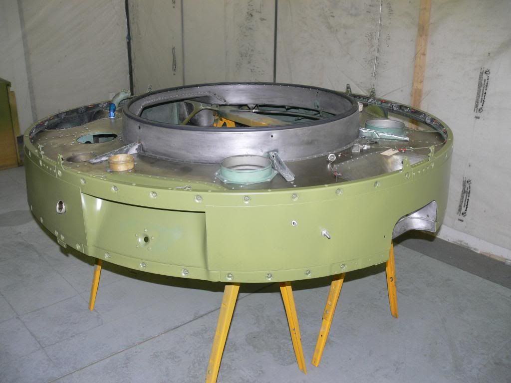

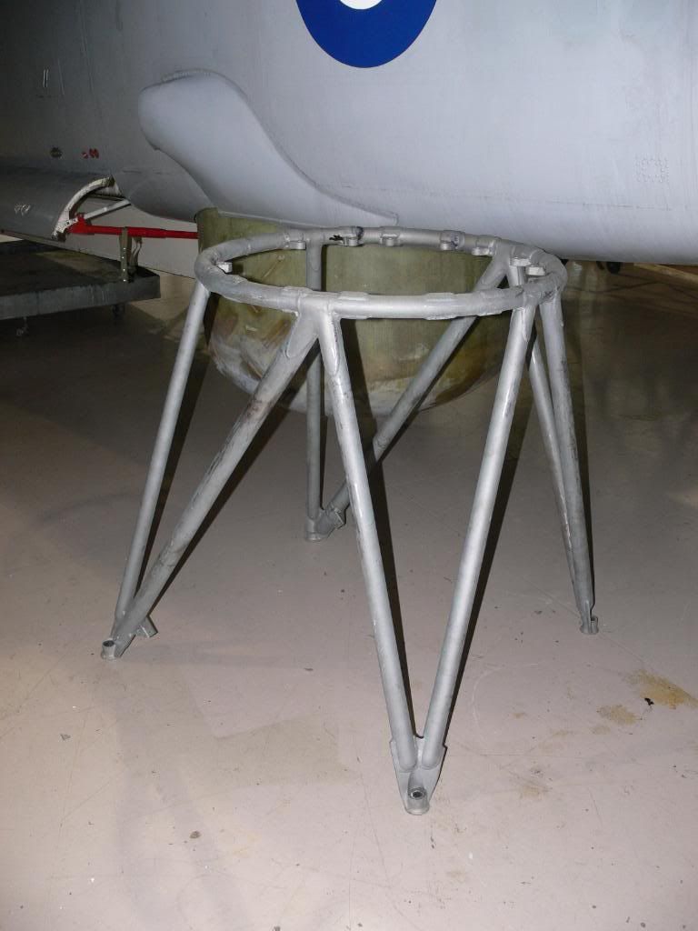

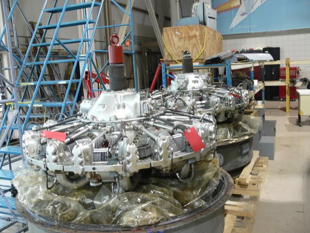

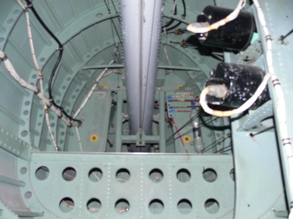

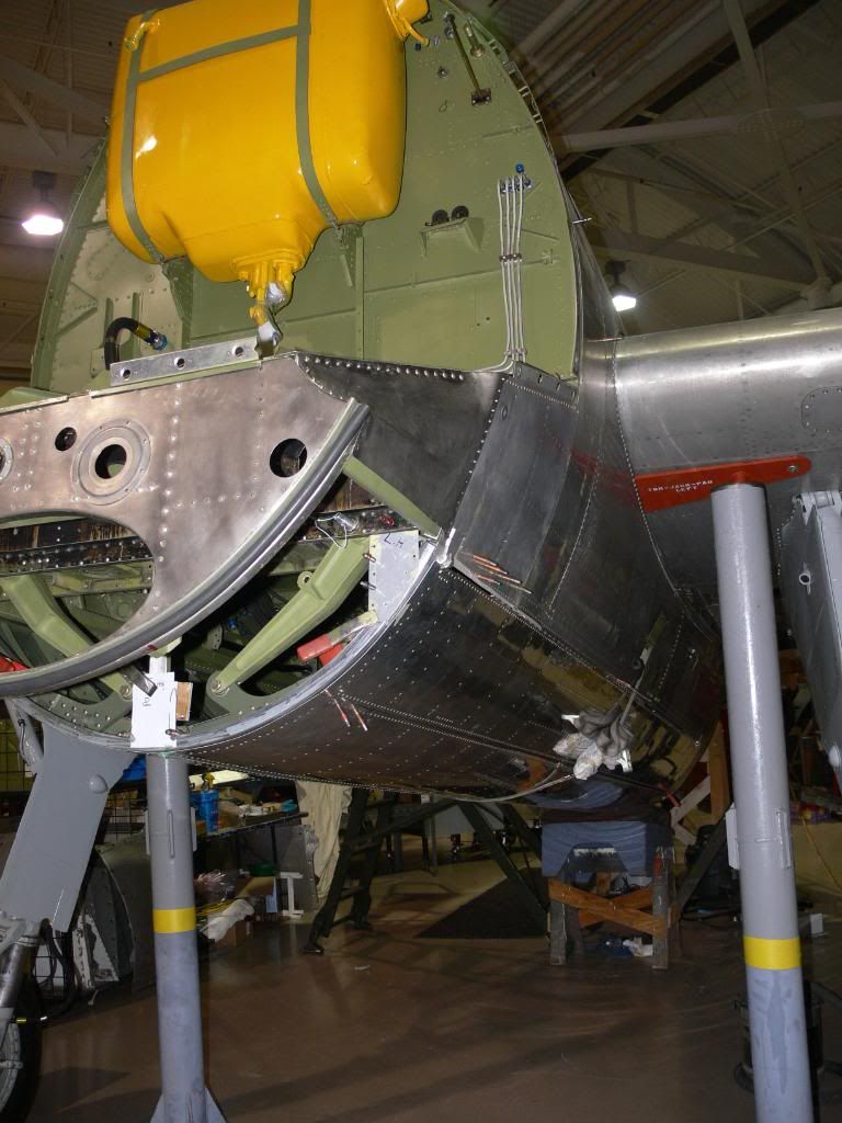

The Tracker restoration is well under way.

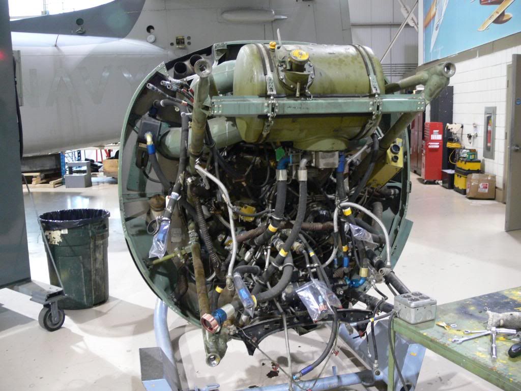

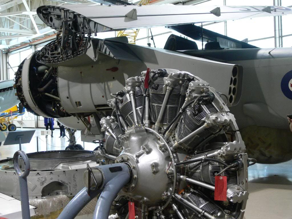

We have attacked the R/H engine first and plan on a zonal restoration. We will concentrate on this nacelle until the overhauled engine is back on.

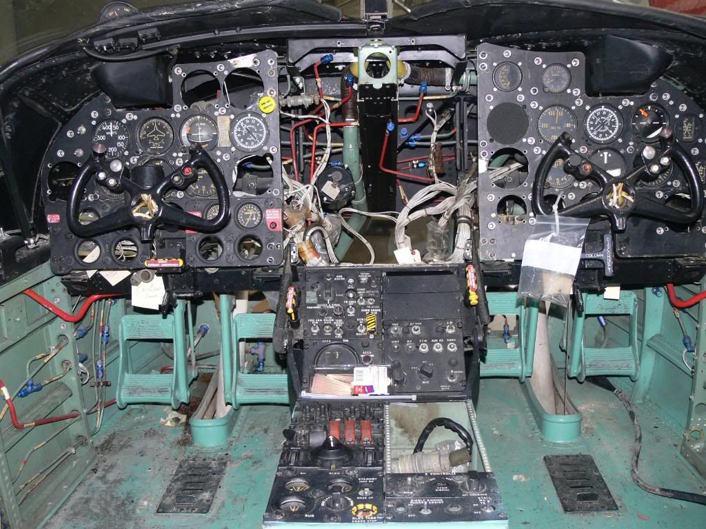

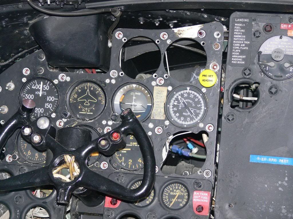

We have pulled all engine instruments for overhaul, all engine hoses have been sent out to make new ones, engine mount has undergone NDT inspection and requires painting, firewall ring has been cleaned, stripped, and primed.
All engine accessories are out for overhaul. Once we get all the pieces together we will put the engine back together with the mounts and hang it once again.

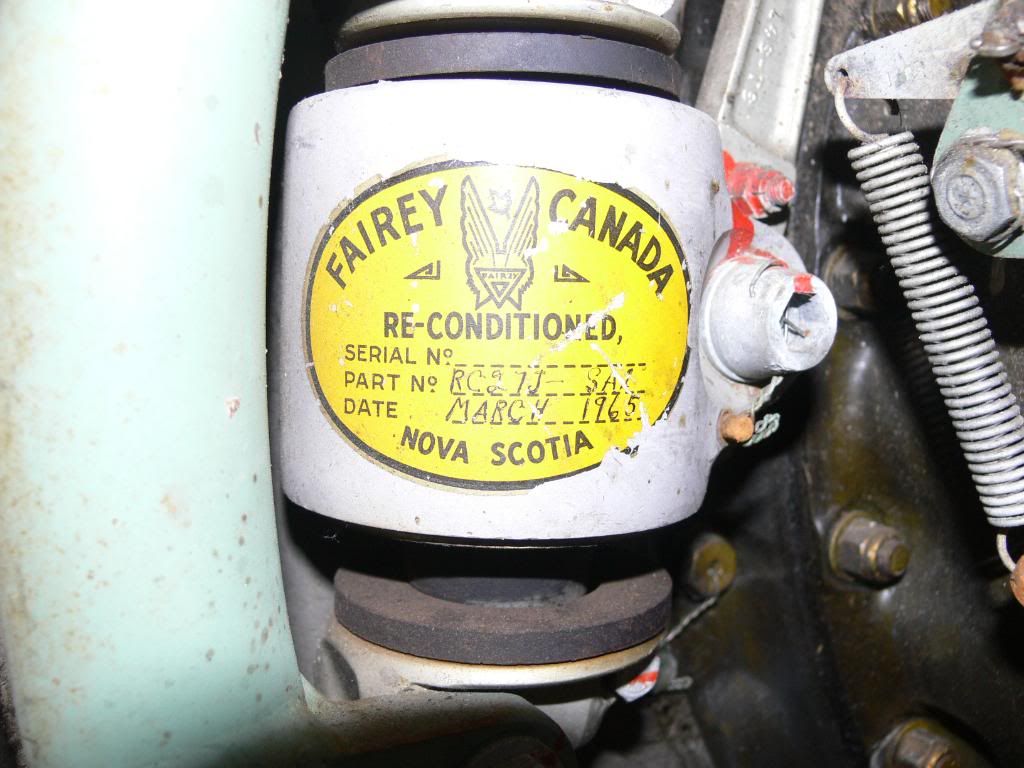

Mount isolators are a being a little harder to find..does anyone know of anyone overhauling these units? We have one company that has the know how to do it, but have not heard back from at this time.
The airframe is undergoing a complete paint stripping to be ultimately repainted in a 2 part polyurethane in it's original 1959 HMCS Bonaventure scheme. Will keep updates coming with photos.
and one Avenger photo for good measure...nice new torpedo bay doors!

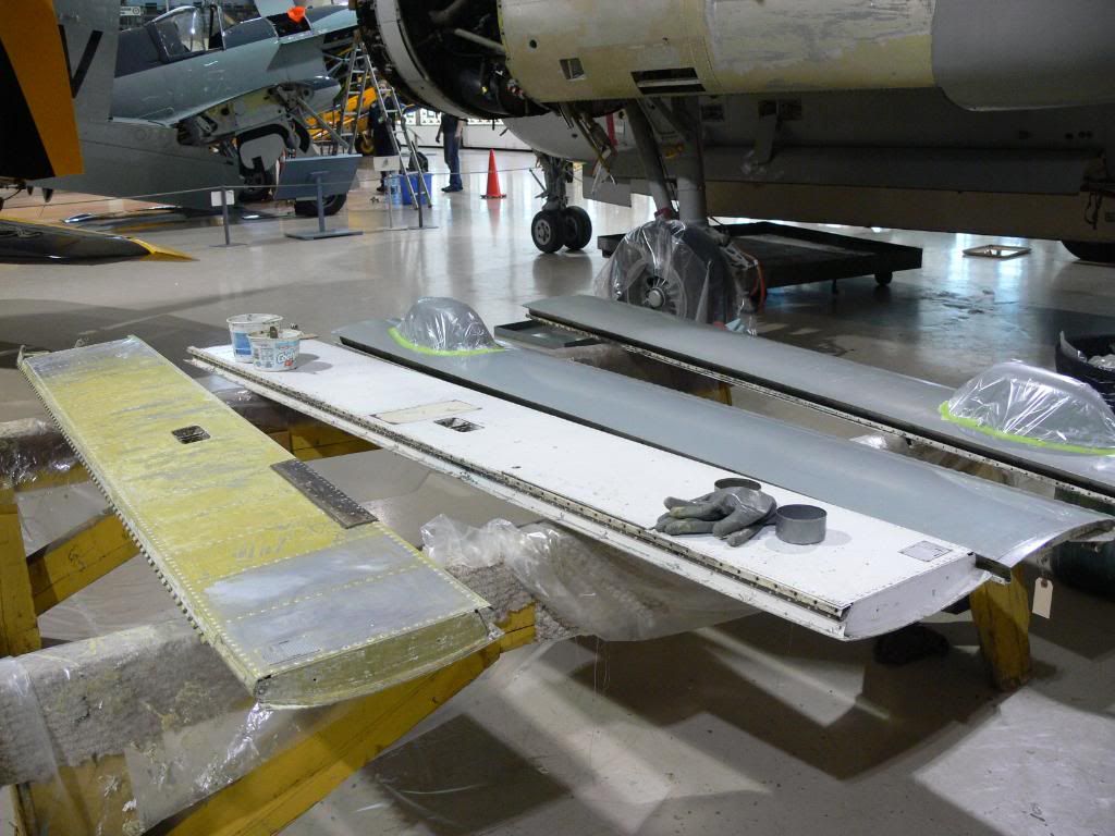

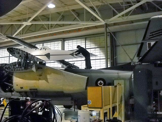

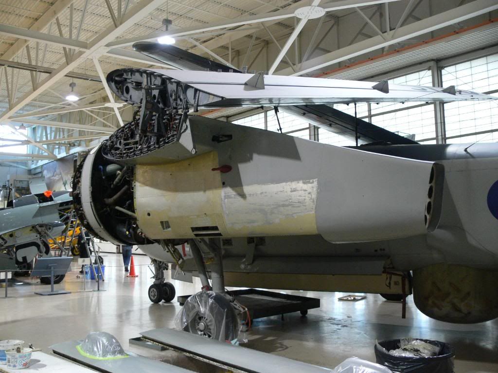

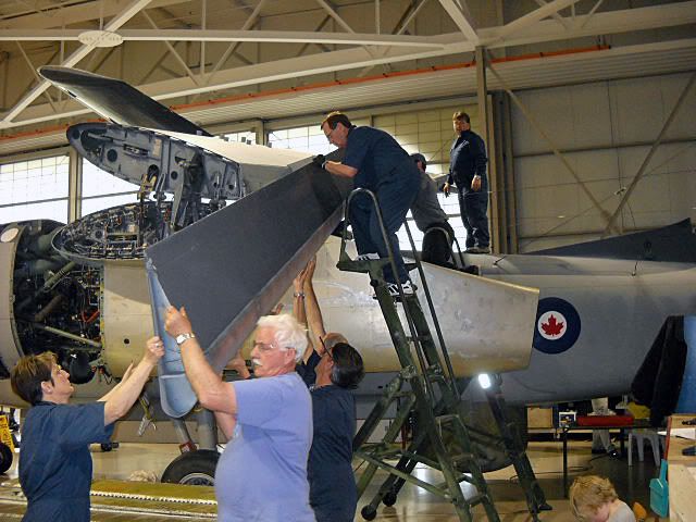

The Tracker continues to make progress, and our big job currently is stripping the cosmetic paint job that the Tracker had applied years back to check for any corrosion or hidden metal damage that needs addressed before the aircraft is painted down the road.
A hold up currently is the engine mount isolators have to be rebuilt as the rubber mounts were last overhauled in 1964, so they require overhaul again. Once they are done we can mate the overhauled engine back to the mount and firewall ring and get it ready to be hung back on. The first of the new airframe and engine hoses have arrived back and we are awaiting some of the accessories for the first engine.
We recently pulled the flaps off for stripping, cleaning, inspection and then re-paint. (see photos)
The wings too will come off once space and better weather become available to facilitate the crane around.
A news article that was posted recently...http://www.thespec.com/news/local/artic ... -fly-again
More updates to come....
