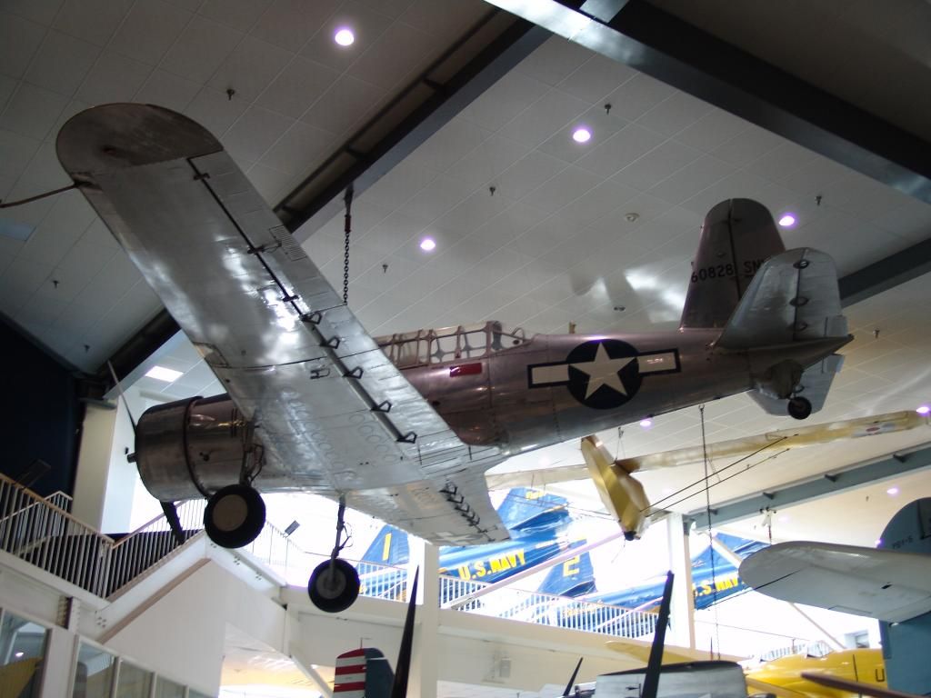

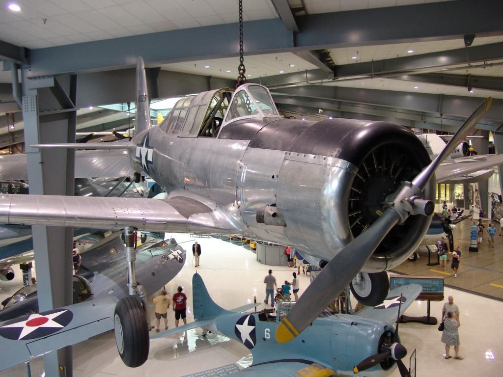

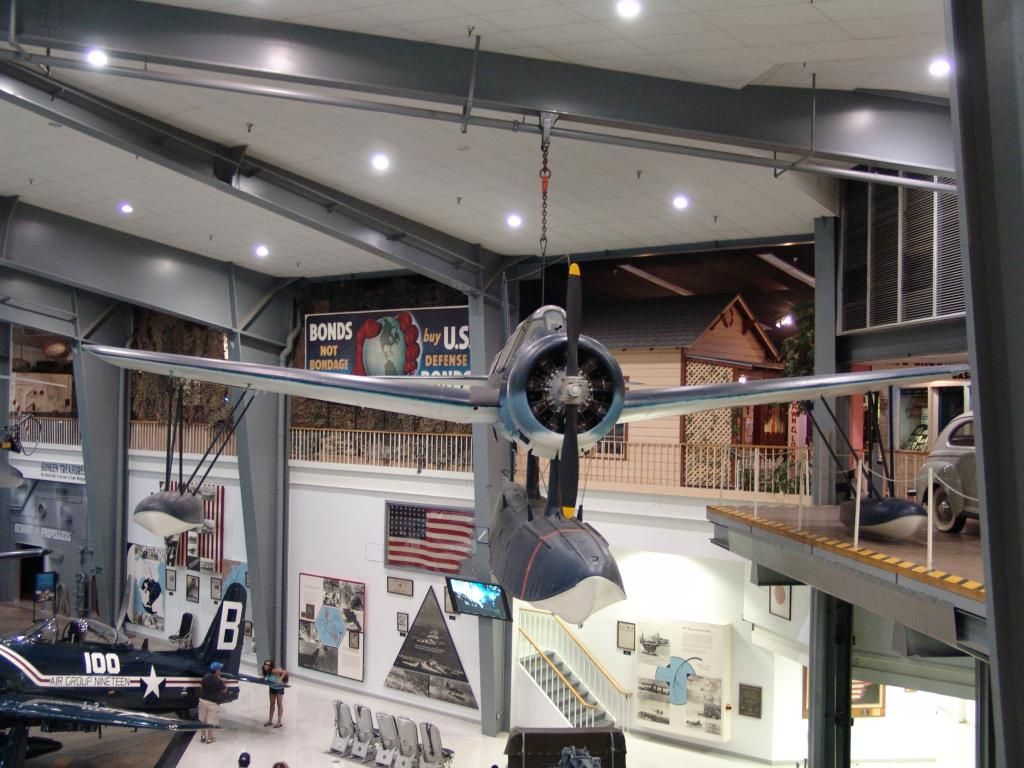

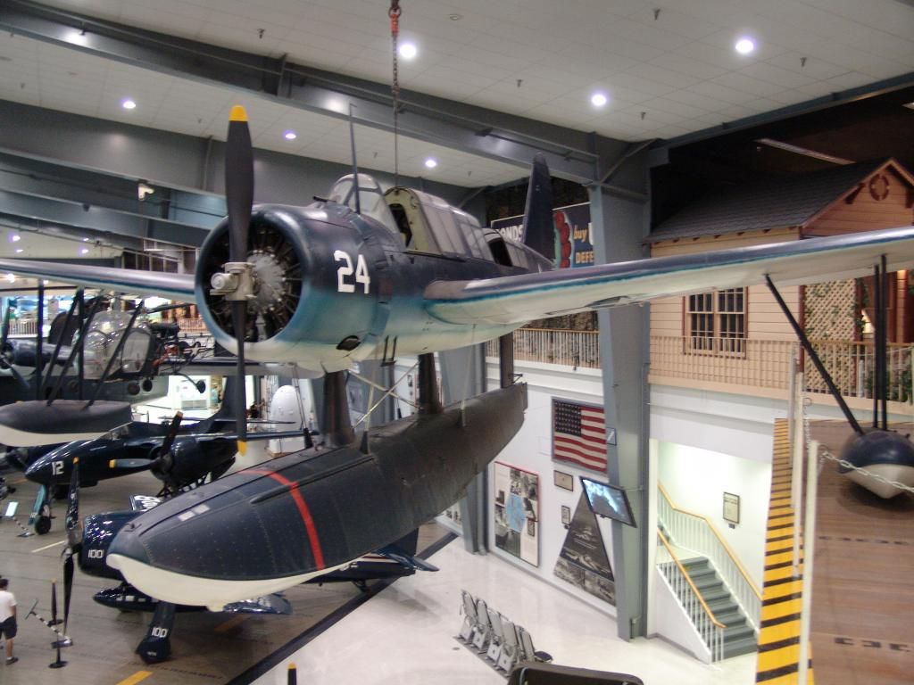

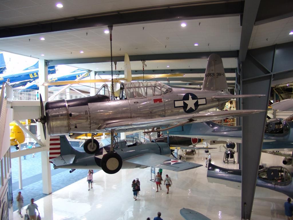

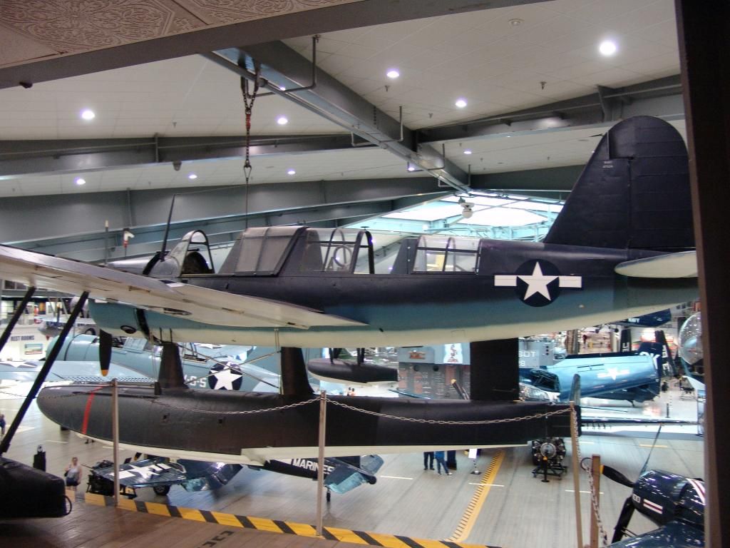

I tried this once, and after linking my 306th photo my computer decided to reset...as I said previously...I would go to Pensacola for inspiration. Try to get a used main float somewhere that would be "close enough" and work from there. I've included a few pics for comparison.

Could they make a fiberglass replica instead of making one out of a BT-13?

Getting the ship into dry dock is the top priority right now, but they want to further the restoration once it is dry docked. This idea is something that they were just kicking around and asked me to come up with ideas to build it. I'm not opposed to fiberglass especially since it doesn't corrode, but I sure hate working with that itchy stuff. I think CHUNKS idea of going to Florida is a necessity for measurements and ideas.
