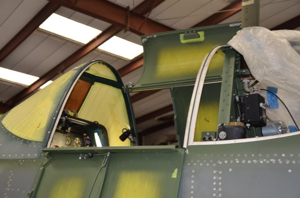

While I don't know how "radar" fits into the mix, I do know of an indicator that was positioned right behind the pilot's left shoulder, that being the BC-767 Indicator Lamp Box (as the NAA drawings refer to it). It was mounted in this position on all P-51A/A-36/P-51B/C related production. However, the most I know about it is that I believe it simply provided a visual warning for the radio/IFF detonation, which was activated by pressing the two detonation buttons available on the right-hand side of the cockpit.
Here's a photo from the American Aero Services Facebook page, showing the BC-767 Indicator mounted on the Collings Foundation A-36 (it being the box with the two red lights). It is mounted next to what the drawings refer to as the "BC-706 Destroyer Swt."
