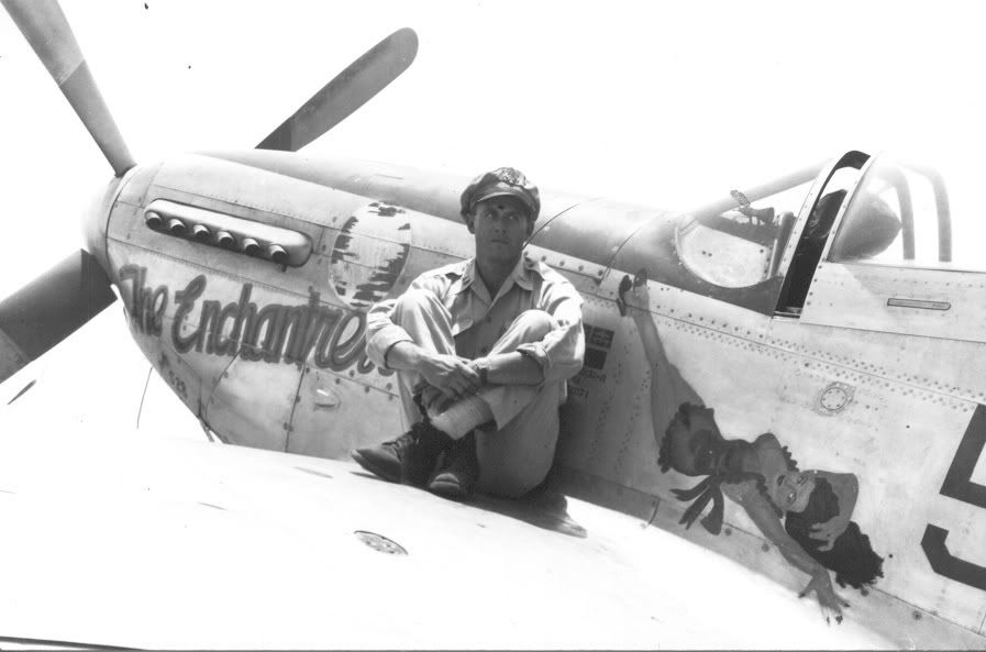

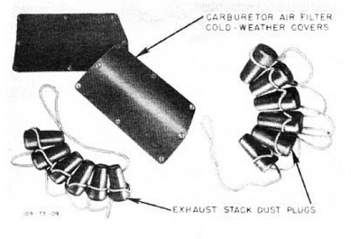

In the P-51D/K "Erection & Maintenance" manual, the non-perforated side-cover panels for the carb air filter, are called "cold weather covers", and shown to have been supplied with and stowed within the aircraft from the factory, along with other miscellaneous equipment and hardware. Although some might see them present on a restored Mustang and think they are not-authentic, the more one looks at period photos of Mustangs during the war, one can actually find quite a lot of Mustangs with the non-perforated panels fitted, at one time or another - one of the most often-seen examples being that of Preddy's "Cripes A' Mighty 3rd", and a large amount of photos of 78th FG Mustangs show non-perforated panels fitted. In a photo of the Iwo Jima based P-51D "The Enchantress", you can also see that it has the non-perforated cover panels installed as well - which may have been due to the effects of the volcanic dust/sand on the island.

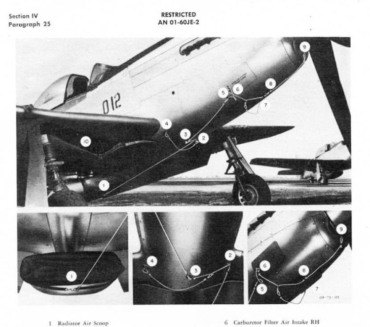

I'm sorry I threw that comment in there - I had my mind on two different things. I believe the plate seen in the well-known photo of "The Enchantress", is one of the ground-installed plugs for keeping the dust/dirt/sand/ash or other debris from being blown into the filter from the sides.
There is a great photo of 352nd FG Mustangs taxiing during the Russia "Shuttle Mission", kicking up clouds of dust and dirt into one another, with a caption that reads something along the lines of "filtered air was required".
In some photos, the "cold air covers" can be seen to still have the original Alclad production watermarks spread across them, either a sign of 'how fresh' they were when they left the factory/supplied with the aircraft, or possibly machined at the base of opperations.
