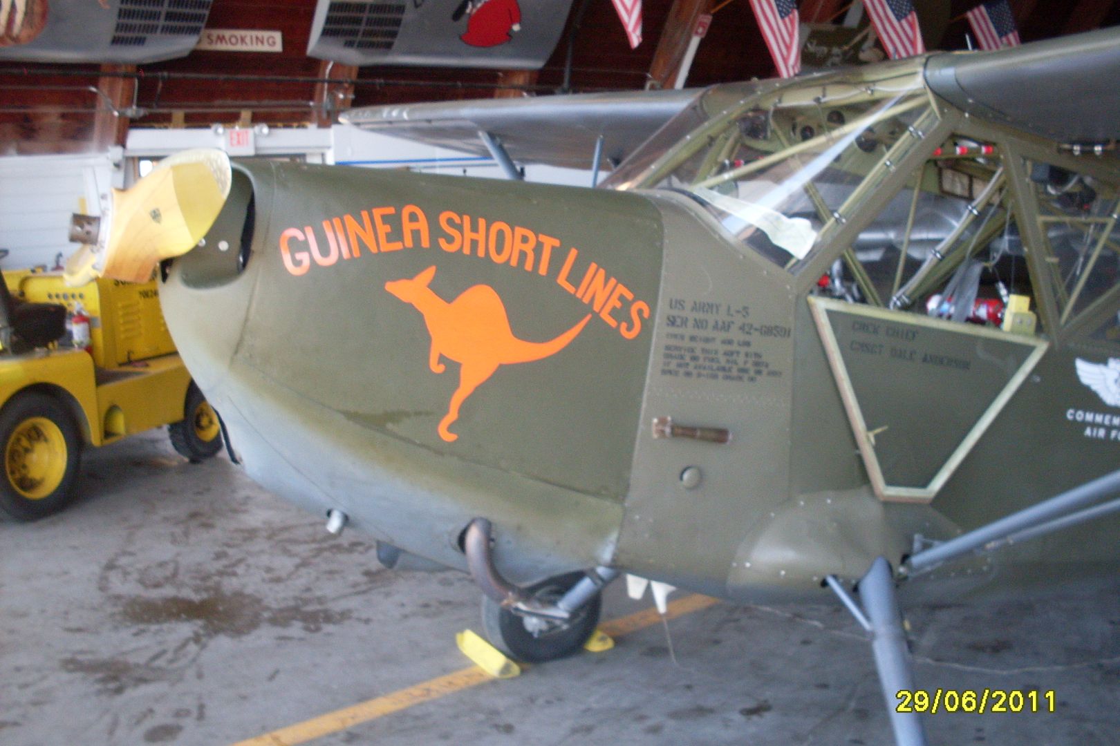

L-5 port...
...and starboard

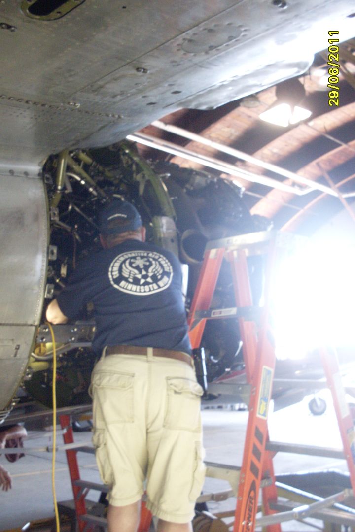

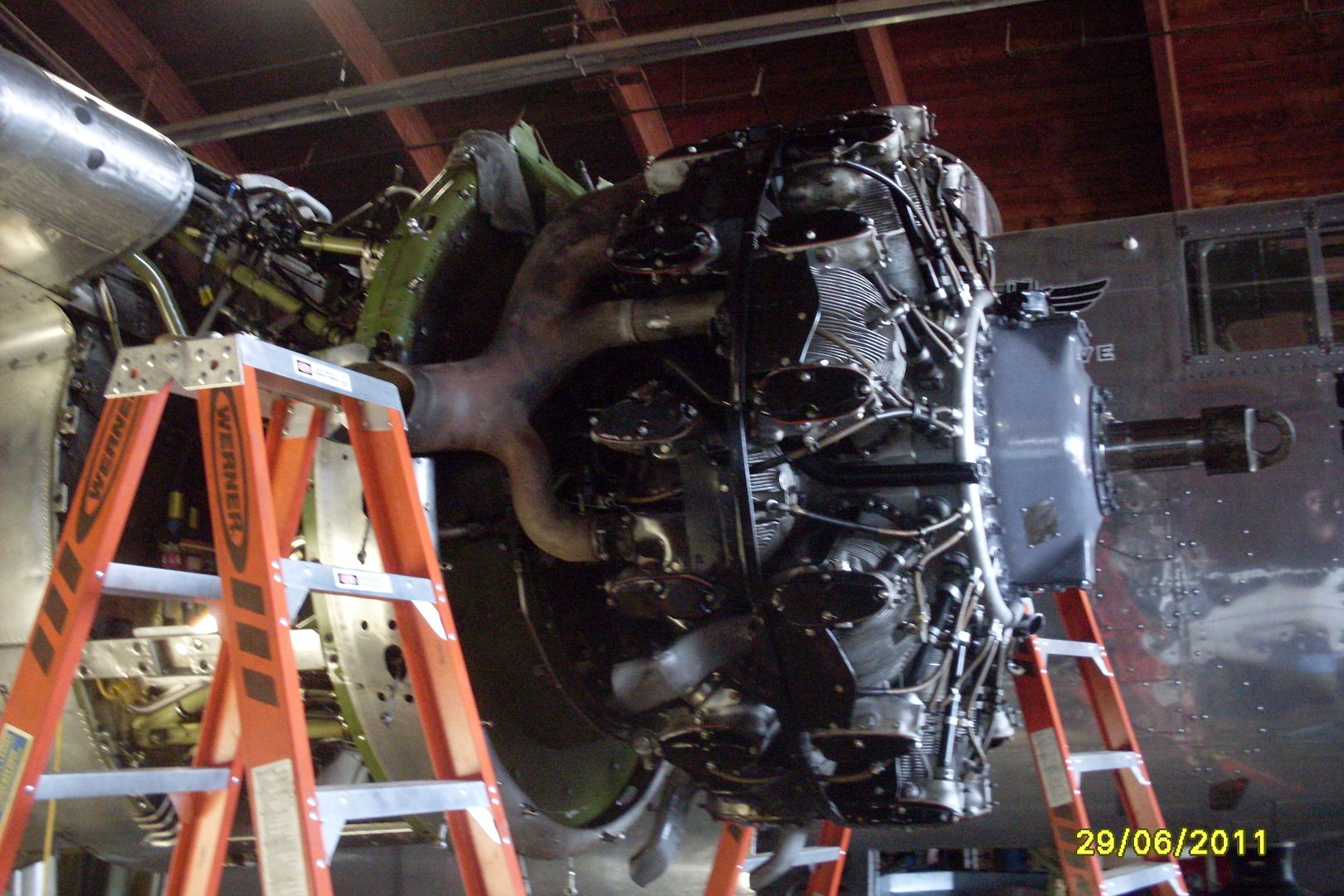

Miss Mitchell...starboard motor...blown gasket...blown oil...shiny sparklies in oil screen... :(
She's in good hands though; several wrenches on hand getting her all better again.

I have about 100+ hours in that BT-13 back in the mid 80s, and a few in the L-5. Great bunch of people.

Thanks for stopping by the hangar. A couple minor corrections to your captions. The Mustang actually spent the winter here in the frozen north and has not been to Texas since Airshow in October last year. The spinner is off for a routine inspection. The cowls are off to facilitate chasing leaks which as time is logged on the engine, becomes an ever more time consuming task! Rich nailed the answer regarding the SST rub strips on the clam doors….Vlado will be happy to see the inner door pans are silver, not green! DOH!
Poor Miss Mitchell and especially her crew. In early May one of her engines spit a gasket on the blower and started spewing and consuming oil. The engine was removed and sent to Ray Anderson for repair only since it is a very low time engine and running perfectly otherwise. The Mitchell crew had a fresh engine on hand and made the decision to hang that one rather than wait on the necessary repairs to the other. Well, the fresh overhaul they hung lasted about 10 hours before it started tossing silver off the main bearing. Note to self…always select a reputable engine builder. To his credit, Ray turned the repair engine in record time, gave it a good fish-eye, blessed it and sent it back. Even though none of these engines originated from Andersons shop, he treated us like we’ve been long time customers and really went to the plate for us. Ray Anderson is the best! Anyway, the engine you see being hung is the repaired engine going back on. The guys on the Mitchell crew deserve a hat’s off and a big bow for doing TWO engine changes in the last two months. I hate to even think about having to do something like that on the Mustang. To Larry Utter and crew…you guys are the best Mitchell experts going, bar none!
